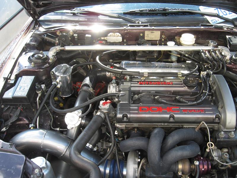

Here's the looong coupler I used for the lower IC pipe. It may not be the most efficient design in the world, but it made fitment so much easier which is why I like it.
Also just powder coated this valve cover the TKR Mark gave me. It will be going on my car. I was going for a somewhat OEM look, but with a little twist. So instead of the stock silver/grey and red, I did it in Gunmetal and red. I think it'll go well because all of my piping is gunmetal as well.
Mark if you're reading this, my plan is to coat your 2 valve covers tomorrow. I'll let you know how it goes.

Got the IC pipe coated as well. Also got the TB back from Kevbo, thanks again man!
Everything is back together. Now to just get it running right!
The new VC looks pretty good I think!

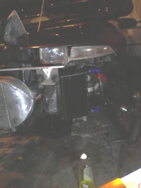

As many know, some bad crap happened and it's getting a little bit of an overhaul right now.
Just thought I'd add some updates...
Pistons/Rods are all installed. I ended up getting a 2G head from Andrew for cheap. Jet has it now and is doing a little bit of port work so it'll mate to my 1G SMIM.
I got my new oil cooler setup on today. I picked up an external oil cooler, and picked up some AN/Push-lock fittings and hose. In the end it cost around $100 for the entire setup. Pretty happy with how it turned out, and the mounted location should work out nicely. She feels pretty sturdy
Here's some crappy cell phone pics!

Re: My Winter Upgrades
Nice, keep up the progress so we can all rock the spring opener.
Also I hope that you put the bumper on to see the clearance.
Of course I did. The bumper is already back on. Worked out great.
Old 11-16-2008   #274
Very nice, that's where I have mine as well.

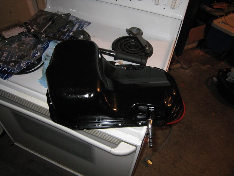

Updates:
MAP welded a -10AN bung onto my oil pan for me. The goal there was so I never have to buy another gasket/crush washers for there again, and never deal with leaks there again EVER!

Some quick pictures with a real camera.
One is of the new Oil Cooler with the bumper on.
One is of the Oil Pan with bung welded on, and -10 Push-lock fitting that'll be utilized.
Where did u get that oil pan fitting for the pushlock line?
Also good luck with that oil pan gasket there are a lot of mixed reviews.
Wire brush or emery cloth but use care.
Old 11-27-2008   #278

I would never use an oil pan gasket. Just grey RTV but let us know how well it seals up.
I got the fitting from MAP. It's just a -10AN 45* push-lock fitting.
