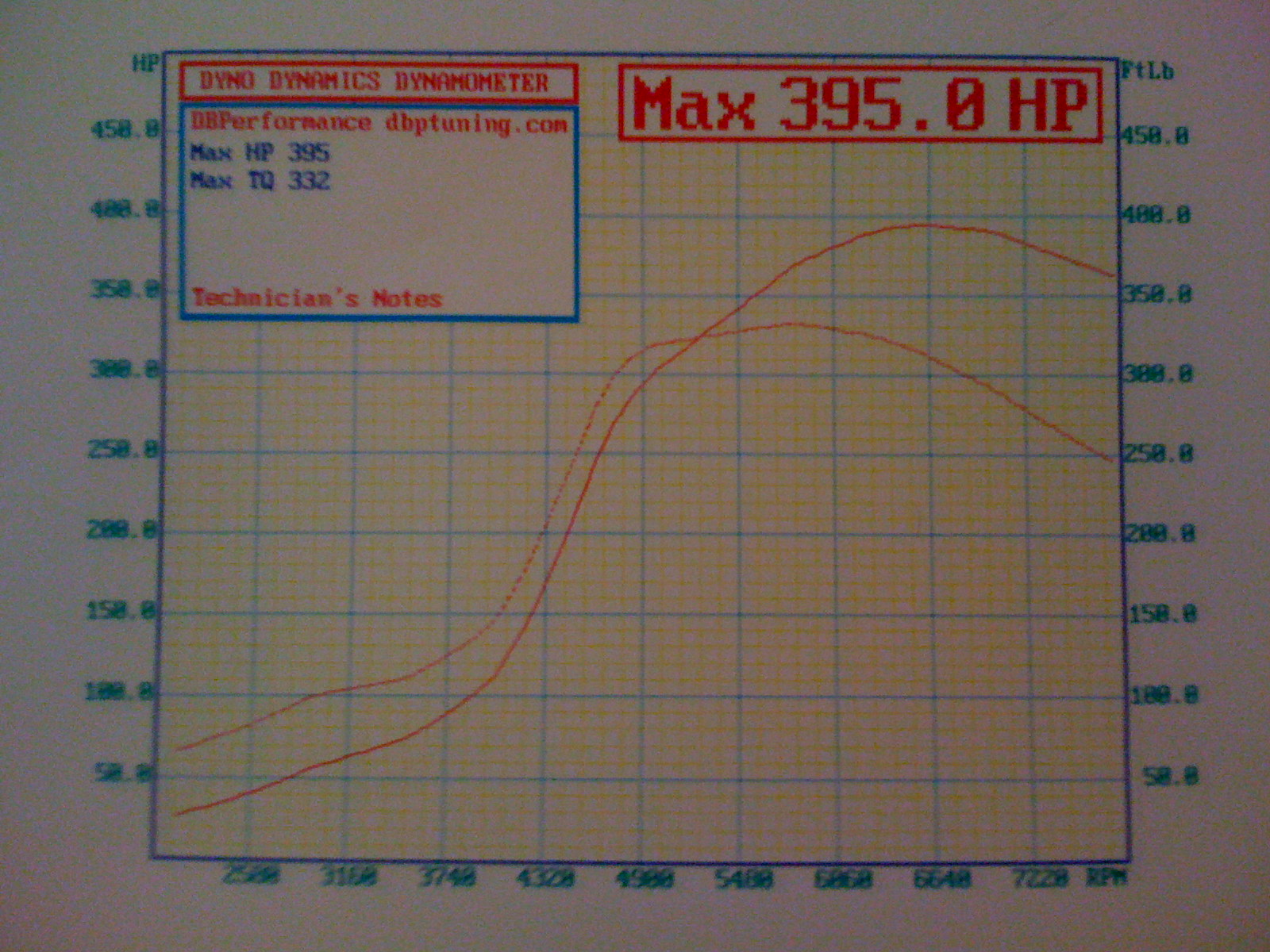

Ah, finally tuned.
Big thanks to Shane (ecoli), especially for dealing with all the issues that came up throughout the day.
Did a third gear pull just before coming into downtown (only place without traffic on drive home), car feels awesome. Feels like my t28 did in 2nd gear, can't wait for an opportunity to do a 2nd through 4th pull.
I've nearly maxed out my boost gauge, 28psi falling to 26 by redline. In third gear it doesn't hit peak boost until after 4k rpms, but in 5th it's a lot sooner.
Old 09-17-2008   #229
Re: Make slowboy not so slow
Dyno graphs or ban!
Old 09-17-2008   #230
LOL @ "Feels like my t28 did in 2nd gear,"
.....it better feel like a lot more than that!
Old 09-17-2008   #231
I meant the rate of acceleration, t28 in 2nd felt like it does now in 3rd, thats a pretty huge change. I guess I can post a graph, just for you Scheides.
Shane had it to something like 405 a few times, but I think he said he backed off the timing a little for a safer tune.
Seems to be a pretty healthy powerband, I'm very pleased with the results, now I have to not touch anything in order to have a direct comparison to DynoJet on the 27th.

Nice numbers!
Old 09-17-2008   #233
Sorry, I'm just excited, I can't even remember how many boost leak tests we've done on that car Awesome. Torque is pretty late for a 2.3 IMHO, but makes damn good power up top! Gonna keep her together now?

Yea I guess I should post major mods now that the car is mainly "complete".
2.3 liter
FP red turbo (60-1 size)
FP4r cams
JMF intake
I'm happy with the numbers, torque is lower than I expected but no big deal. I wonder how close I am to maxing out the turbo, not sure what max boost could be on a stroker.
