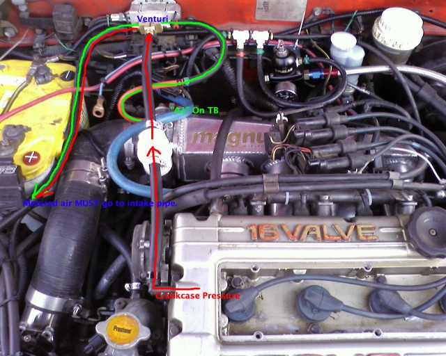

Problem:
Pressure in the crank case builds up while car is at wide open throttle (WOT) causing oil leaks. The stock vacuum system in our cars is designed to deal with this problem, -but- our cars are not stock anymore, they move more air, have more blowby, and have more problems.
Symptoms:
Oil dip stick pops out
Oil leaks from the oil cap
Oil leaks from the valve cover gasket
Oil leaks from the cam angle sensor gasket
(this assumes that you have a working PCV valve and have replaced the above gaskets before you do what I am about to suggest)
Conventional solution:
Use a breather filter, if that doesn't work, weld large AN fittings to allow air to blow itself out at a slower rate, thus decreasing the pressure in the valve cover to about atmosphere pressure (~15psi). I disagree with this solution, because it only allows the crank case to vent to atmosphere, it will never be @ atmosphere, always slightly above atmosphere, with air constantly escaping.
My Solution:
Much cheaper and easier then welding AN fittings to the valve cover, and I insist will work better.
A venturi vacuum pump creates a vacuum in the valve cover while under boost. (see picture).
I have been using this for over a week and it has worked great, my car idles better and no oil leaks anywhere!

What is the white thing on the valve cover line, a catch can?
Raptor was going to use a mechanical pump. Those flow much more than this could. He was also going to tap into the block, since this is where you want the air coming out of, not the valve cover. There are a bunch of cars running a venturi style, but they normally use the exhaust pipe to create the venturi, not a tiny little vacuum line.
The biggest reason that people do the breather filter is because they don't want all that oily mess going back into their engine and IC, which yours still has. You are on the right track though.

the little white thing is a fuel filter, it collects oil like a catch can to keep the intercooler free of oil.
yes, a mechanical pump would probably work out pretty good also, but i would consider that overkill.
the stock PCV valve works great for off-boost conditions, and this is for only when you are boosting.
Its not the size that counts! its how you use it!
I am using this catchcan because you can see through it, if (when) oil starts building up in it, I will know.
A more permanent solution is going to be putting a larger catch can there. This will require moving the location of the catch can, but it will be in the same location in relation to the routing of the vacuum line
