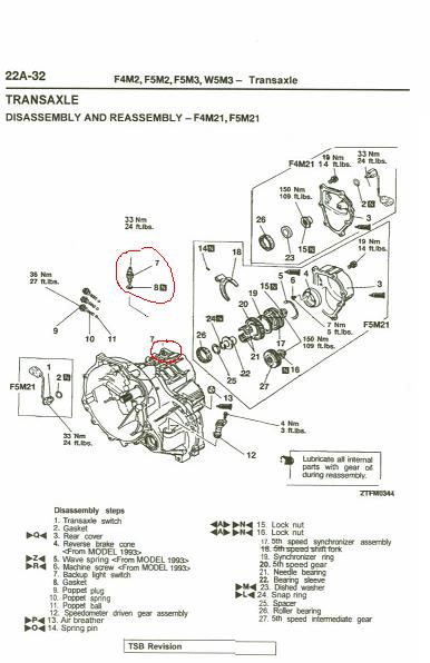

That is your Vehicle speed sensor. It is a M8x1.25 bolt that holds it in, about 40mm long. A 10mm socket fits on the head of the bolt.
Your reverse lights/sensor should be up near where the factory clutch line mounts if I remember correctly (maybe I am thinking 1g trans, little help guys?).
It is a 3 "prong" connection.

this might help you out...

Hey thanks a bunch! That really helped out....I didn't know there was a bolt next to it--guess I shoulda looked while it was out of the car...
