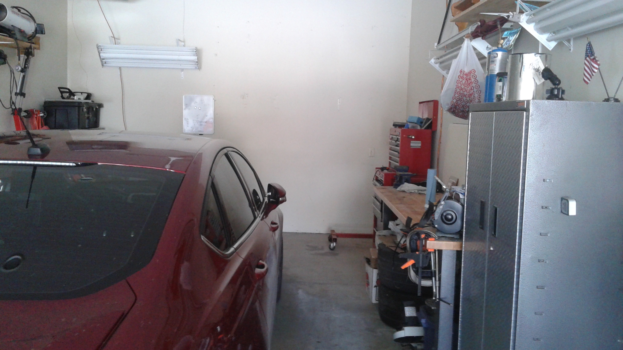

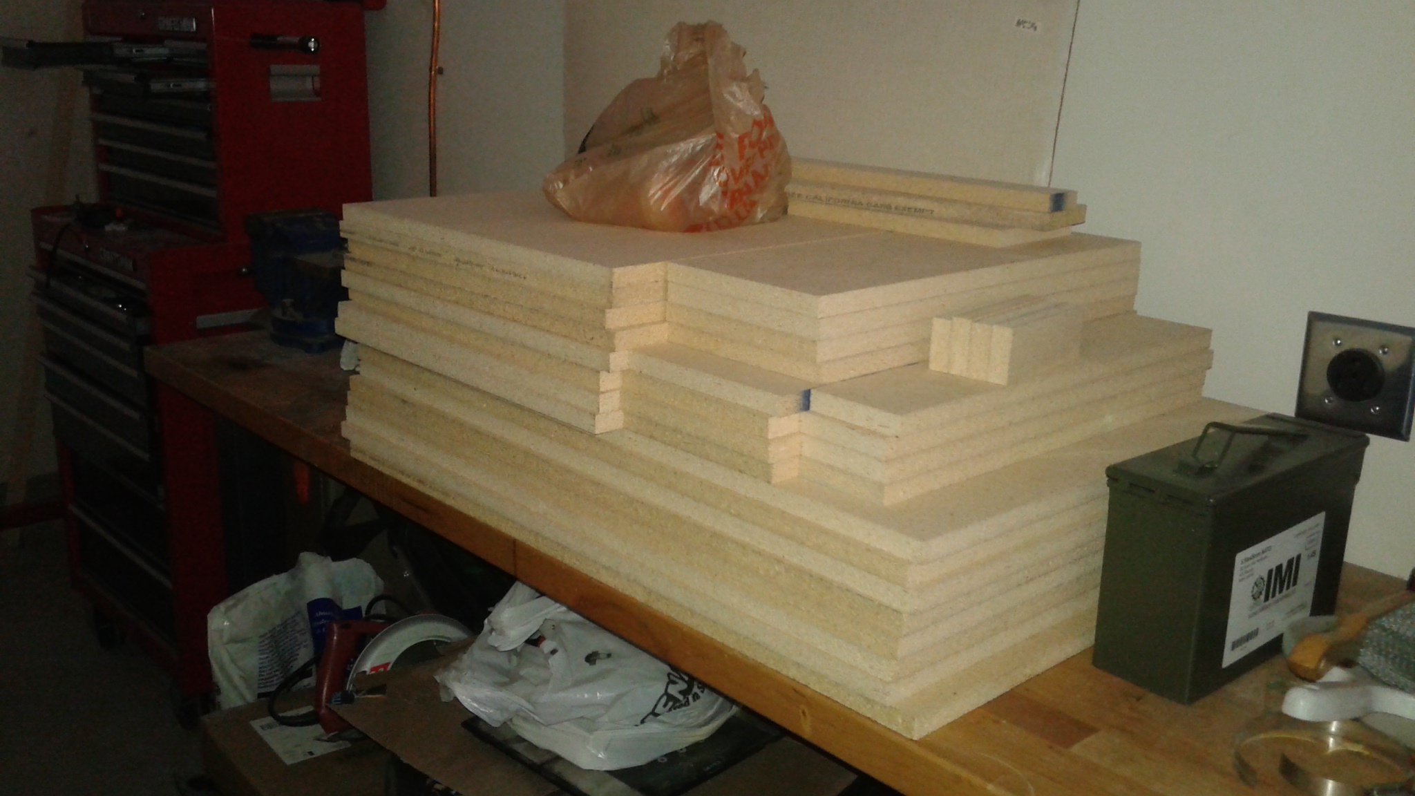

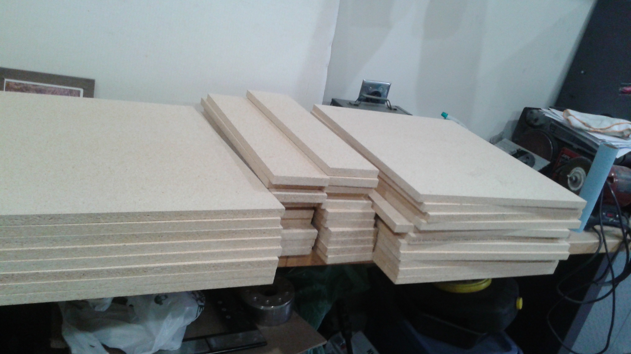

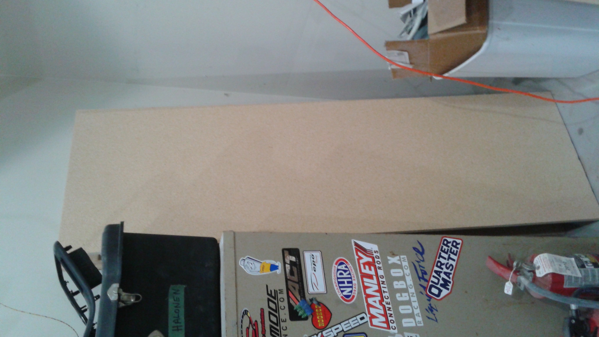

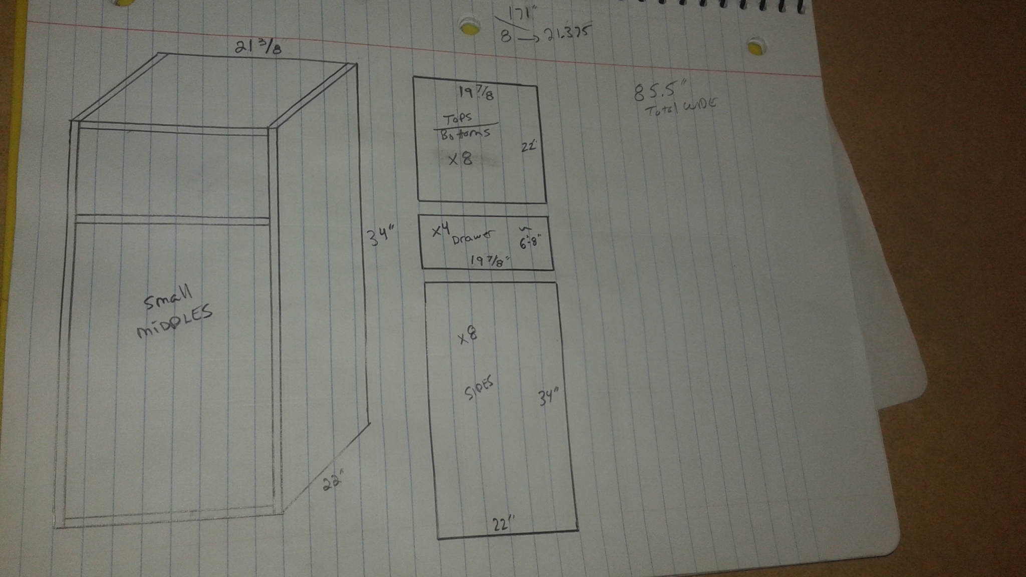

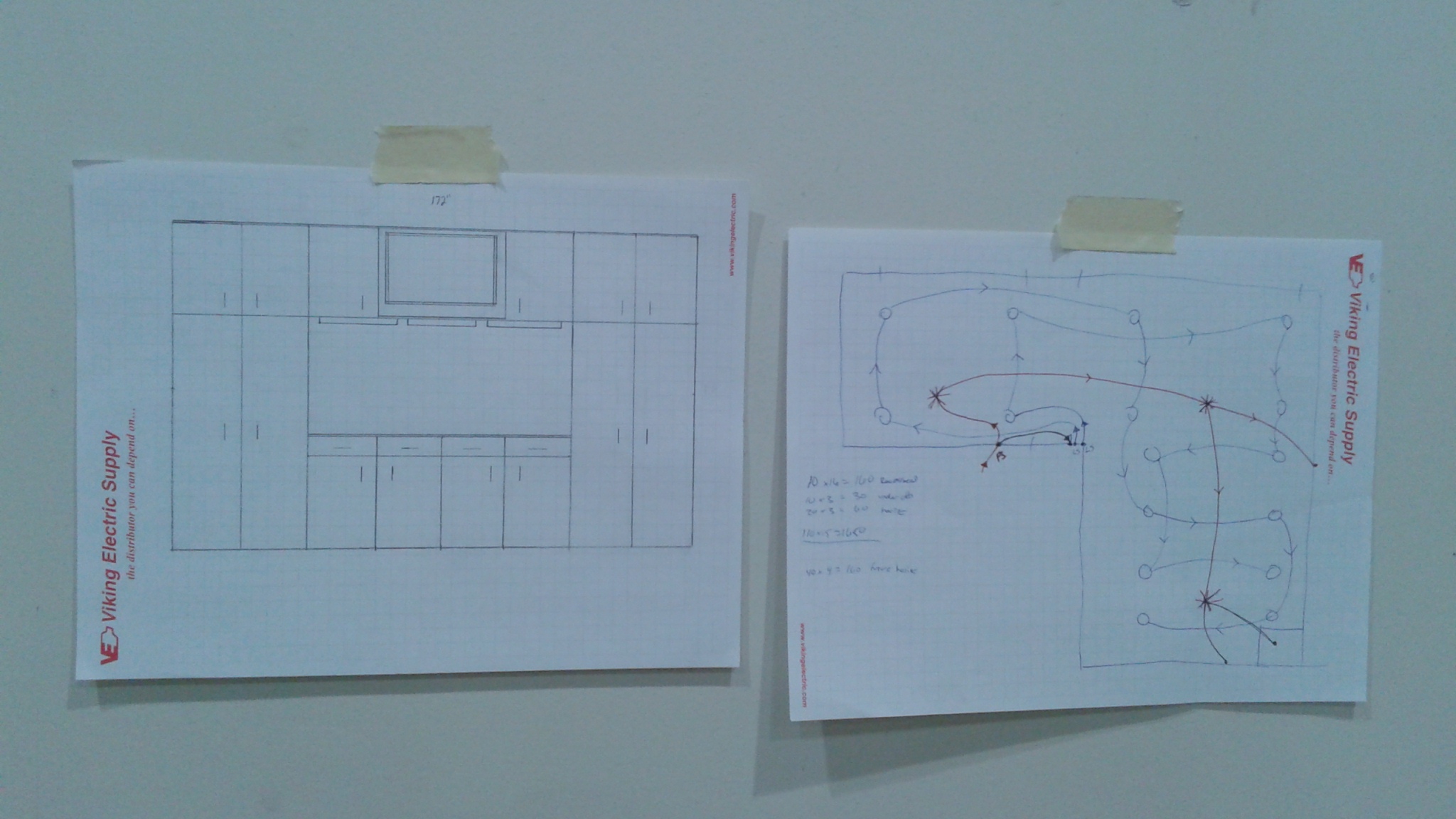

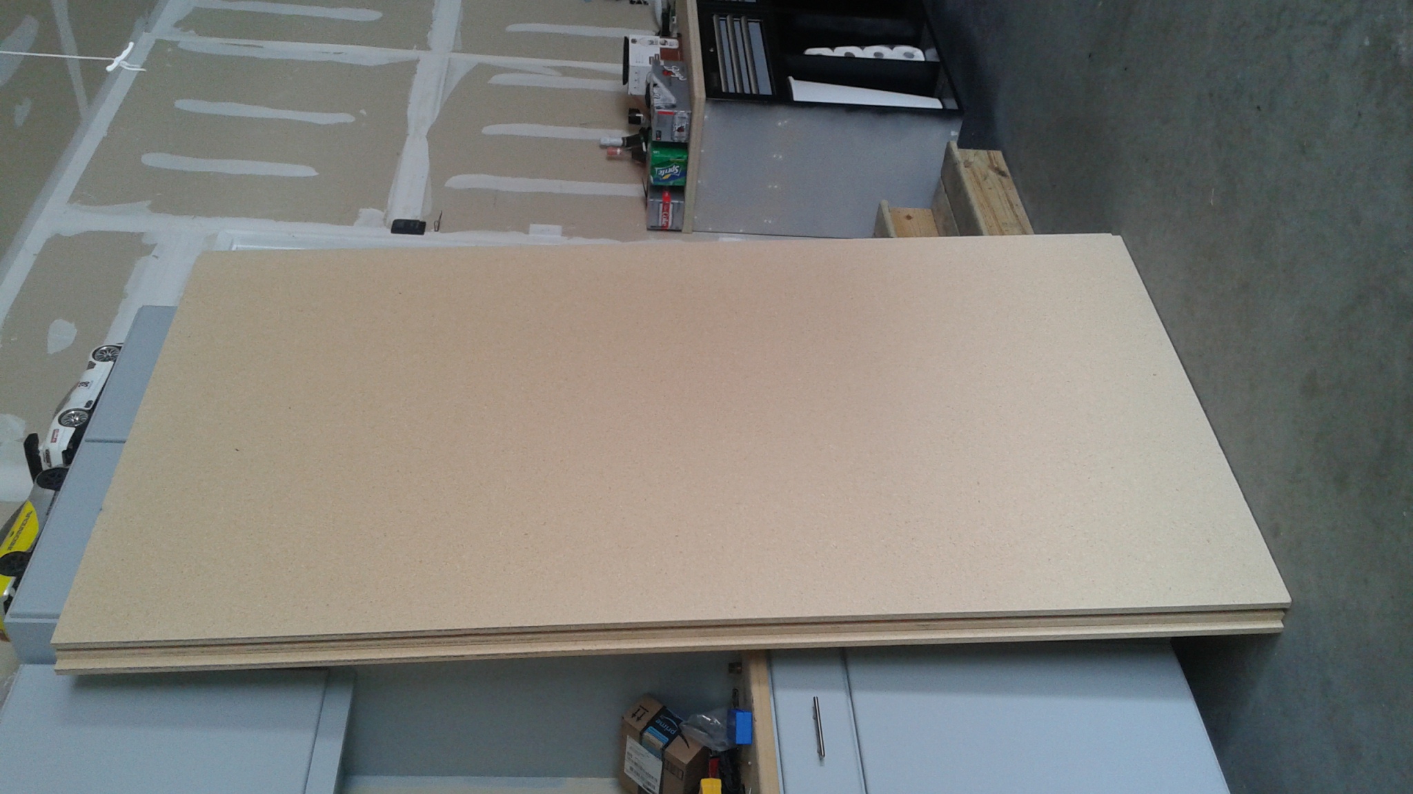

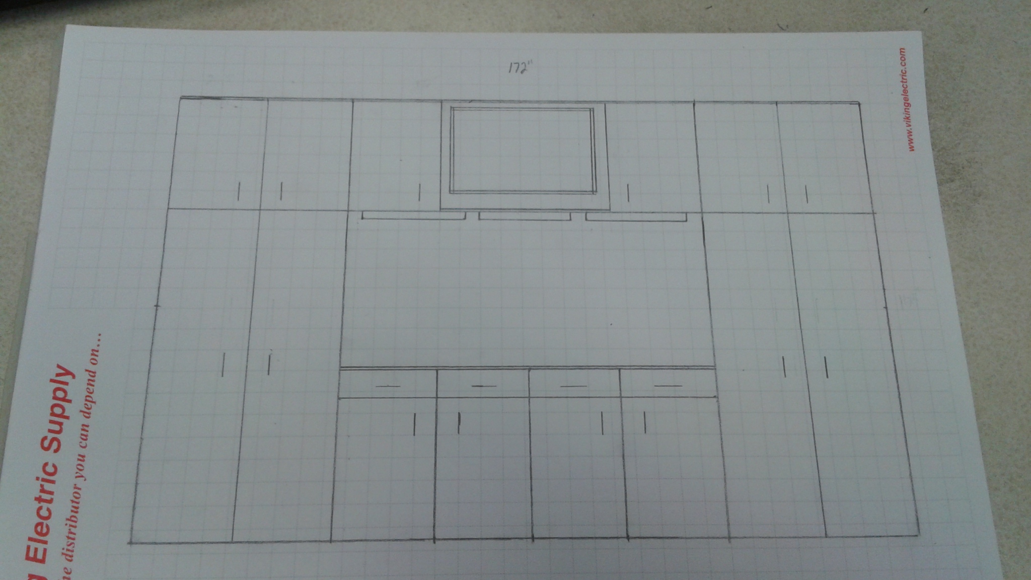

Phase 2 of garage mods have started. So with the help of Jeremy (supra guy who lives only a couple miles from me), we came up with these final plans for a cabinet arrangement on my back wall. So I took down all my old shelving last weekend on that wall, moved my work bench over, so I'm basically ready to start.
We took his van to Home Depot and picked up four sheets of 3/4" particle board for making the cabinet carcases out of and some other misc supplies (~$120 total). Threw em on his table saw and cut out the pieces to make the initial four lower cabinet carcases. I have them in my garage getting acclimated. Hopefully find some time to start assembling them in the next week or so. Pretty excited to finally start on these!
You can kind of see his grey cabinets in one of the pics. Those are basically exactly what mine will look like, copying his design since they seem nice to me.

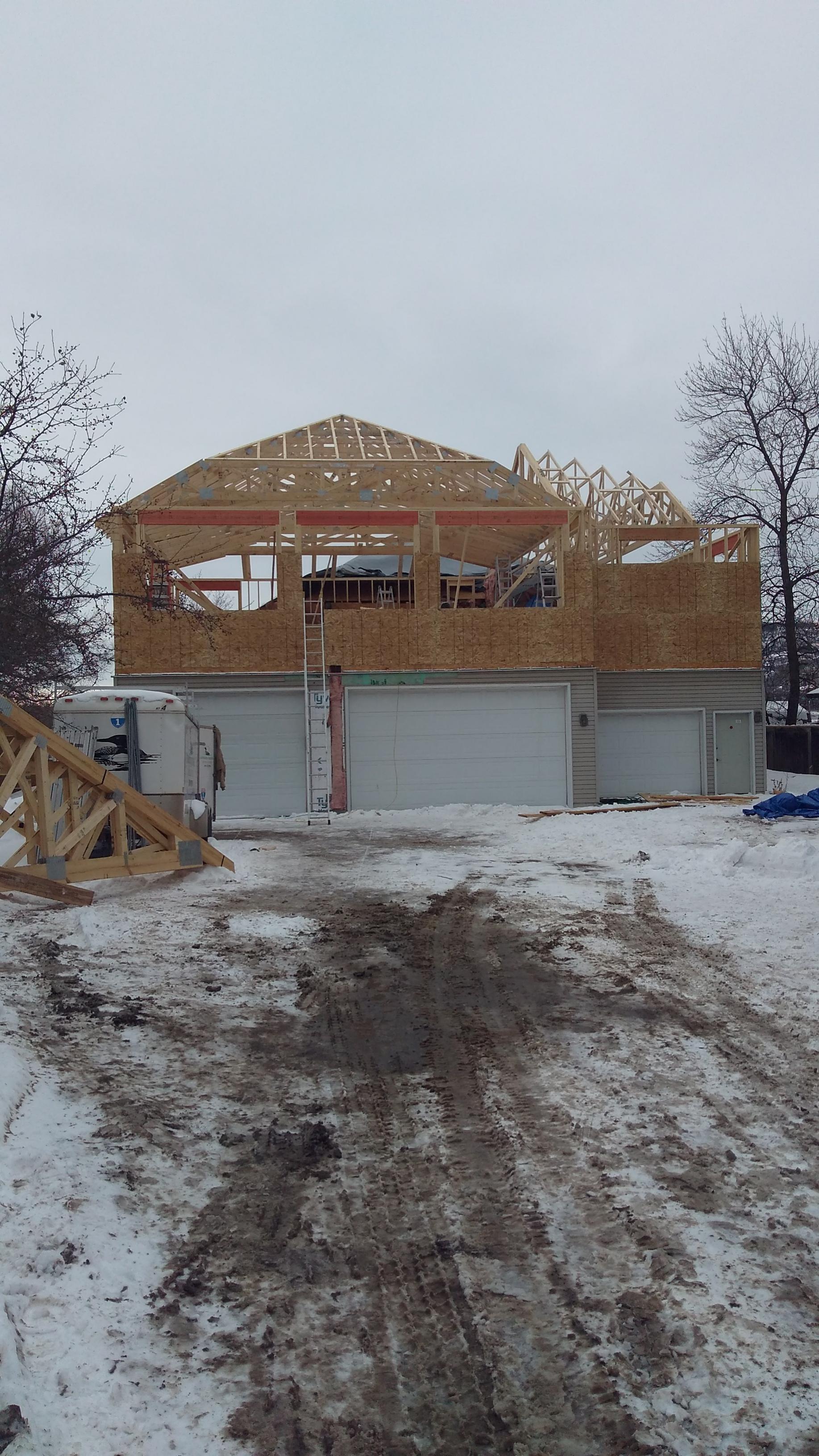

Little project we have been working on at work. We were pushed to a different project but cool garage remodel. It now has windows and little finished up. Garage had normal trusses on it and was fully finished off inside with sheetrock. We saved all the sheetrock with minimal damages and added floor joists and the 2nd floor. Garage is 50' wide and 40' deep.

fuck thats nice. I need that.

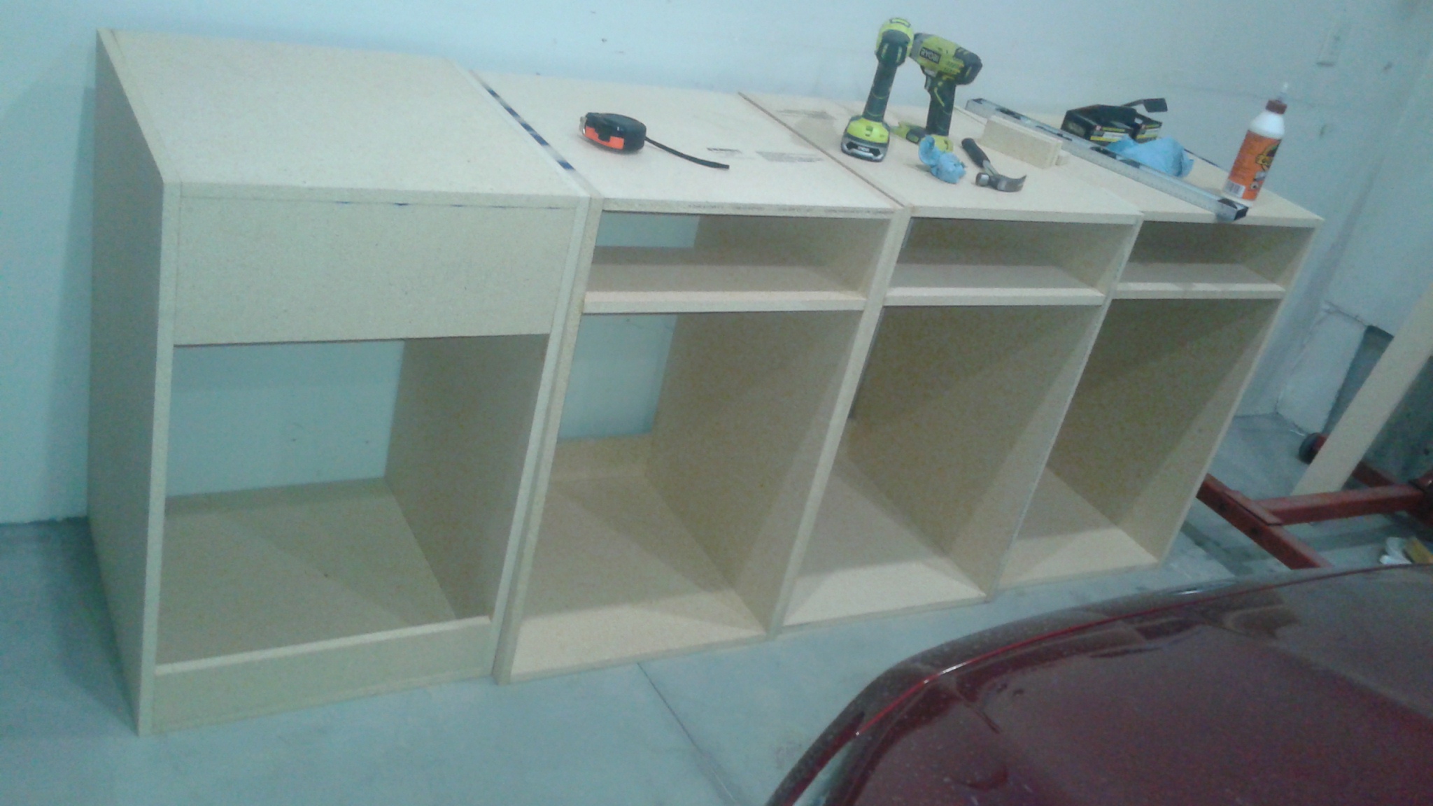

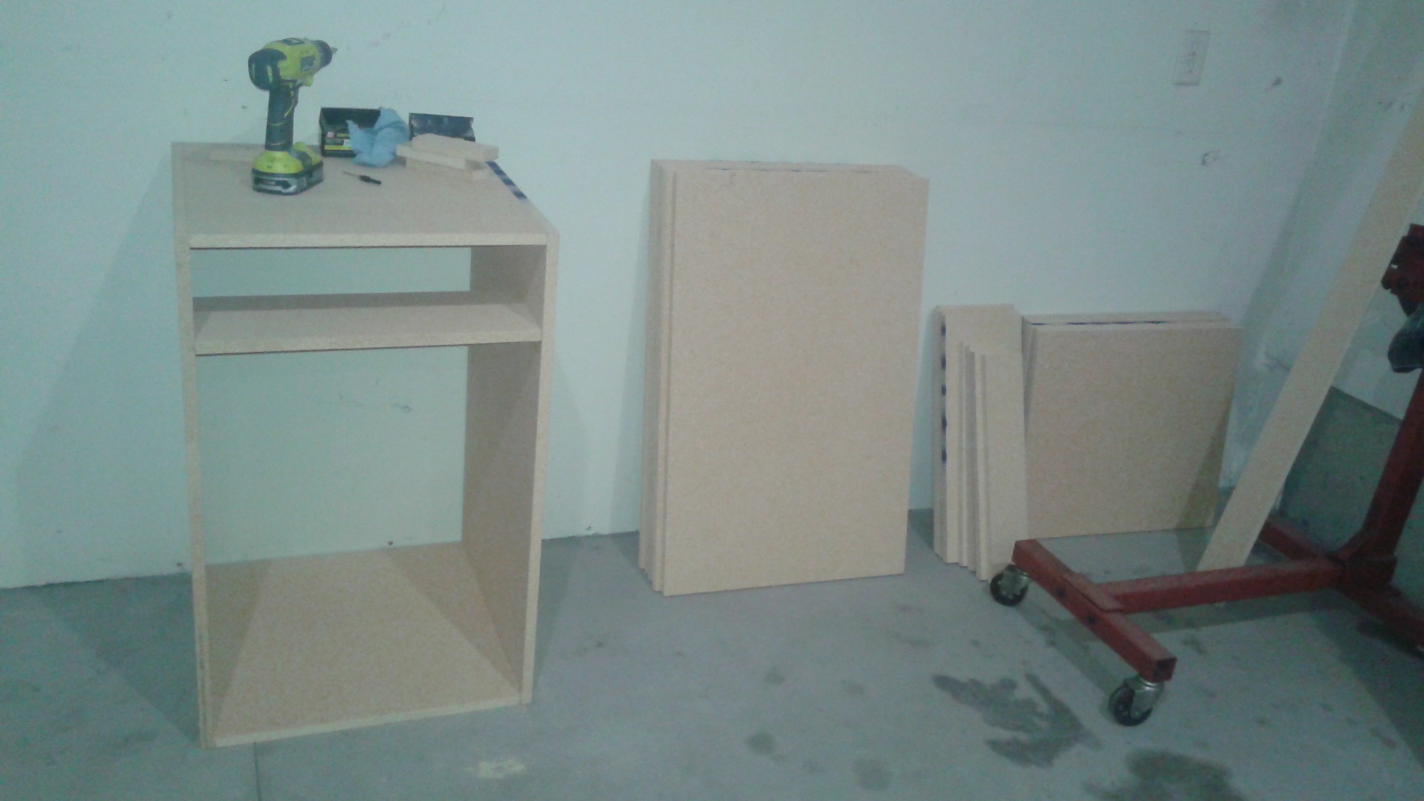

Just about done with the first 4 lower carcases.
Are you planning to set them on something off the floor? I would suggest green treat 2x4 on the floor for the toe kicks.
Old 03-05-2018   #1128
Re: House Projects
Yep they will be 4-5" off the ground. Mounted to the wall. So fully open underneath for things like drip pans to slide / store under.

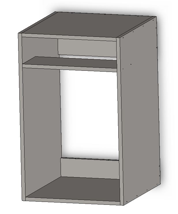

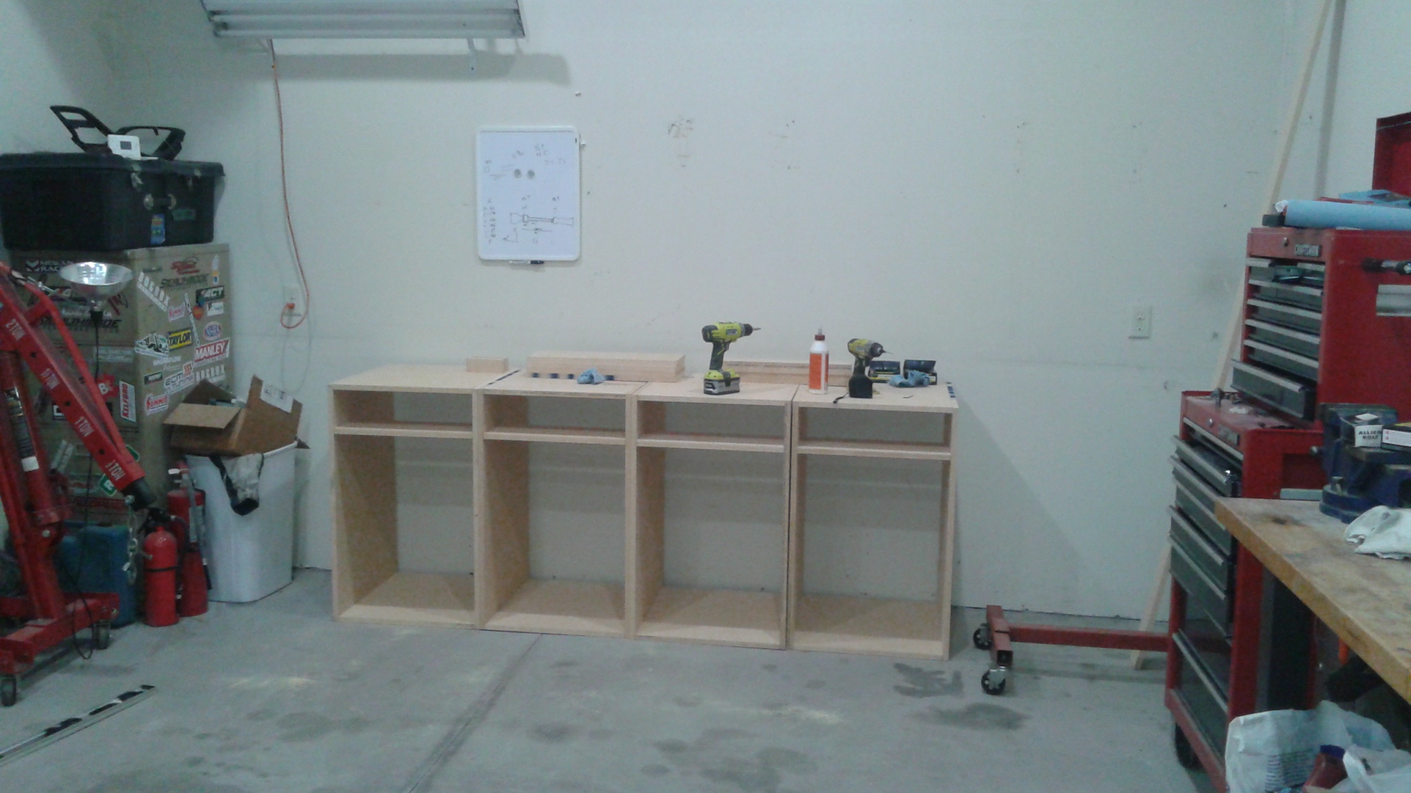

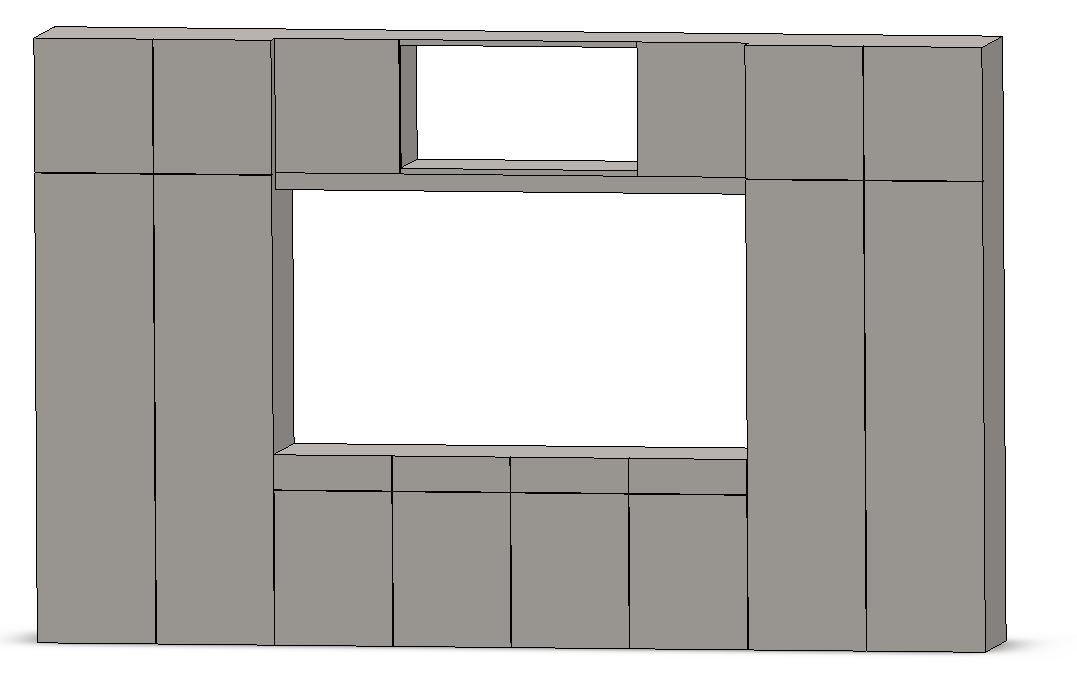

Got the lowers completely assembled with the backer plates on for screwing into the wall.
I want to make sure I document how I built them and all the measurements, so I nerded out a little in Solidworks. I drew a quick overall sketch of the general goal. Then I drew an exact sketch of all the pieces of these lowers. and assembled it in SW.
Next I just need to mount these to the walls and then go buy some more sheets of wood and start on the next pieces.

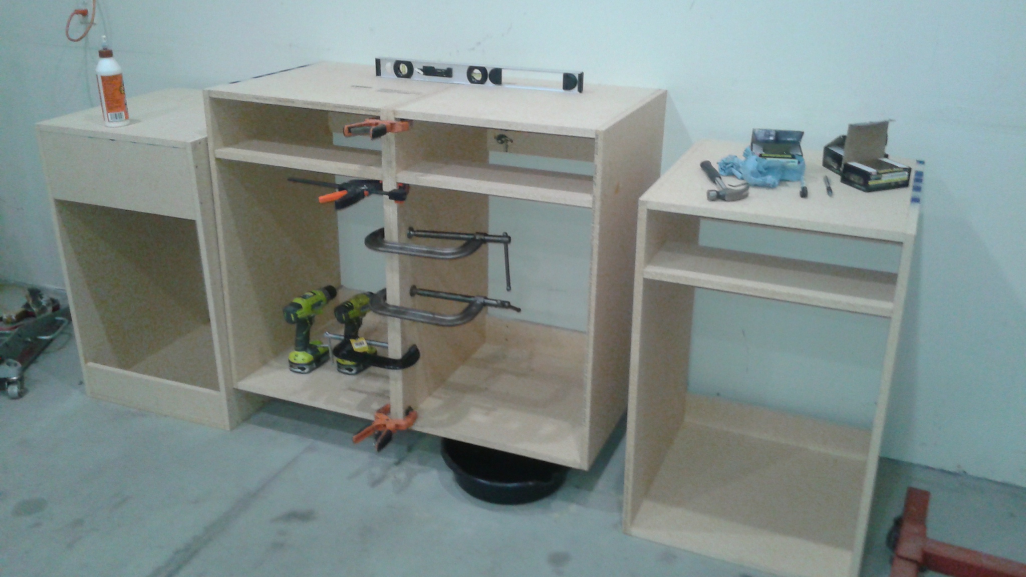

Started mounting them to the wall. Got the first two mounted. The are screwed into the studs, and I also screwed/glued them to each other. Ended up roughly 4.5" off the ground, drip pan slides under nicely.

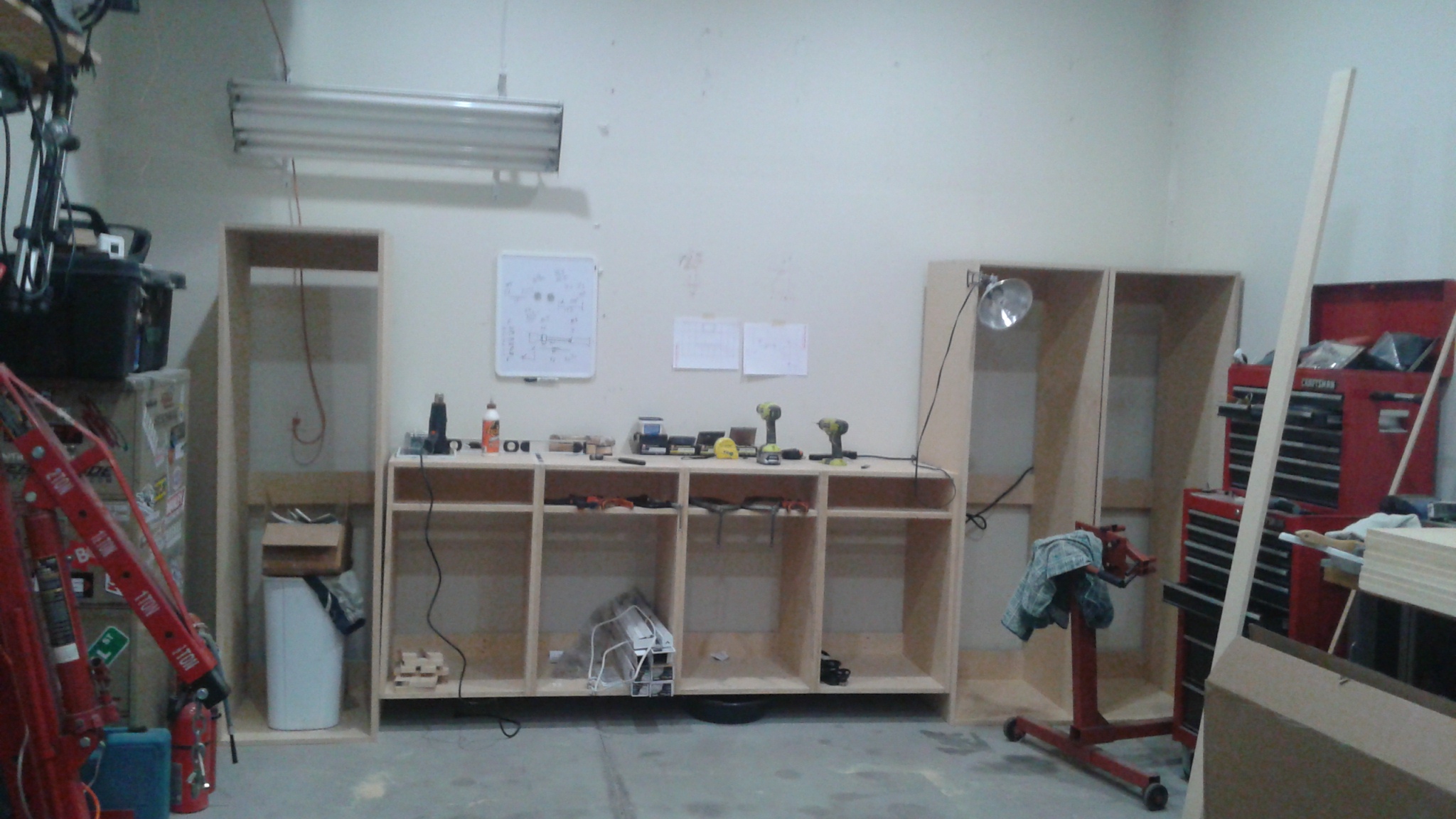

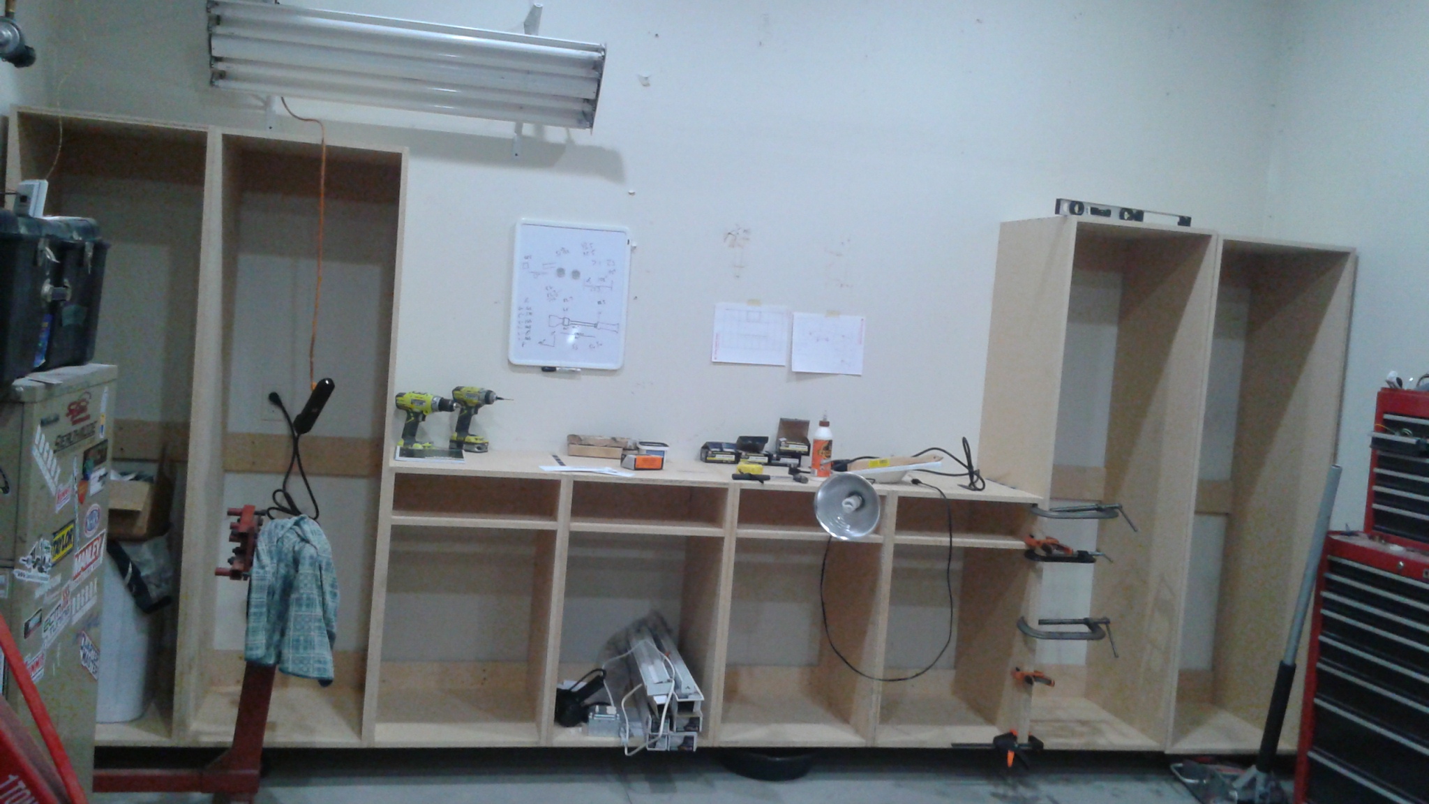

Almost done mounting the tall ones to the wall.

Looks really nice, wish I had the room to do something like this in my garage.

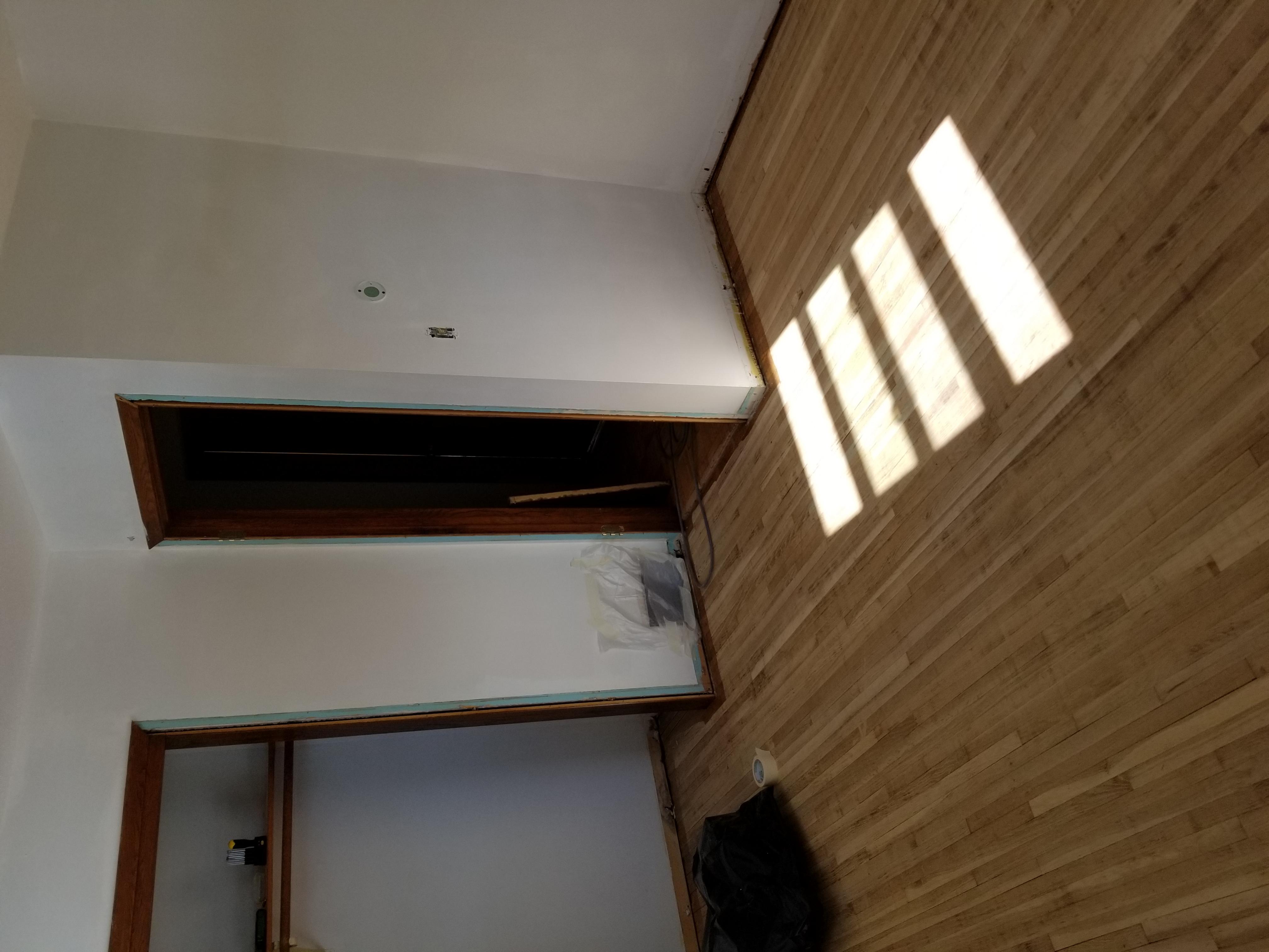

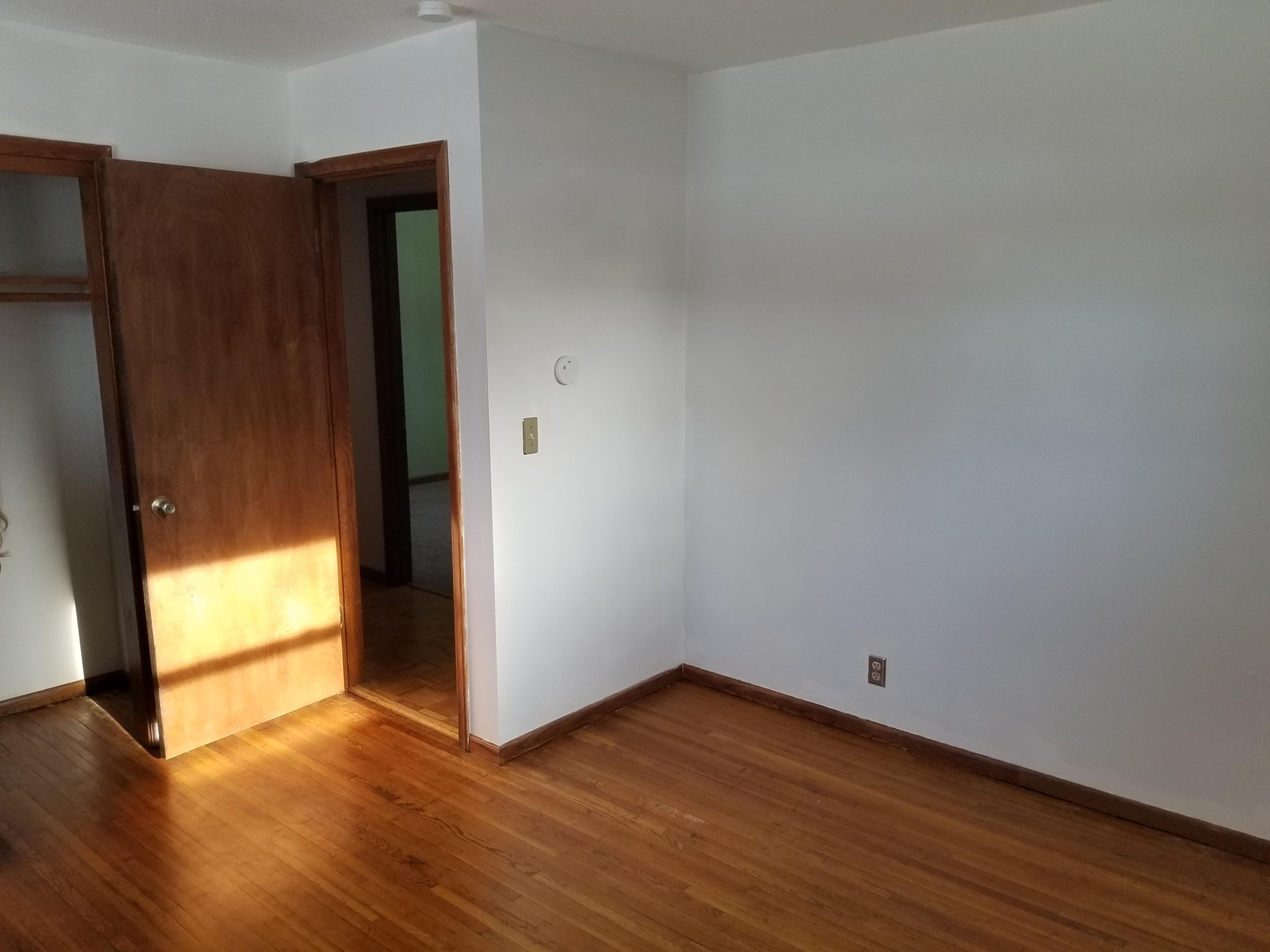

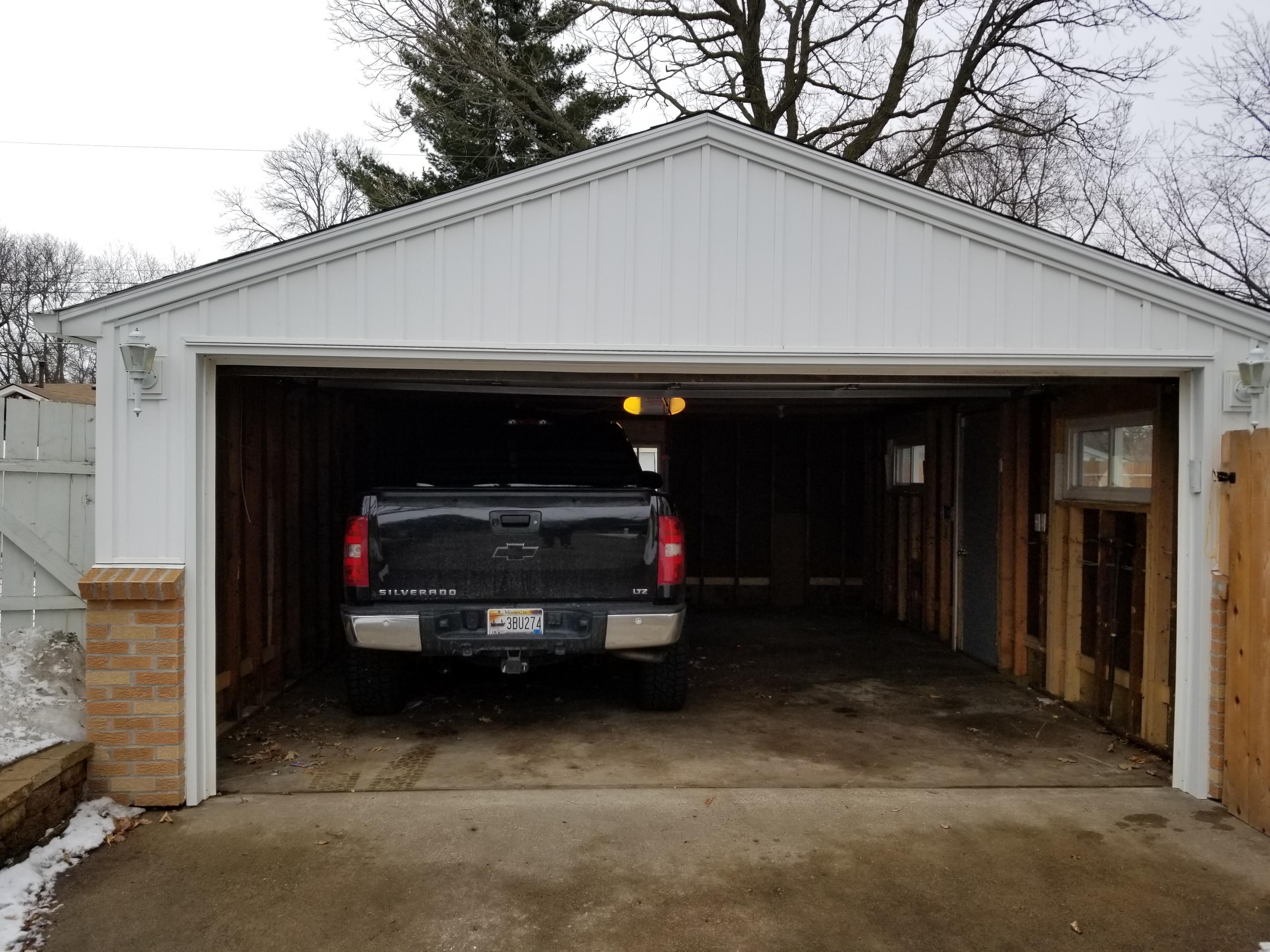

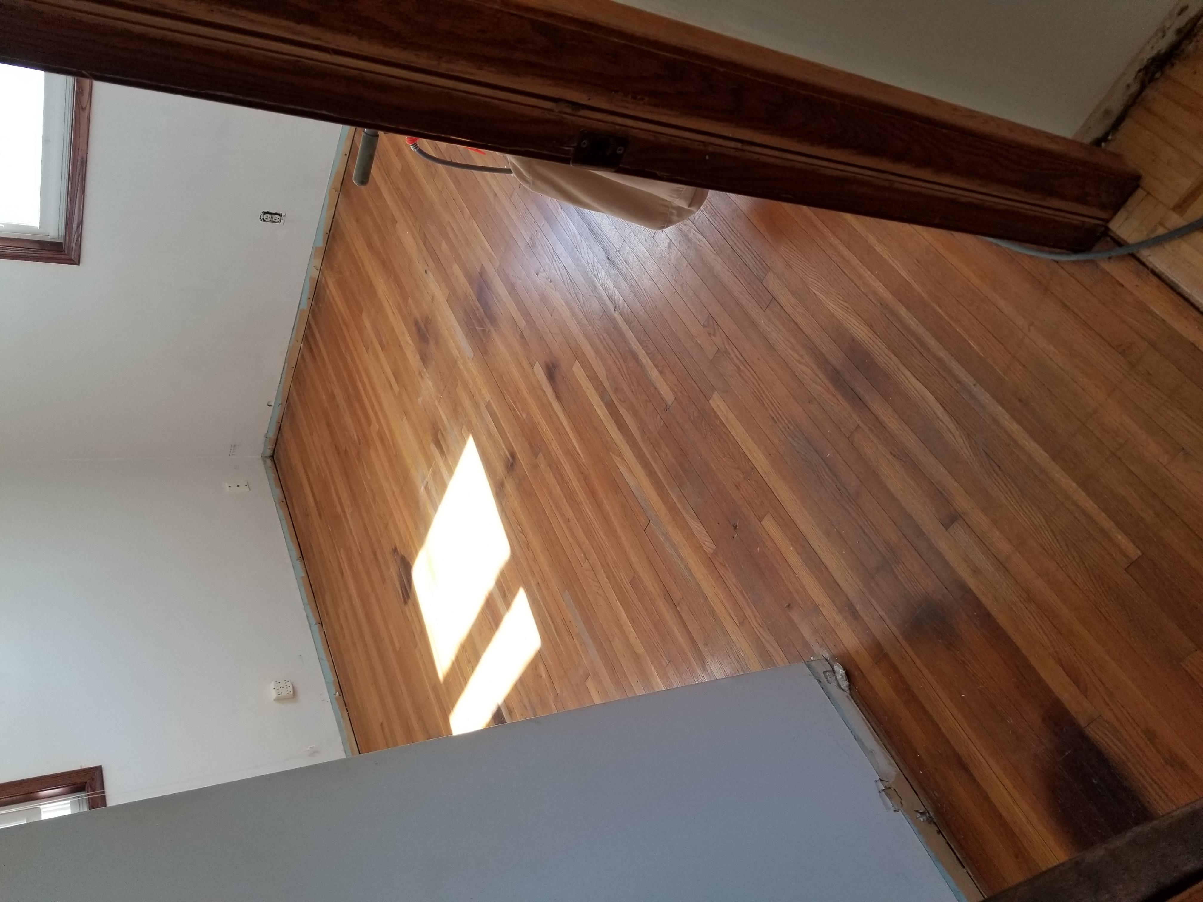

Closed on our house on March 26th and we've started construction on it before moving in. Plans in the near future are a kitchen remodel, moving a wall back to its original spot and redoing the flooring and trim as well as paint.
Most importantly, my truck fits in the tiny 2 car garage.
