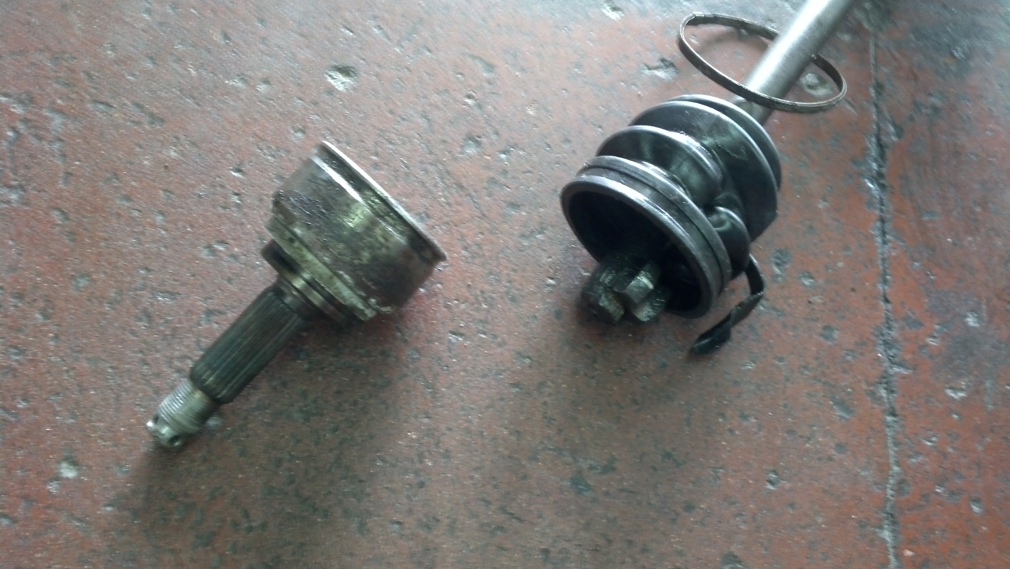

Alrighty well I jammed a new starter in the car last night. Was way easier than I remember. It took me about 20min total. I had my buddy drive the talon down to my work today to change the oil and tranny fluid. I have about 250 miles on the engine so I drained the break in oil out and put a regular conventional in for now. I switch from lightweight shock proof to the redline cocktail for my tranny fluid. So well see how she shifts with that in it.
I noticed that the right front axle was basically demolished. I'm surprised my buddy made it to my work so i also put a new axle in it. Tomorrow were swapping turbos and John is going to make my exhaust.

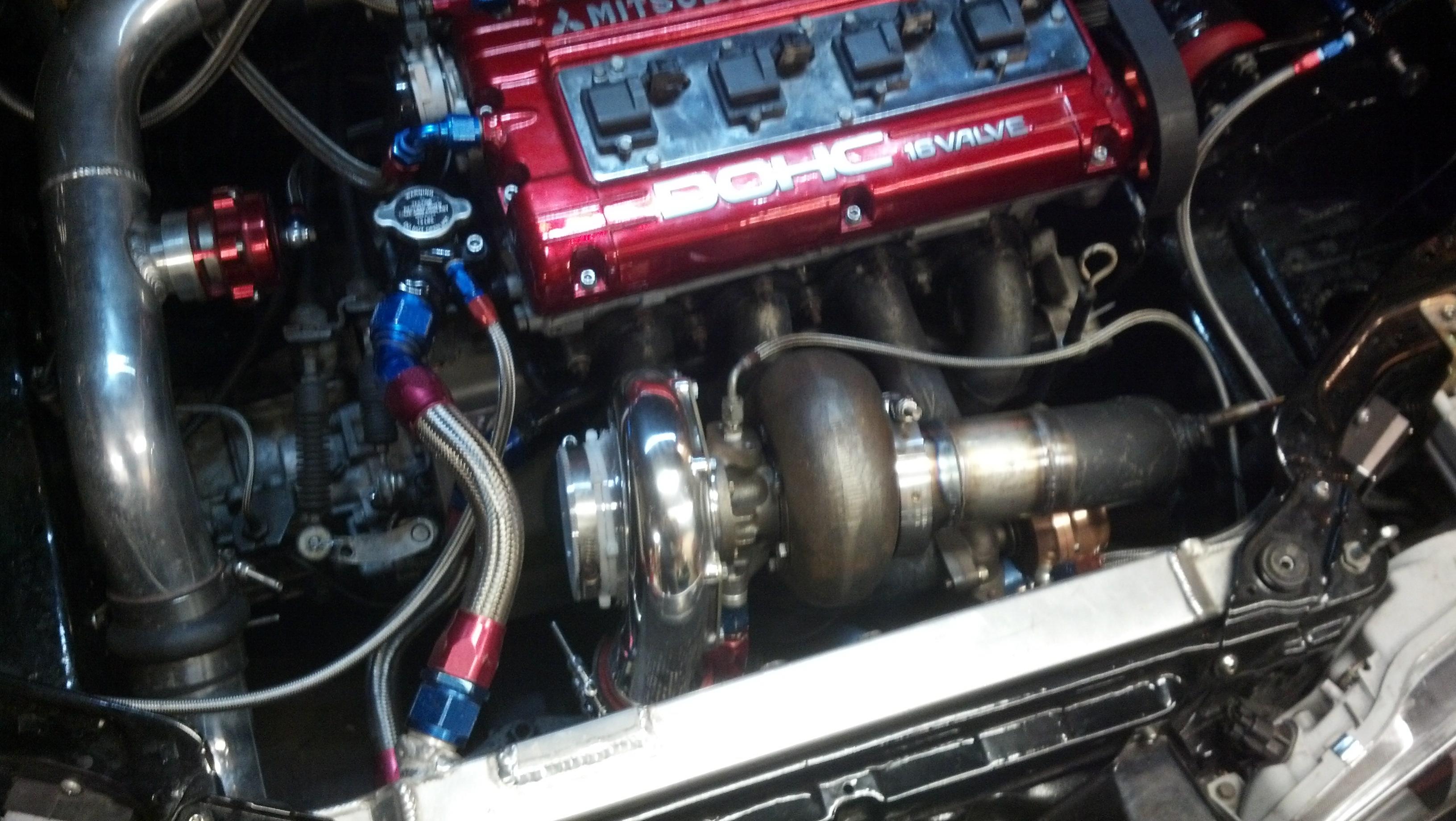

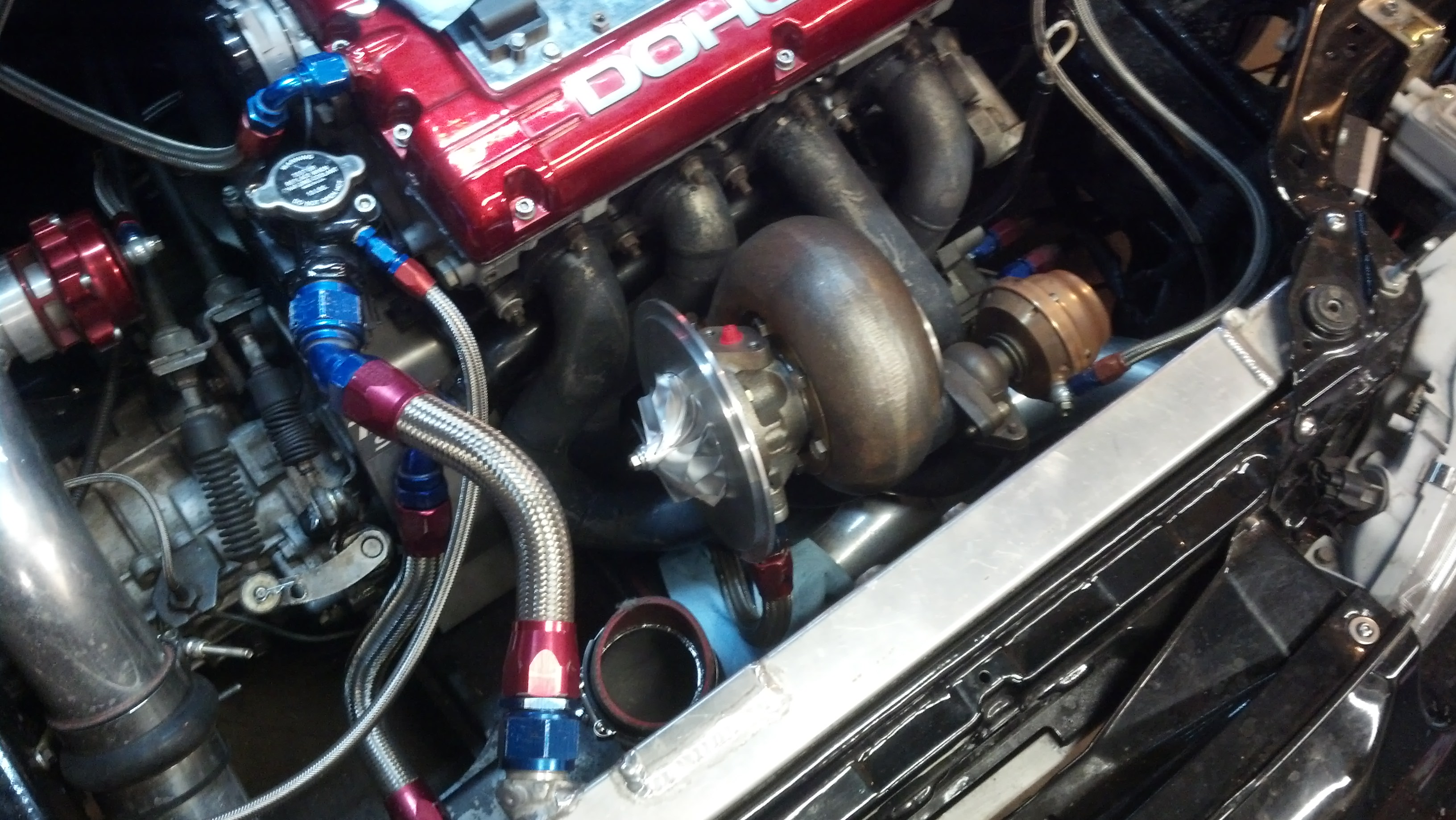

Alrighty I got the turbo swapped and John redid my exhaust and lower intercooler pipe to fit the 6766. So now the car is running on the new baby turbo. I just need to get an air filter and make an intake pipe or see if I can get a 5in to 4in reducing coupler and make my intakepipe from the gt42 work. I'm also going to need to get the turbine housing ceramic coated or buy one of those turbo blanket thingys because it cooks the carbon fiber hood pretty good.
Also between yesterday and today I've put about 200 miles on the car so the engine now has over 400 miles on it. She's just about ready for the dyno. And big thanks to John (pushit2.0) for letting me swap turbos and his place then redoing my exhaust and intercooler pipe!

Looking good. Shouldnt that center section of the turbo face up and down and not be at an angle like that for the oil to flow out properly?
Amsoil Dealer
Old 04-07-2013   #273
4seasons69
4seasons69's Avatar
Location: Circle Pines
Posts: 2,048
Re: my new project
thanks! It would probably be a little better if it was straight up and down. The gt42 was at a slight angle to and never had any problems. With the current oil drain line if I put the center section straight up and down it will kink the return line. And I'm not at a point where I can or will make a new line. so I guess it's pick your poison. Plus everything is such a tight fit in there with the top mount manifold I don't want to mess with it too much cause it seems to work right now
