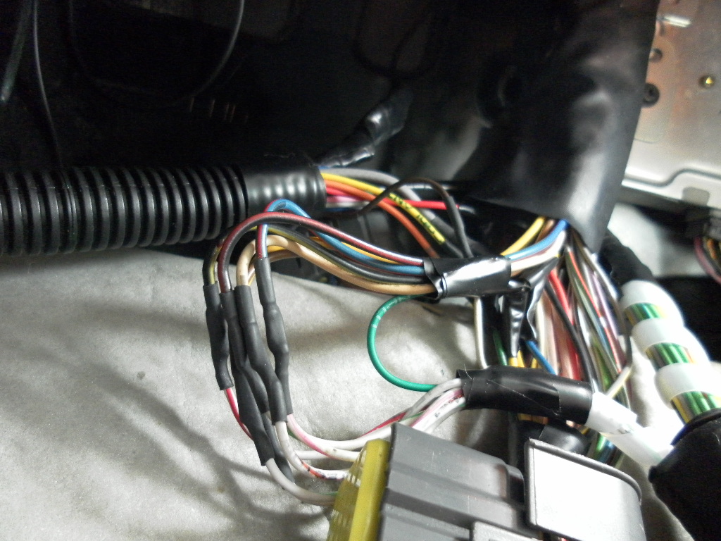

Started on Phase 2 of the MS3 install. The injectors and ignition are all wired up. I had to actually cut these wires, and solder and heat shrink them to the MS pigtail, since MS is taking over full control of them, stock ECU has no control of them anymore.
I need to run a vacuum line to it now for the MAP sensor, then get a base tune from Jordan @ Powersquirt, and another start-up video shall be made

I'm impressed that you picked up a soldering iron and went to town on your own car like that, very nice. Even tinned the wires and used heat shrink tubing!
Now don't lie, how many wires did you solder and forget to put the heat shrink on first?

Haha, only once (the first wire). I'm a quick learner

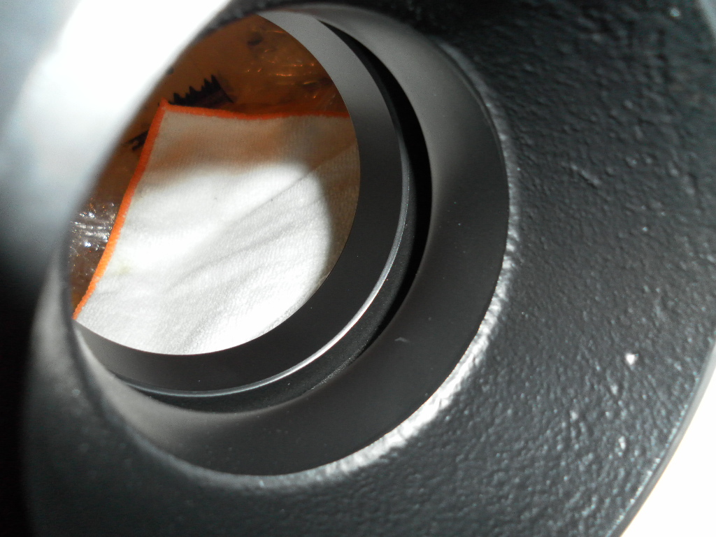

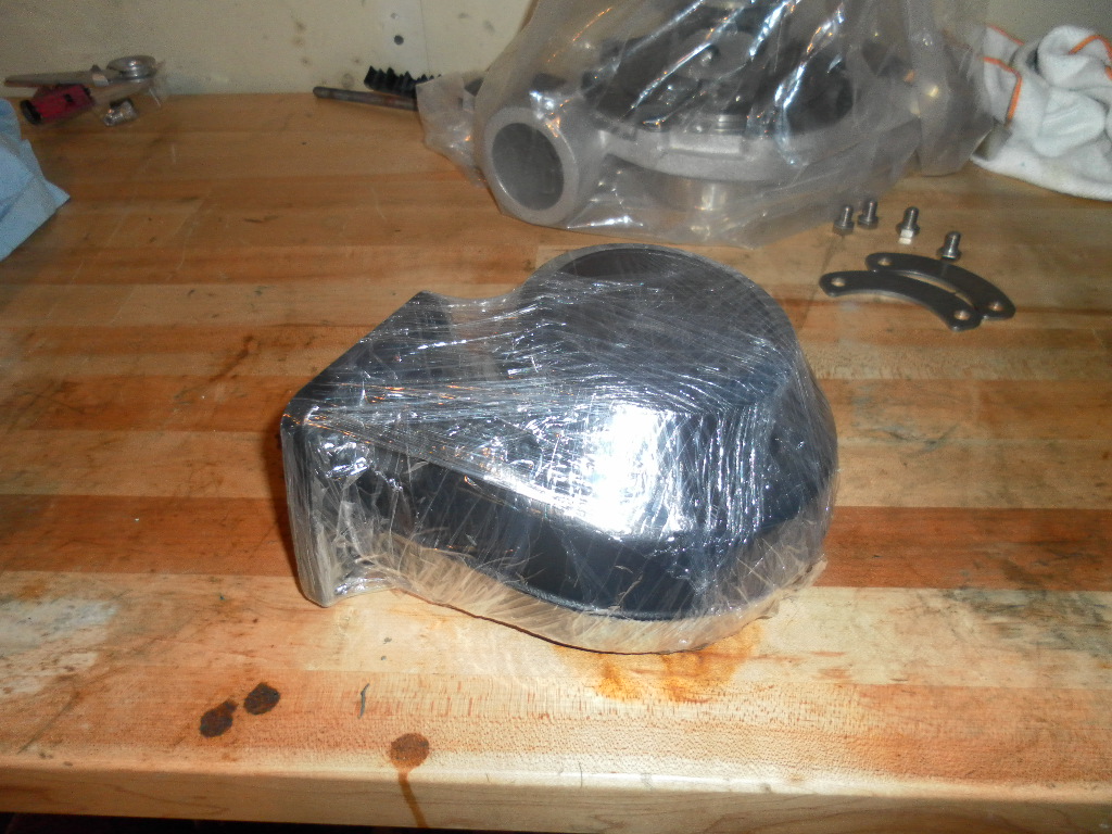

Been awhile since I've been able to get back to this thing. Been busy lately!
Got the turbo exhaust housing back from Primo Performance from being coated. Looks great thanks guys!
Started it up with the MS3 controlling fuel and ignition for the first time today also. Runs a little rough, but that's to be expected for the first start-up Again big thanks to Jordan (Shaodome) for the help!
