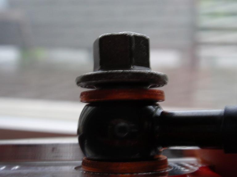

SPECIAL M10 X 1.5 X ~24MM BANJO BOLTS REQUIRED FOR THESE CALIPERS.
DO NOT BUY THE BANJO BOLTS FROM THIS SHOP. THEIR THREAD DESIGN WON'T TIGHTEN DOWN FULLY ON THE BRAKE LINE BANJO FITTING. SEE PICTURES BELOW.
here you see how they grind down some of the threads, which is what creates the problem:
Buy Ford Racing Parts!
here is the bolt fully tightened down, and you see it doesn't come close to clamping down on the brake line fitting:
