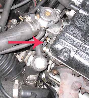

the plug that runs the temp gauge is the smallest connector on the entire thermostat housing. It's a single wire with a female connector thing on it, and it plugs into a male prong thing that is sticking out. Hope that makes sense, it prolly just came unplugged. I've had mine fall off a few times.
Old 08-18-2004   #3
Here's a pic of it, kinda hard to see but hopefully helps.

Thanks, I will go fiddle some more. I think the one in your pic is the double prong plug though.

Yeah, I am quoting myself. I corrected me612 and my correction was based on me plugging shit in wrong. LOL. I went out and looked at it, I had the single prong in the double and visa versa. Thats what I get when I connect stuff after about 9 hours worth of working on that damn thing. Runs well now though. Thanks for all the help guys!
