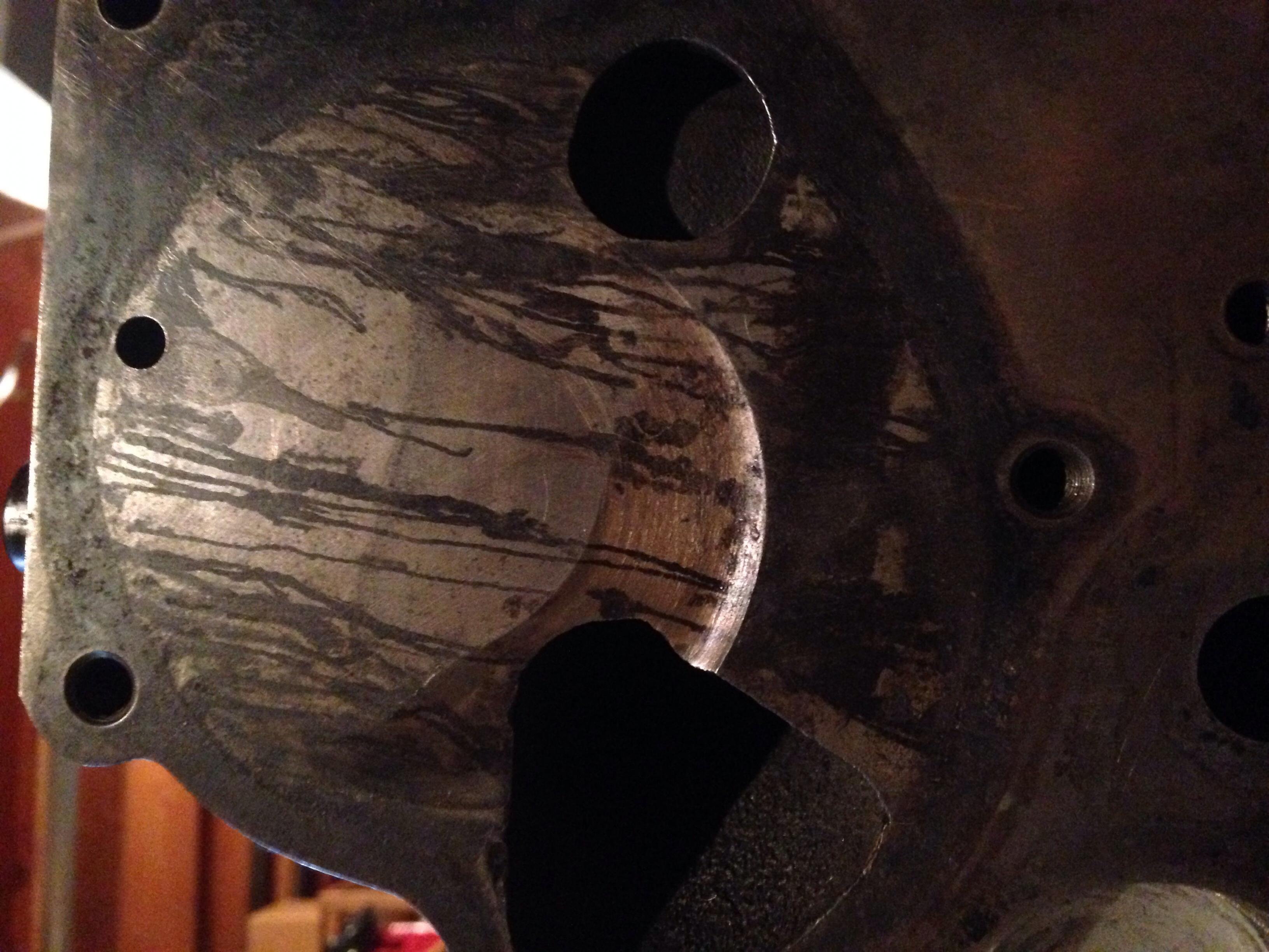

So I was going to start prepping the block for tear down and noticed that the guy who built it before jb welded the freeze plugs in, figured I could still grind and pound them out, but then I noticed this wear from the water pump.. This has me worried the block is no good. Any thoughts?

Take a clearer picture please, its very hard to tell. Looks pretty normal from that funzzy picture though

Sorry didn't realize it was blurry

Yea, there is definite wear on it! I guess I wouldn't be too worried, You'll have mroe water flow! haha
Old 10-25-2015   #5
Re: This block still good?!?
Hmmm, I wouldn't use it personally. It might be fine, but I'm not sure how well the pump would work with that huge clearance.

Brought the block into work, they said I shouldn't have an issue. But just for kicks since I got time yet, here's more pics

I think my old block was like that, I had no cooling issues driving it in 100* heat in TX.
I think you will find most DSM blocks to be like that these days.

Y'all need to change your water pumps out more frequently.

Good deal, thanks for the input guys. So far the plan is still to build this block.

Wow that sure is a big groove! Like Aaron said above, it'll probably work fine.
