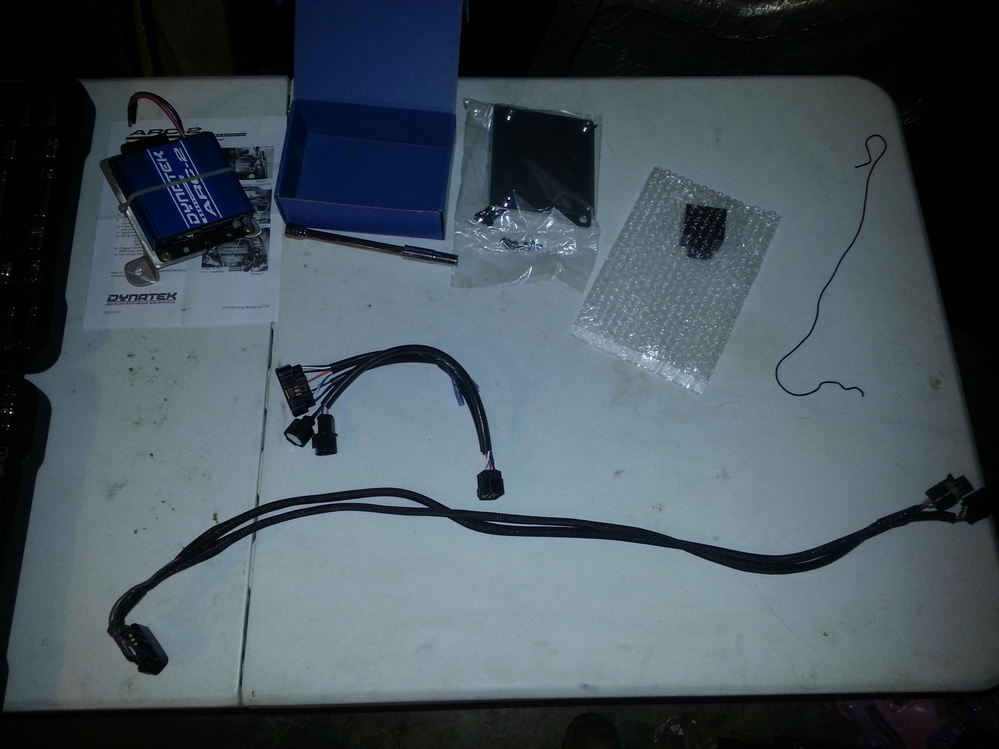

Well fuck, why cant anything just be simple.
Got the harness and the one on the car isn't even close to the one I just got.
Only 1 of the plugs match to what's on the engine harness now.
And they are no where near the same lengths. And I really dont want to destroy either harness to piece it together. The long harness isn what was on the car, small one is the pnp.
At least I brought the snap ring plyers home from work so im praying at least that part of my night goes better
