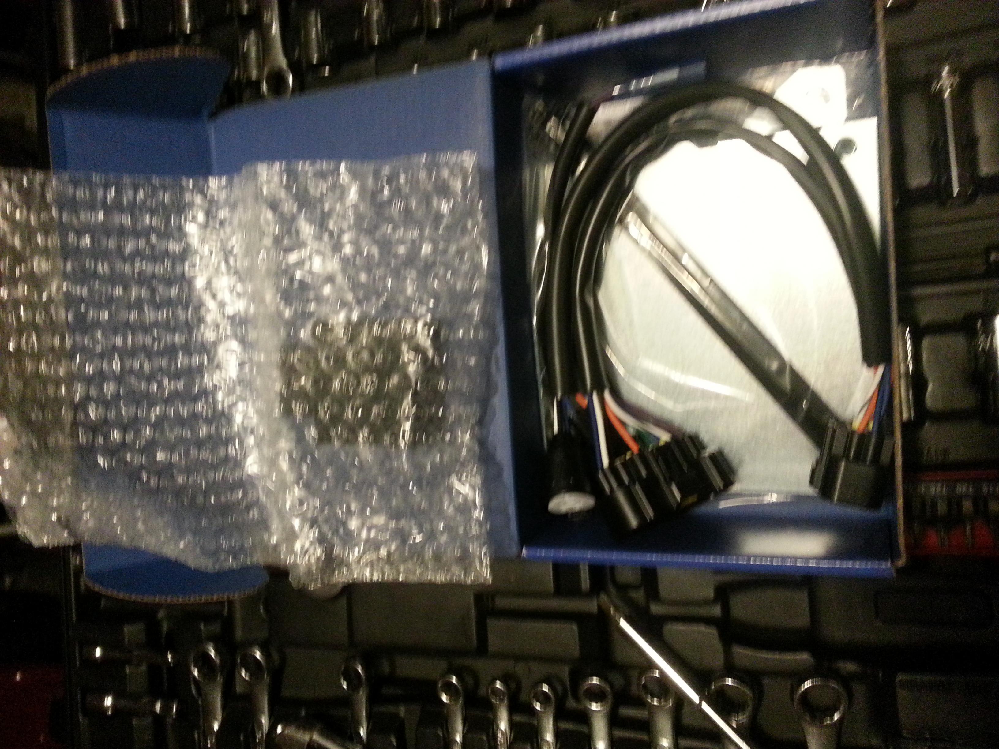

Well fuck, why cant anything just be simple.
Got the harness and the one on the car isn't even close to the one I just got.
Only 1 of the plugs match to what's on the engine harness now.
And they are no where near the same lengths. And I really dont want to destroy either harness to piece it together. The long harness isn what was on the car, small one is the pnp.
At least I brought the snap ring plyers home from work so im praying at least that part of my night goes better

Well saturday I worked on the car.
Although link shows fuel flow during cranking the gauge on the fpr reads zero.
I traced the power all the way to the pump and the relay is good and the power gets to the plug to the pump.
I havent taken the pump out yet. But that's my next step. Was happy to see that I do have braided line/ an fittings from the pump. And there is zero rust anywhere that I could see in the pump area
If extremepsi will ever refund me my damn money for that pos. Bep housing they sold me (back on april 4th, they've had it back now for 2 weeks and wont respond to any of my messages) would be great
CALL THEM! I remember having similiar issue and literally had to call NON STOP to have them check into it...its a hassle no doubt
