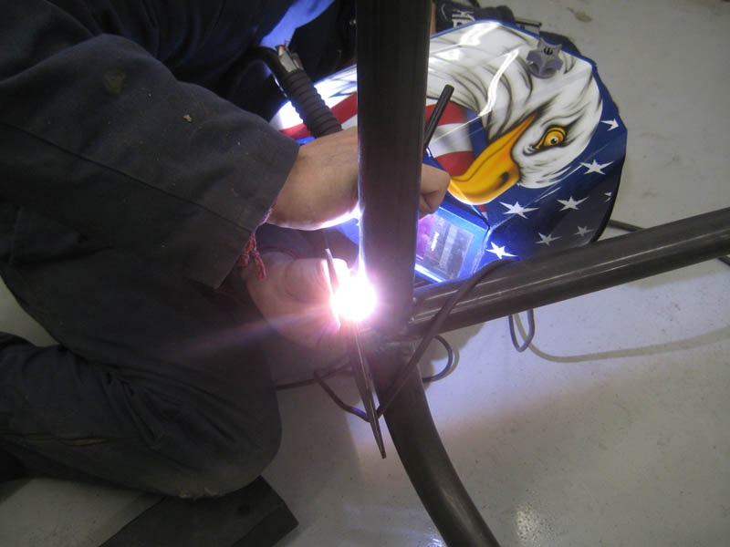

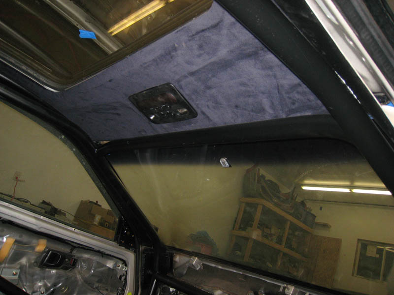

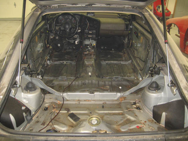

After being out of the DSM-scene for almost 3 years, I decided to get back into in. I bought a shell and I am in the process of piecing everything together. One of the items on the todo list was a 10pt 4130 chromoly rollcage, since I plan on the car being reasonably quick. I am posting this to get opinions and critisicms, so fire away.
The cage is not complete yet, it is mostly tacked together and everything is notched perfectly. I still have to weld in 6x6 plates everywhere, put two more supports on the rear strut tower brace and turn into some sort of a crazy contortionist to get everything tigged together ... but it's fun, keeps me out of trouble and gives me something to look forward to in the end.
Three years ago I built a tube chassis 1G DSM, that is still to be finished and I thought that a 10pt would be a walk in the park, but the way I am doing it ... is proving to be a royal pain in the ass. Everything gets in the way of welding. With the tube car, I could remove the body, flip it upside down and weld away. Not so much here
I want to follow the curves of the car, make it stealth, be legal and keep most amenities, like back seats, rear-view mirror, visors, etc., so I am paying for it.
Here are some pics ...

I would have made the rear down bars straight and to the "frame" rails in the back. Also I have not seen 2 piece front down bars before. Good luck finishing up the cage and getting it certified.

Finally got done welding the cage and went to Rockfalls on Saturday and got it certified. It is as tight as it can get to every single part of the interior. Tig welding the whole thing was an absolute bitch, but it is finally done and I am happy with how it turned out. Special thanks go out to Jake for hanging out with me and not sleeping for 30+ hours the Friday night/Saturday morning. He migged 8 of the 10 plates to the floor and was modulating the pedal while I was folded in 57 different positions trying to get everything welded up. He also primed and painted the cage, since I suck pretty badly in that area.
Here are some pictures ...
