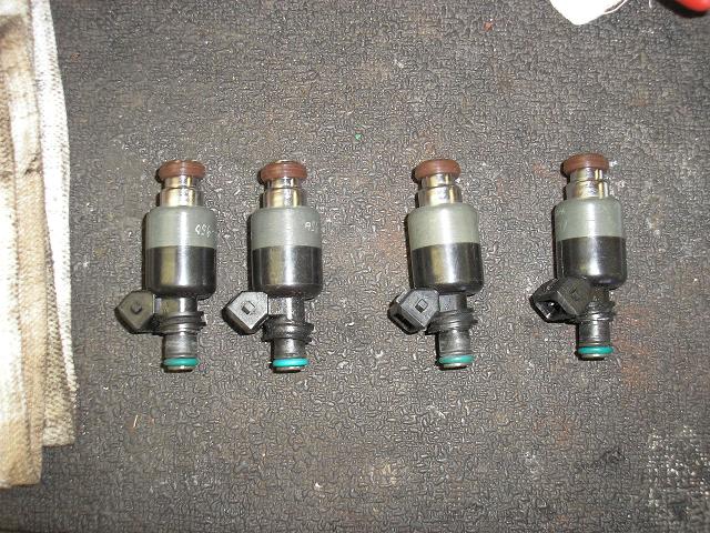

So over the last few months, I had been pinching my pennies, and buying things whenever a deal came my way. I ended up getting a dual ball bearing GT3076 for the new turbo, a Tial 38mm wastegate a Magnus intake manifold, ported and jet coated 2g exhaust manifold, some 950cc FIC injectors, and a GM maf and translator. I came across a pretty good deal on a built motor, so I decided to pick it up. Once we got it torn apart, we found out the oil pump siezed, and spun all the main and rod bearings. Another suprise was awating us as well. I was told that the block nad Wiesco pistons and Eagle rods. To my suprise, the pistons weren't wiesco., They were JE pistons, so that made me happy. All the bottom end needed was a set of bearings, and a crank, so I got a used crank that was in good condition, and some ACL race bearings. While I was at MAP for the crank and bearings, I decided I'd throw some ARP head studs on it as well.

pic 5: the FIC 950's
