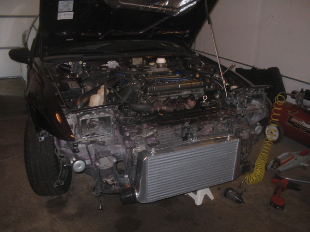

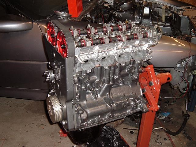

Well, things are coming along very nicely on my car. I should be able to drive it to the cookout on Sunday.
The bottom end has fresh bearings even though the originals looked fine. The cylinders were rehoned slightly larger than before and new pistons put in. The head was welded up and decked (a lot!!). My lumpy cams (crower 415's) are in and the fidanza cam gears on. Thanks Mike for the help with the engine!

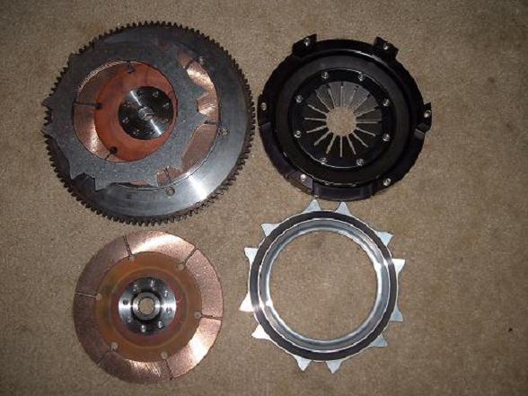

I got a big ass FMIC for it and I am making 3" IC piping for it. I am running the stock intake manifold until mine are completed. Same turbo as before (SCM61 with T04S cover). I also put in a twin disk clutch this year. I spent WAY too much time detailing and painting the engine bay. The pic's don't do the engine bay justice.

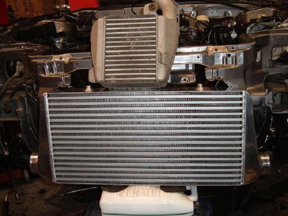

The bottom pic is a stock 1g SMIC on top of the FMIC.

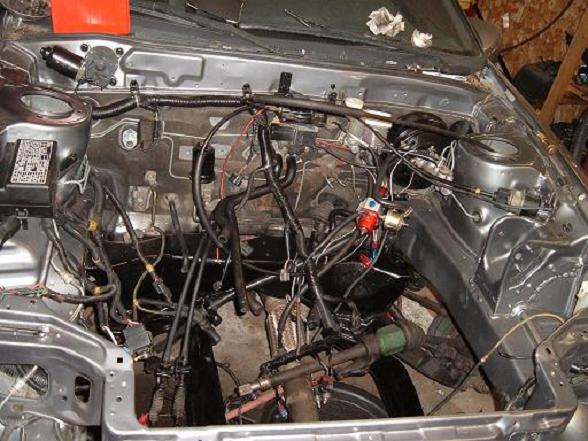

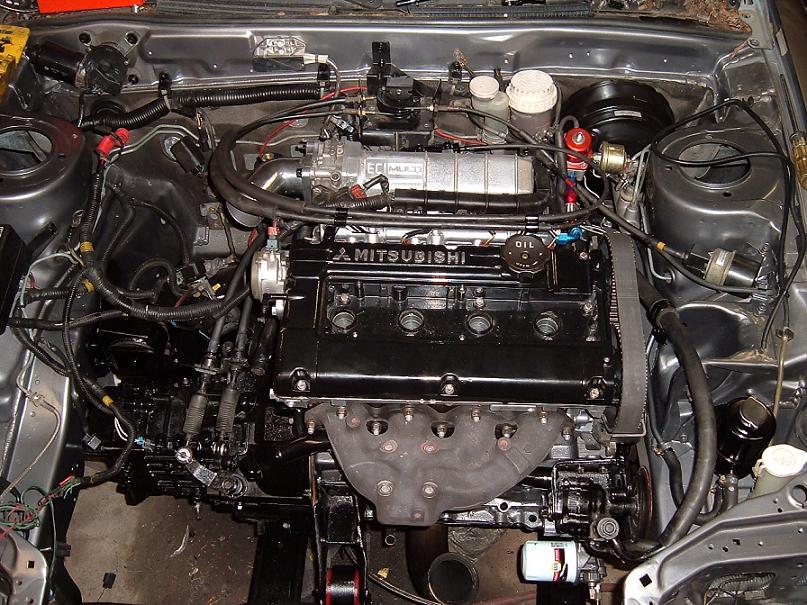

A few more pics...

Looks sweet man. Everything looks nice and clean. But I would like to mention that I love your fmic. Kinda reminds me of mine
Old 08-19-2005   #7
Re: My progress...Part Deux!
Is yours 4" thick Brandon? The core on mine is 12"x24"x4". I am trying it out for a possible kit in the future. We'll see how it holds up!
Old 08-19-2005   #8
mine is 12x24x3 with 3" inlet/outlets. But I have reducers on there because I'm not anywhere near a point where I'd need 3' piping, so I just have 3 - 2.5 reducer couplers on there.

Well, I am taking care of some things that I didn't like about my setup, so it is taking a lot of time. I won't have the new FMIC on there, but I should have the car running and at the cookout with the old one on. The engine still isn't in yet, so it will be a long night!

Well, I guess I needed some more luck. I didn't get the car going in time for the Cookout, as I had hoped. I am about 4 hours away from finishing it! The engine is in, just need the T-case, radiator, FMIC and turbo put on it. It will fire up this week.
As of 9pm tonight!!
