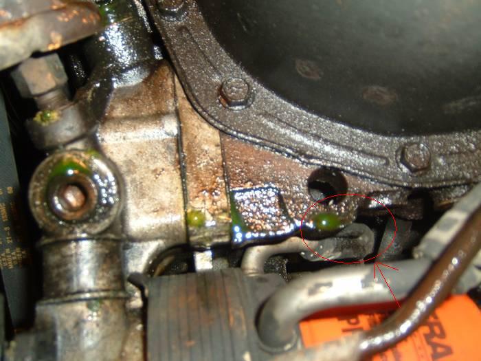

Identify the coolant leak
Please help me, My car is leaking coolant from the drivers side of the engine
Please help I want to drive my car

No more info needed, (obviously a Mitsu from the pic) in that area where the last pic is, there are several possibilites. The water pump is straight up from there so as well as the lines for the oil cooler. The water pipe has an O ring where it goes into the waterpump right above that area as well. You might want to feel the bottom of the water pump and see if it is leaking there, from the pic it looks like it is on both sides of the oil filter housing which would make me thing the pump is the problem.

We had a problem with Terina's car there too. It was a small pinhole in one of hoses going to the oil cooler. It was very hard to find but the hose had become softer from all the oil leaking down onto it.

If you look at the last pic you can actually see the crack in the upper hose going to the oil cooler. In the pic, it is just below the hole in the block. Looks like about a 1" crack in the hose. That is the same *$&%! hose that killed the engine in my red car. $.40 hose ruined a head and block.

Yeah, that what it looks like to me. Especially seeing as how those two hoses just love to get oil soaked, swell, then burst. Happened to me too, luckily I was able to shut down and fix it.

Wow you guy are awsome. I didn't really get any help on DsmTuners.
Anyway the car is a gsx 7 bolt engine.
Could someone edit the pic so I know what hose you guys are talking about.?
Also what size and legnth should I get?
BTW Fram whats wrong with Fram. J/k What do you run on your cars?

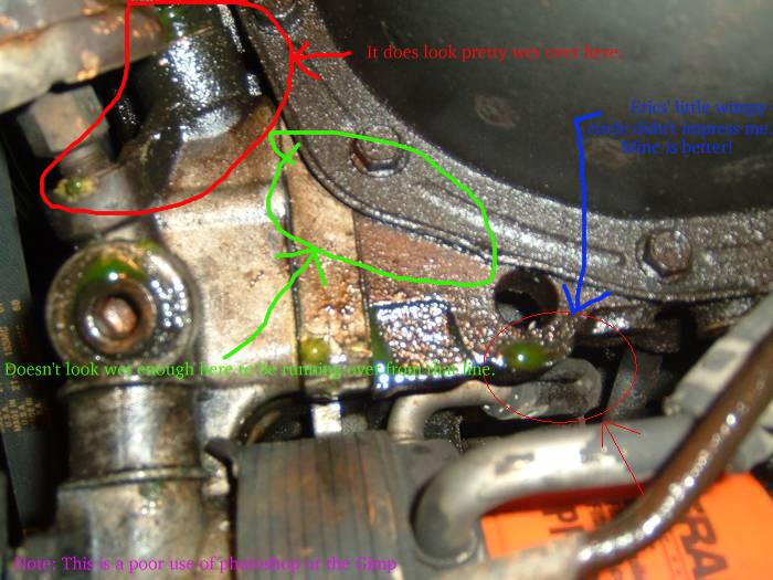

Here

Also if you walk into Napa they will be able to get you the exact diameter and length hose you will need, their lookup system is amazing. Just tell them it is the hose that goes from oil cooler to water pipe and back.

I considered that hose as well due to the fact it LOOKS cracked, but it may not be the leak. Look at the top of the pic at the opposite side of the filter housing and you see it looks pretty wet as well with coolant which would point ot it coming from above the housing. Both could be bad as well, I wouldn't stop at the line though. Check both.

Remember though, when the fan kicks in, it will blow antifreeze all over the under side.
It is the place to start. Fix that hose and see if there are any other leaks.

Refer to the green circle bitch.

I am not privleged enough to look at the pics you are editing, But I know what you are talking about.
My first step will be to replace that hose because it does lok pretty bad, then if thats not it I will look at the water pump I guess.
