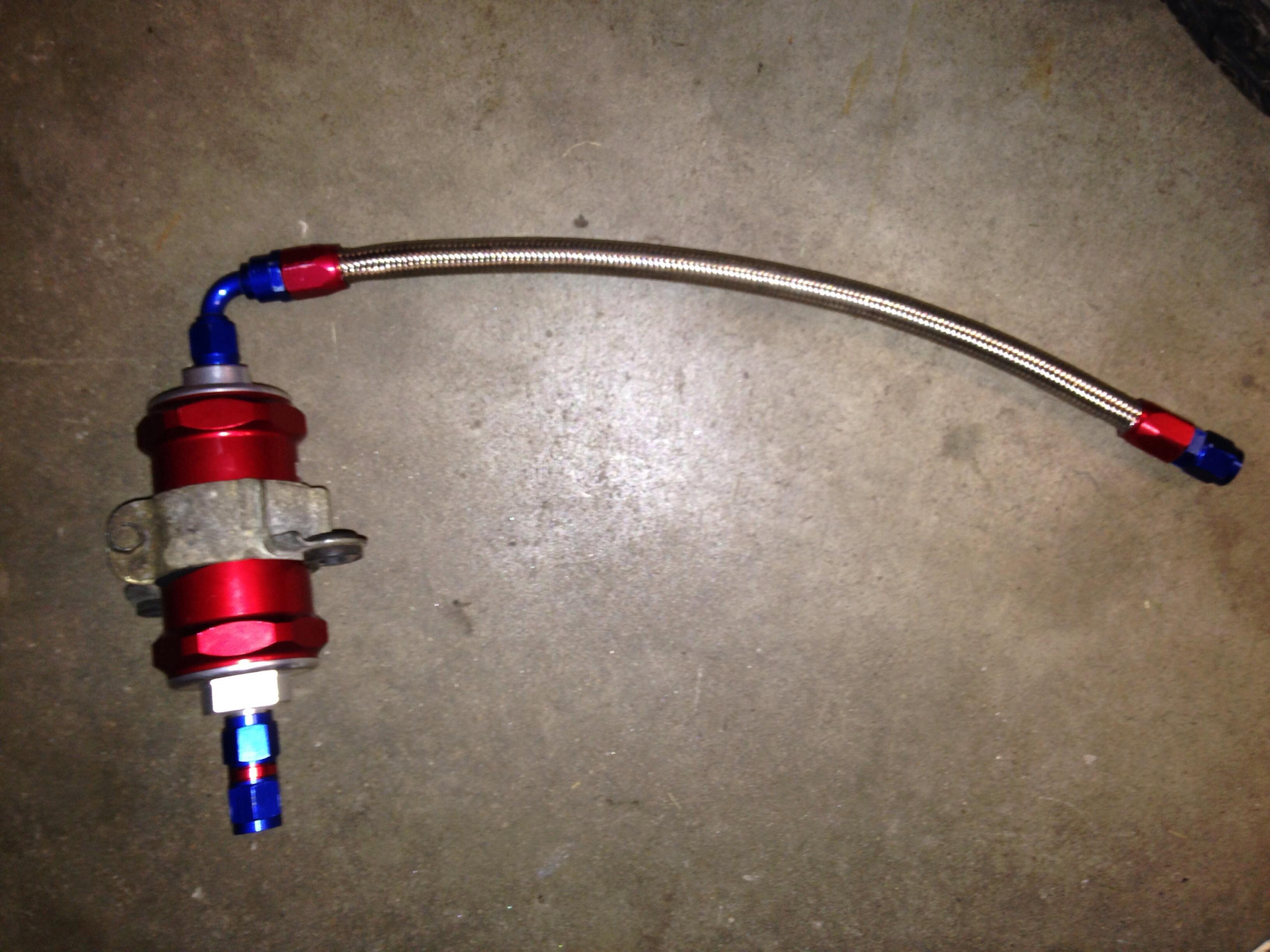

Thought about doing that. I even went to db and got the fittings, but didn't want to mess with the factory pump o-ring piece thats on the other side so instead I ended up cutting one of the male -an's off drilled it out to match the line diameter and welded it onto the line. I'm hoping it will not leak. Last night I f'd up the hardline under the car trying to drill that out so my next question is, will it leak if I just put the hose over the line and clamp it down? It's the feed hose right after the pump.

Old 07-26-2014   #10
Re: WTB: 2g Awd Gas Tank
Yes it will leak. The the line on the car is bad you will have to buy a tank to engine an links kit.
Old 07-27-2014   #11
mark4g63t
mark4g63t's Avatar
Join Date: Jun 2012
Location: Twin Cities
Drives: 95 Talon TSI
Posts: 941
Anyone have a tank to filter line with a male -an fitting?
or
A fitting for the fuel rail -6 AN (For the inlet, not sure if it matters)http://www.streettunedmotorsports.co...l_fittings.htm
Going to be putting this in with it.
