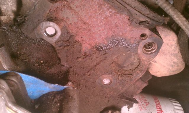

So 3 bolts broke on my truck for the A/c and p/s bracket. I tried to drill it out and use a easy out but i was getting no where. Is anyone good with this and wanna help a buddy out?

very much so. Gonna go find some cobalt drill bits this week.

use cutting oil, don't run the drill too fast in order to keep the bit as cool as possible. Perhaps use left hand drill bits... thought I question the helpfulness of them. Take time to center punch and start with a small bit, work your way up, in order to keep the hole as centered as possible. Get ready to cuss a lot.

Yea I have removed so many damn bolts and screws but for some reason this is turely kicking my ass. Did a center punch but its at such a dumb angle... Lets just say i made it hard on my self. ha.
