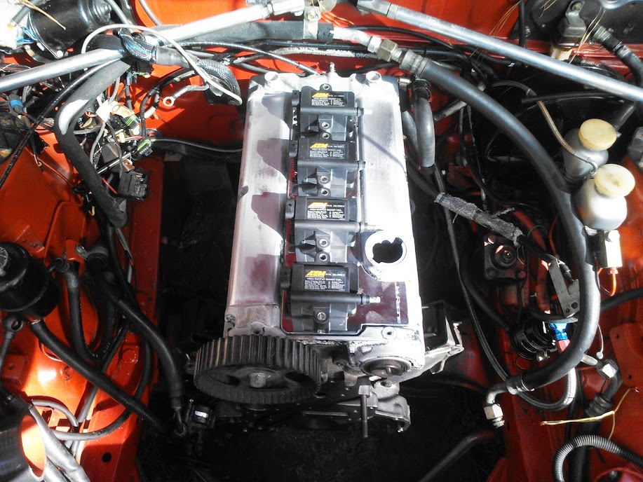

Did some coil mock ups the other day, think Im going to mount them like this.
Motor Is Tight, Sounds Unbelievably Badass, Intimidates Slow Hondas Instantly
