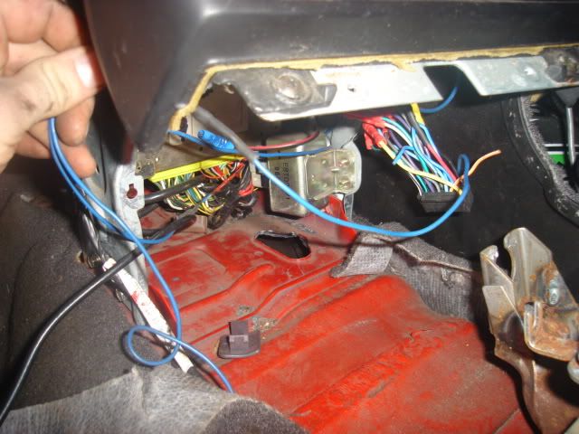

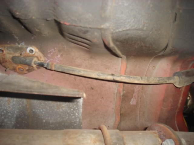

Here's whats done so far
Auto Brake pedal installed.
Auto shifer installed.
I had to cut a hole through the floor boards to run the cable.

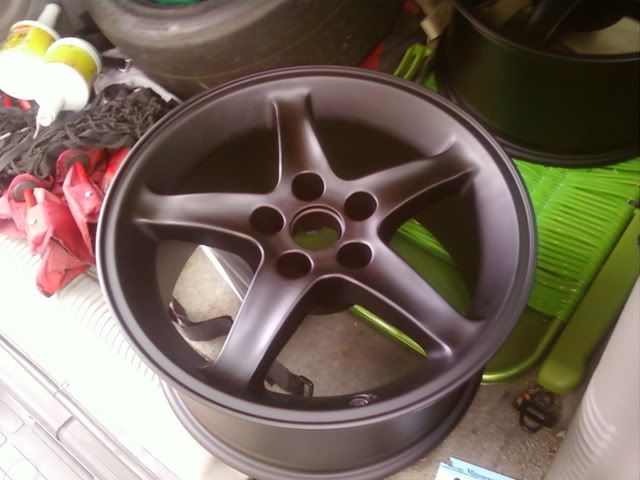

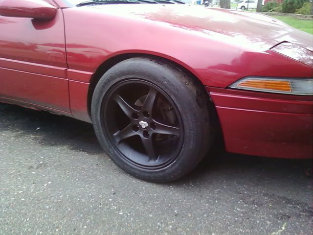

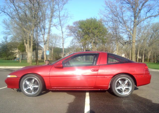

Carl, get some pics up of the shell. I want to see what it looks like with the new wheels.
Heres what I have of the shell I only have a few camera phone pics since the wheels were powdercoated.
Cobra R's Powdercoated satin black Thanks to Premo Performance
A few when the wheels were still chrome
My favorite pic of my car in action at BIR

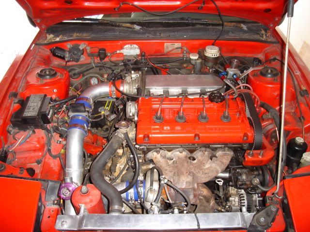

you might have to mod your intercooler pipe that goes from the fmic to your intake with the auto trans by the fact that is bigger i had to have my piping custom made

Carl you will need to put a bigger cooler on that list and I would recommend a temp gauge.
Ovaboost is right, I was looking at GH's IC piping and realized it would hit the solenoids for the AT trans if i was to use it.

Yea definitly getting a bigger cooler and temp gauge Just forgot to put them on the list. Hopefully my IC piping will clear but if it needs to modifyed it wount be a problem. Heres a pic of what Im runnign now let me know if you think it will clear.

it looks good, but I'd need a pic from the side between teh trans and piping to tell, I should just take a drive up.

any time you want to come bring those parts or lend a hand. It'll be hard to tell clearance right now with no trans in the car
