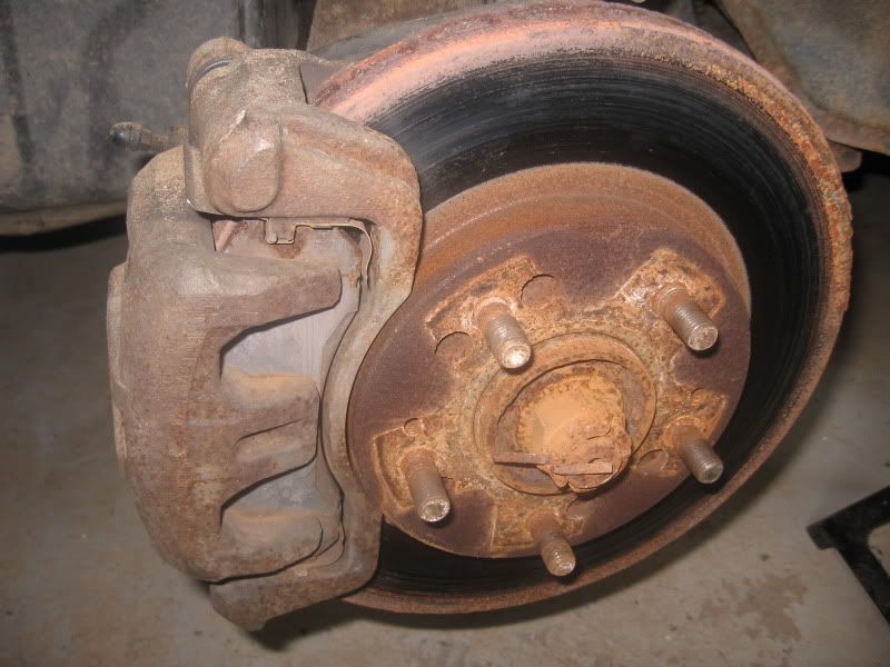

Went to take the brakes apart because I'm pretty sure that my driver's side caliper is froze up. Of course the freaking bolts are seized to shit. Such a pain in the ass. Rest of the components look pretty good.

looks like a nice car. I'd pull the plugs and look at them for an idea of how rich it is. Boost leak test, etc. But i'm guessing the real issue was the dragging brakes, that'll reduce fuel economy pretty quick.

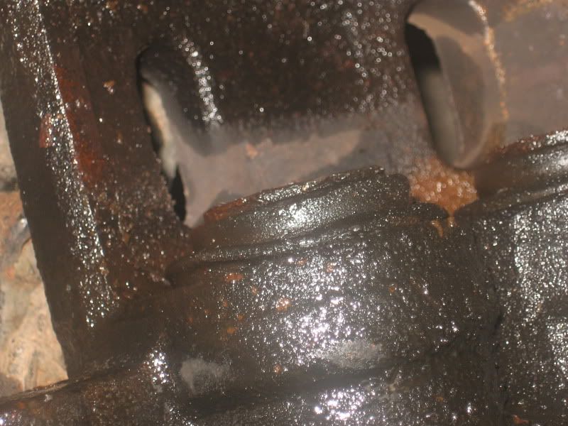

Well. I've made progress... Or at least I think I have.
Dug through my tools and found that I have a 18" breaker bar. But it was a 1/2" drive and most of my sockets are 3/8". So I went and picked up an adapter, some liquid wrenches and came back home.
Ahhh RUSTY!
I was able to remove the bolts...
but also pulled this off in the process
Nice... So the rest of the bolts came off with a little work, but relatively easy. Now I'm left with a rotor that is seized to the freaking hub. Gonna try the bolt through the back trick later this evening or tomorrow. Any other suggestions?
Also found that the caliper is DEFINATELY stuck. One of the piston seals is shot and doesn't move. The other doesn't retract. The back side pad was down to almost nothing.
Anyways... progress was made!

If you don't care about the rotors, use a sledge hammer. You my want to buy some 14, 17, 19, 21mm half inch sockets for the future.

No other suggestions than the bolt / nut trick need to be made.
I've pulled apart a bearing doing it. It'll work, just maybe not how you expected.

Yeah, I'm half thinking that I shoudl just leave the rotors. Other than the rust, they aren't worn that bad... But now that I have everything apart... I may as well just do it right? No sense in revisiting this a year from now.
