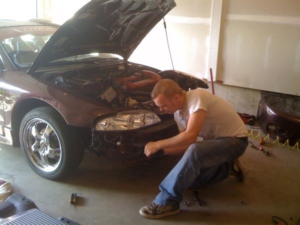

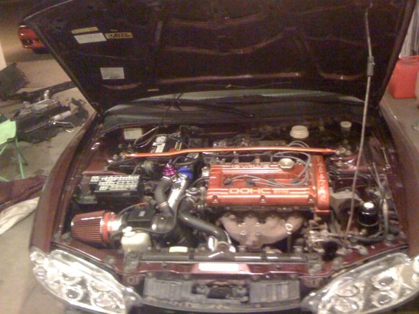

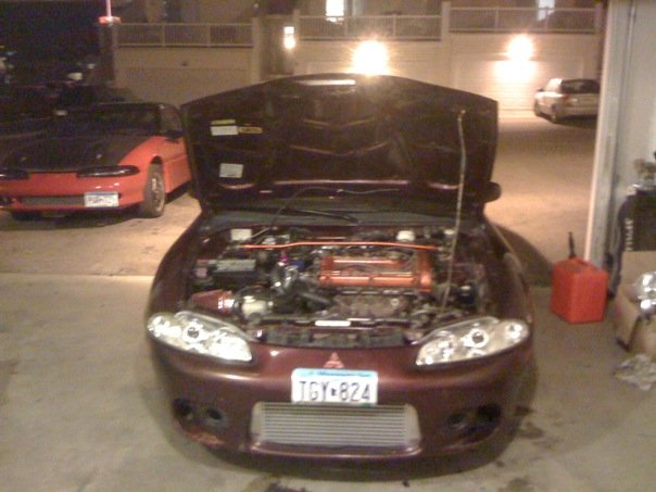

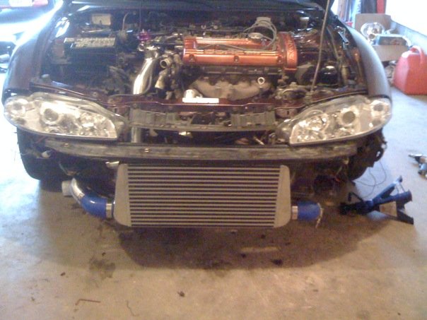

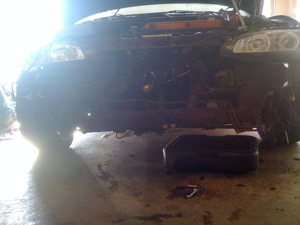

Well the day finally came for twack and i to install a fmic on my gsx. it went pretty smooth except for a couple hickups thanks to me. kit turned out beautiful and the bov is very unique sounding. here are some pics i took. im sure twack will add some. thanks again twack for all your help.

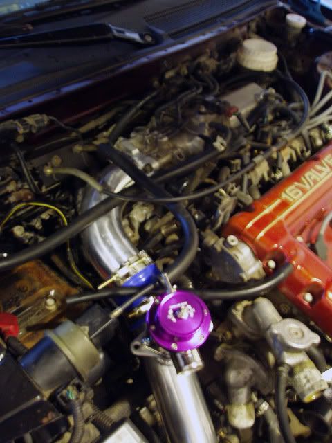

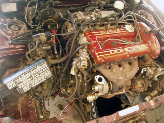

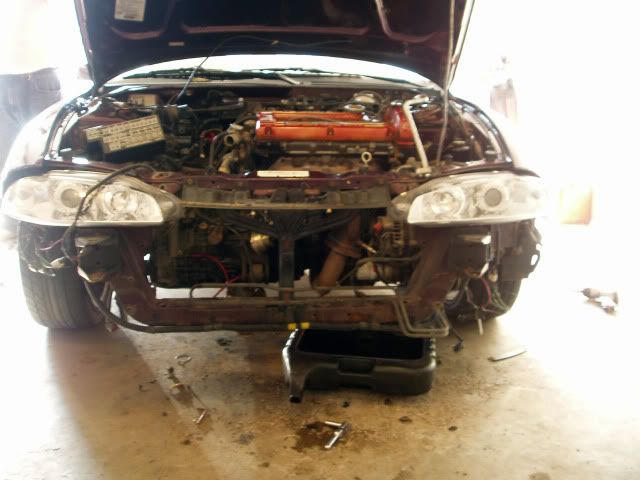

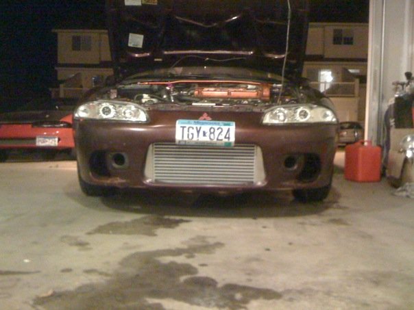

My 2cents on the kit: It was the one of the cheapest kits on ebay that wasnt a universal. It came with all needed hardware to install including Jpipe, aftermarket throttlebody elbow, bov pipe, and a pretapped nibble pipe for a boost/vacuum source. The kit says that it requires cutting of the pipes but we found that untrue. Once we figured out where each pipe went we didnt need to cut any of them. All the pipes were beaded on the ends so that a huge plus in my book. We had 45* pipe left, 2 couplers, and a bunch of t bolt clamps, left over. from the looks of it those extra pipes are there in case you have a t25 or t28 and the kit still bolts up to those. So im impressed that the people puting the kit together covered all there bases and included everything in the kit. Anoter nice thing is it came with a free BOV. Its a knock of so its only temporary, but its nice because when you get rid of the stock piping on a 2g you dont have a bov to use so this will hold you over till you can buy one. I took a jigsaw and cut the crashbeam so it was just the top piece and mounted the intercooler straight to that. It allowed everything to install securely, easy, and even. I thought the kit was very well made and put together. Very convenient because it had exactly everything you needed gaskets included. two thumbs up in my book.

Nice work cutting the bumper too. Why did you remove the radiator to install the fmic though? Or did you do that because you drilled into it?
pics or gtfo
Old 09-17-2009   #10
twack
It was a auto get over it
twack's Avatar
Location: rochester mn
Posts: 1,987
Re: fmic install on 2g gsx
well when he drilled into it, there really was no choice so it was pulled. before this install there was rips in piping and so many leaks and problems this was great matinence. i did boost leak test it but i think the wastegate might need replacing cause i think its leaking
