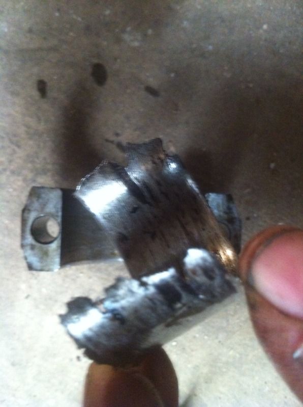

I spun a rod bearing in my 1992 Galant VR-4 a while ago, and after staring at it sitting in the driveway all summer, its about time to put it back together.

And here's what killed the Galant.
