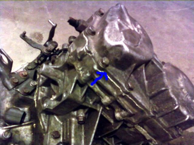

Pull the 14mm bolts that hold the endcase.
With all the bots removed separate the endcase at the very top. It has a seal so it will need a little work to separate it.
