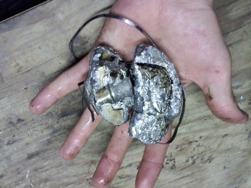

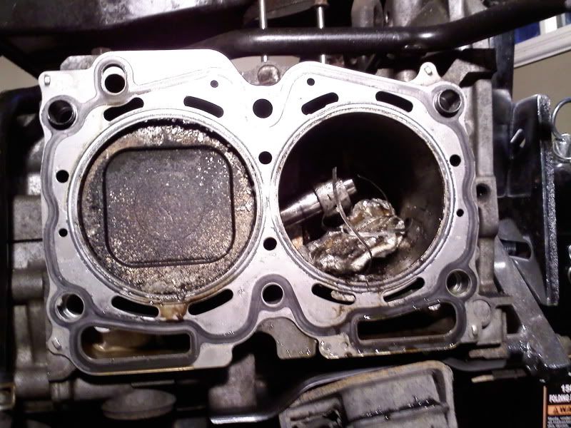

I know I made a thread a while ago about how my 2.5rs blew up on my way to Devil's lake, but I honestly can't find it for the life of me. Anyways, I finally took the heads off the block and this is what I found.

The sad thing is, I still don't know for sure why it happened. I'm pretty sure that when the guy who sold me the car (a mechanic) replaced the head gaskets and timing belt, he never got the heads machined which caused coolant to seep in with the oil and cause the motor to lock up. What I don't really understand is why it was mainly just the one cylinder that blew up.

That kind of damage has nothing to do with coolant in your oil from any kind of head gasket leak.

so...what do you think could cause it?

Detonation. Running lean under boost or too advanced of timing. You should have heard some massive pinging with damage like that.

No boost, and the timing belt was done roughly 5000 miles or so before this happened. I didn't hear a thing when this happened. If I recall, we were listening to music, but I don't have any bumpin system in my rs. The car just suddenly studdered and died as soon as I put it into neutral.

Hmm, then are you sure the timing marks were lined up properly?

I've seen a few of Subbie's where one of the cam gear dowel pins broke (belt/gear spins but cam doesn't)
