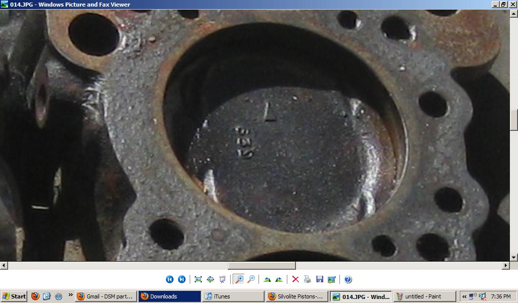

Sorry for the Low resolution, someone is trying to sell me a stock 6-bolt, looking at the pictures, i see a problem:
63D - 1G non-turbo
63T - 1G Turbo
63dT - 2G turbo
Am I correct in assuming that this picture is of a NT engine?

Its a n.a.

its a n.a.
+1

+2 heres some pics i found on talk of a 6 bolt turbo bottom end, http://www.dsmtalk.com/forums/showpo...23&postcount=7

well looking at the other thread pics, that should be a 7bolt according to the chart the OP posted, unless its the 1g rods with the 2g pistons...
to the OP, roll the engine over and pop the oil pan off, look for the oil squirters in the bottom of the cylinder. that would make it a turbo block from what I understand.
Or order a set of 1g turbo pistons and rings and slide them into that NA block....

+3 if it really matters at this point. has to be 9:1...
Buy the block and just put some turbo rod and pistons in the beotch
