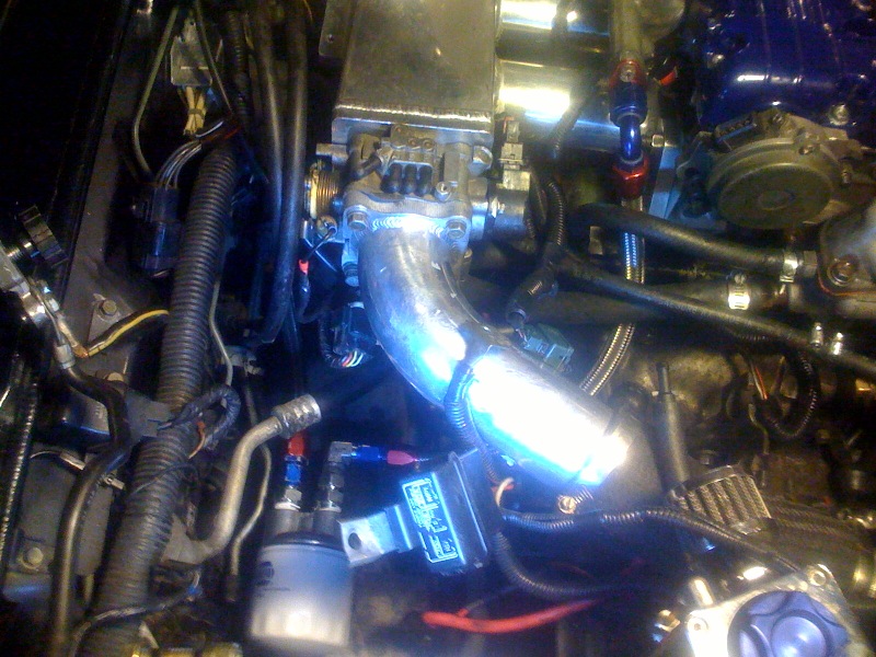

The 91-99 oil cooler setup: Some like it, some do not.
The 90 oil cooler setup: Pretty awesome, however I have found that for the same cost, you can run a 3rd party setup which is better, with a remote oil filter, allowing for larger filters, bigger less restrictive exhaust, and makes oil changes much easier.
The picture I have included is a FUEL FILTER setup, however I have used this for oil filter setups also, this will require taking an oil filter housing, cutting it in half, and welding on some aluminum AN fittings.
Food for thought.

Iceminion, interesting...Not really what I am getting after though.
I already have everything to do the '90 OFH so that is the plan. More than anything I was just wondering if it is feasible to put an addition filter in between the OFH and the oil cooler. Like the Earls in line filters, I did notice after posting this thread though that it says they are a pre-filter and filter to 140 microns.
http://www.dsmtuners.com/forums/arti...r-install.html
This is the setup I followed, except my oil cooler is twice as long as the one in the write up. And the only reason I changed that was because Summit sent me the wrong size AN fittings on my first one, I sent it back, they in turn sent it back to me saying it was the right fittings when they were not. The one with the fittings I needed was back ordered until April so I just went with a bigger cooler. Which that cooler I thought was too damn small anyway.
I probably will just leave it alone and not put an inline filter in there just because it does pose too much uncertainty, but it was just something I had been thinking about and figured I would see if anybody could sway me one way or the other.
