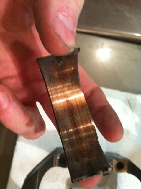

Picked up an auto '98 Eclipse this afternoon.
It apparently has a spun rod bearing. Upon tearing it down in the next couple days I hope to decide what exactly I want to do with this car. It's not perfect but is a lot cleaner than my '95 and the plan is to make it a solid daily driver.

Finished pulling the motor yesterday afternoon, despite having the pull the whole passenger side hub because of a stuck axle. Hopeful to have some not so carnage pictures later today.

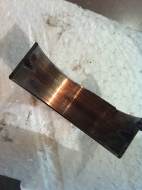

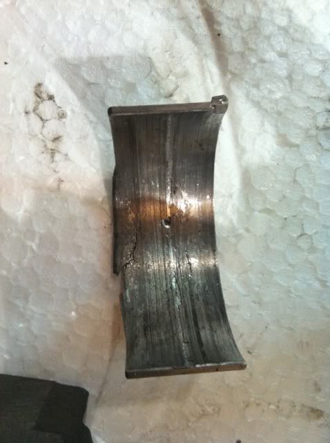

Re: '98 Eclipse GSX
grab a set of oem bearings and plastigauge it after you take some emery cloth to the crank to remove any garbage, if theres no gouges in the crank that catch your fingernail and the plastigauge shows its within spec, id see no problem in re using any of that, i ran mine very little just to move it up to the garage after i lost oil pressure and the bearing was destroyed, seems like he may have caught it early enough.

Re: '98 Eclipse GSX
I think I'll try that and see if everything is in spec. I just remember reading that replacing a messed up bearing without really know why it went bad isn't the best idea. This is also going to be my daily driver once its up and running so I'd hate to have another rod bearing go out in a month or two and not have a way to get to work.
I didn't look at the mains. You guys think I should?
Old 11-02-2010   #11

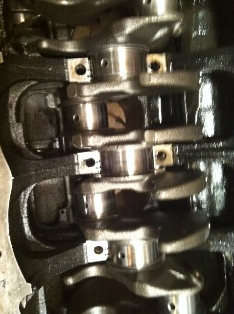

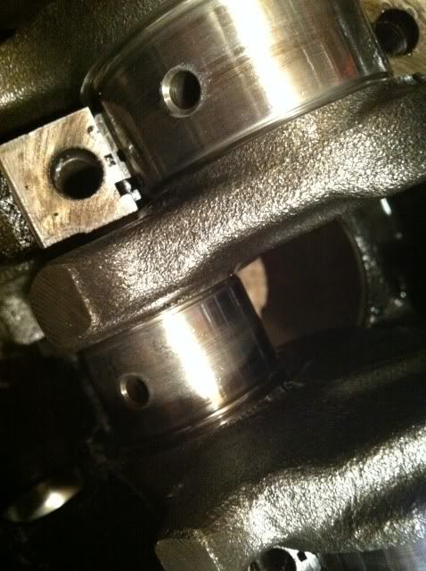

Re: '98 Eclipse GSX
From the pics, I don't think the #4 journal is saveable.

Re: '98 Eclipse GSX
Looking at it a bit more I wont be able to throw some new bearings at it. I can feel lines on the crank with my fingernail.
I think I'll just look for a cheap manual tranny/transfer case and throw in the 6 bolt from my 95 or rebuilt the stock 6 bolt I have in my shed and jsut rock it like that.

A little update.
Tore apart the rest of the motor last night and every rod bearing was spun and almost all of the mains looked pretty rough. I'm just going to ditch this motor and then probably pick up another 7 bolt and just get this thing back on the road asap.

Looks like the bearings in the 1G I picked up. I'im going to put it back together and sell it as-is, I don't feel like replacing the short block, too many projects right now.
