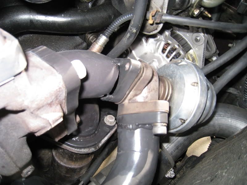

I have the FPred on the black cherry. It's running the exact same times for 15psi as it is for 25 psi.
I'm thinking possibly a boost leak. But looking for other ideas.
Ran 13.6 all night long didn't matter the psi. Even bumped it up to almost 30 and ran the same.

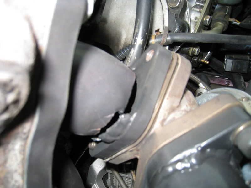

For the last pass, the weld around the flange to the WG cracked, so there's an exhaust leak, but even with that, it still made a 13.7 pass. Going to get that re-welded of course. I'm thinking that has a huge factor, but before that it was doing the same thing with no exhaust leaks.
I'm getting absolutely no knock. And it's running about 10.5 AFR.
Car feels good, til I get on the track, then it's just disappointing. I was getting 1.813 60's so it just seems like my numbers are way down, esp the mph. The best mph I could pull out of it was 109.8
Just looking to get ideas. I'm heading out to fix the WG and check out boost leaks. So if you have an idea, please let me know

Exhaust leak much??

Ouch, yeah that will definitely affect your spoolup time.

No AWD dyno around here and we had made it ourselves. The weld hadn't penetrated all the way, but it had broken off around the weld.

Do a boost leak test and go from there. Lean it out a bit, 10.5 AFR seems rather rich.

That WG flange wasn't welded all the way around, so it was leaking the whole time. You are going to have to grind off the powder coating (all of it near the weld) and reweld the pipe to the flange all the way around.
You also need to work on your shifting, I ran a 13.6 @ 99mph. My 60' was pretty similar, it was a mid 1.7. A boost leak test is definitely in order after you get that fixed.
It was welded all the way around, it was just welded on the inside.
It is now all welded back up and welded inside and out. Car runs good and pulls hard now.
