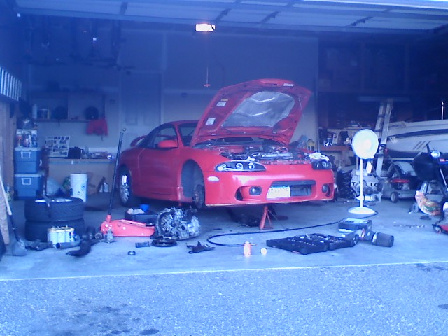

So my clutch has been slipping for about 2 weeks now and I knew it was going to have to happen sometime soon anyways, so I bought a new clutch and pp to put in. My rear main seal is leaking also so blageo and kevin both thought that that was actually the reason of the clutch problem.
Also, when my car would sit at idle it would make this chatter noise until I would push in the clutch then the noise would go away and it would get pretty annoying...plus my rear main seal was leaking so no matter what that tranny had to come out!
Blageo and I took the tranny out today and when everything was out after about 2 1/2 hours I found out that the clutch was actually really worn and the springs were loose, so we think that that was the issue with the chatter.
Once we were about to finish with taking the tranny out kevin (Sleepydsm) mike (mike55112) brandon (Greenhornet) and paul (HONDA) showed up and just bs'ed for a while before going out to eat..
So tomorrow the tranny goes to the shop and the clutch and rear main seal goes on the engine!! cant wait for this to get done and over with..

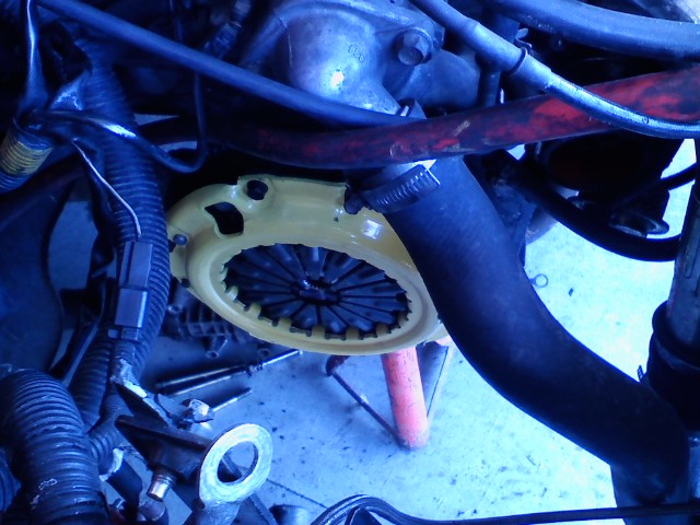

Clutch is finally in!!! and I went with syncromesh for the tranny fluid...
Also, forgot to mention when I took out the tranny I found out that I had a ACT light weight fly wheel!!! I was pretty excited for the lack of money that I was gonna have to throw at it

2100 in a gsx? I would have chosen a bit more aggressive clutch disc or pressure plate.
Nice car, good luck on the install.

Well it will do good for right now till I get a 6 bolt in there.... As for the 2100 I'm kinda scared about the crank walking so just to be safe, plus im not putting down enough power yet to really need anything more then that...
