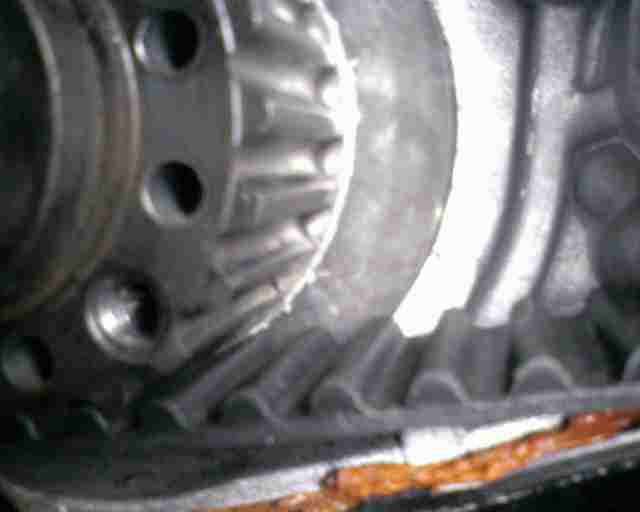

Old 12-09-2007   #5
Re: having N00b problems.....
Or, did you put that thin metal spacer between the timing belt and balance shaft belt gears (the one you use to align the crankshaft timing mark) on backwards your timing will be off, and the car won't start. Thanks to a friend, that happened to my old car, wouldn't rev past 3K and was all sputtery.

Posts: 956
As you can see from the cell phone picture (sorry for the blurryness) the timing/balance belt separator is indeed installed properly, please note the black crap that has built up over the years is only worn out where the timing belt has kept it polished clean.
And yes, even though it is not shown in this picture, the timing is done correctly.
swapped out ECUs, put 450cc's in and re-configured the GM MAF.
it kidna burped, but then no, nothing....
I pulled the spark plugs and added oil to simulate compression. Kinda added a little much to one cylinder
125 - 125 - 200 - 175
Still nothing....
building a 3000GT AWD Turbo.
