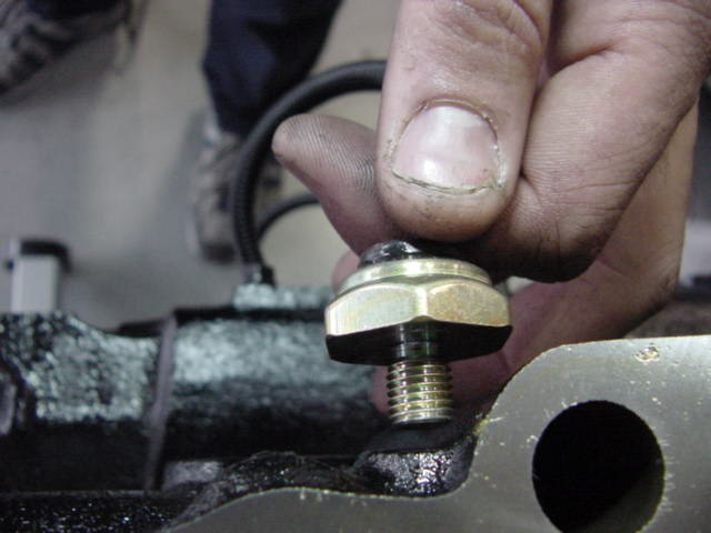

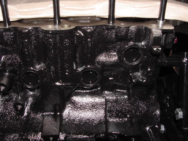

There is a problem that Marco is working on though. Marco guaranteed me that they would drill the boss for the knock sensor. Well they forgot to do it, so I figured I could do it with no problem, BUT there is a problem. There is no boss to be drilled on the rear side of the block. So Marco is trying to figure something out to fix this, not sure what that would be though. I'm trying to stay cool and calm about this with Magnus for now. If anybody has any ideas, let me know. As of now, the engine is rapped up in plastic waiting for this to be taken care of.

1ViciousGSX's Avatar
Posts: 5,382

A 2.4 I presume? If so the 6-bolt block that comes from doesn't have a boss on the number 2 cylinder like the two liters have. There's a boss closer to cylinder number one you could use, but I'm interested to hear what porn-star Marco comes up with.

There are some bosses on the front side of the block that could be used, but I'm concerned about heat damage to the sensor from the exhaust/manifold heat.
