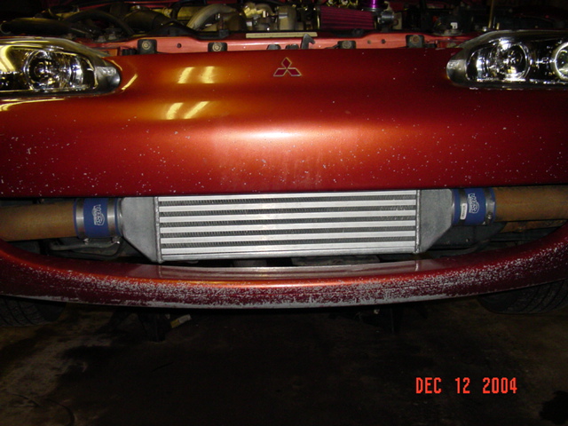

I ran a Johnnyracecar intercooler on my old RS-T. Dimensions were something like 20" x 8" x 2.5". It was bar and plate design. I expected the core to be good until 330hp without heatsoaking. I was only running 5lbs on e-manage and it ran for almost 2 weeks before getting slammed into, so I cannot comment further. I paid $100, since it was used. Yes, I know my "aluminized" piping is rusting. It's obvious it wasn't what was advertised and I should have at least put a coat of lacquer on it.
