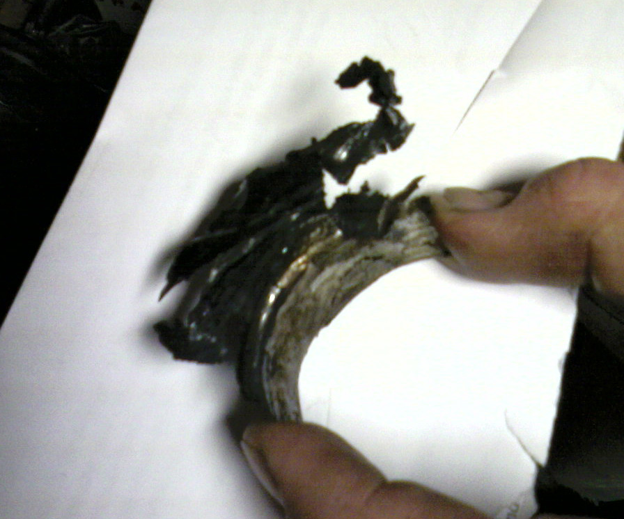

Heres a pic i took with my phone, I'm having a hard time uploading them all together so i have to go one by one.

There isn't really much point. The engine was definitely oil starved. The filter will be full of crap and the oil pump bearings will probably be in rough shape.

I'm guessing shit started to sieze, caused stress on the balance shaft belt and that's what caused it to snap.

I guess technically it is the rear balance shaft bearing, but drives the oil pump. If the engine seizes I could see it snapping the BS belt.
