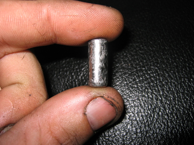

Can anyone tell me what this is?
Hey when i pulled off the tranny this part fell out, Im not sure what it is or where it goes. A couple ideas i thought it may have been was somewhere off of the clutch.
Please Help asap.

Looks kinda like the pin for the flywheel thats on the crank.

yeah i just looked at ACTs site and thats what it looks like.
What do these pins do? Would it cause my clutch to not fully disengage?

You sure thats not an alignment pin for the tranny to block?

The pin from tranny to block are hollow because a bolt goes through it. Its either the alignment for the clutch PP to flywheel or flywheel to crank.

First thing I thought of was it's the spider gear shaft in the differential, especially since it's all beat to hell.

I swear the spider gear shaft is WAY smaller then that. The problem you could be having is a non adjusted clutch pedal. Maybe get an extended slave cylinder rod(which I happen to be selling).

Looks like one of the dowel pins on the flywheel that lines up the pressure plate.

Do you really need the dowel pin in there? will it cause any problems nessesariy?

There could be a inner leak or something causing it to not have all the pressure. I was missing the pin on the crank and they told me not to worry about it.
