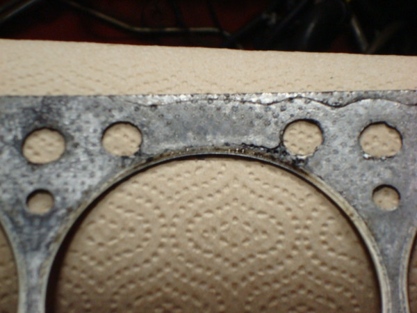

Took the head off today and found this stuff:

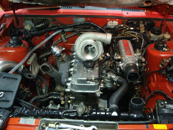

Maybe the turbo's too big. I blame it on the turbo.

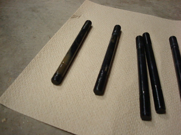

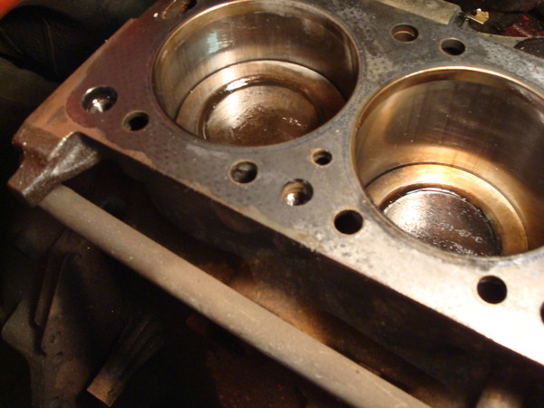

Milky coolant-oil mix on that stud that came out of the hole between 3 and 4. The block has little visible cracks from the stud hole to each coolant hole around it - the crack trifecta. The headgasket also failed, but I think it was because of the crack or whatever caused the crack.
I am happy to know what it is, and I'm thinking it wasn't completely my fault, the block could have been weak there and perhaps even with a good tune it would have done this.
The pistons look pretty good, no visible damage, I bet the block is just fubar'd. So now the big question: buy someone's good shortblock or buy and build a wideblock 2.4 with dsm head and all that garbage? either way would be SO simple, but damn it if it doesn't cost an arm and a let.

But here's what I am going to do now. I am going to find a block, have it checked for cracks, if it checks out good, I'm going to have it bored .030 over and slap my innards into the fresh block and whip it back together.
Any suggestions if I do it that way?

Maybe dont use a block thats been bored so much next time. Use a stock bore or maybe .010 over.

Thats on the large side. .010 is more common. The more material you leave the less your block integrity is compromised.
