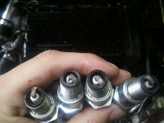

Well on my way home from work my car started to sound like a Subaru and lost all power. Pulled into a BP and it died and wouldn't start again. Got it towed home and pulled the plugs and #3 looked like sh*t.
It's greenish in color and looks like it has a tack weld on it/ melted electrode.
Coil pack tested good the primary ignition coil in the diagram tested at 1.01 ohms so it's a little high, says 0.77-0.95 ohms.

Old 08-15-2013   #4
Re: 3/4 cylinders
Did you do a compression test? You'll probably at least want to take the head off to inspect for additional damage.
Old 08-15-2013   #5
mark4g63t
mark4g63t's Avatar
Join Date: Jun 2012
Location: Twin Cities
Drives: 95 Talon TSI
Posts: 941
Re: 3/4 cylinders
Compression test tonight. #3 was the plug that was messed up but the misfire seemed to be coming from #1

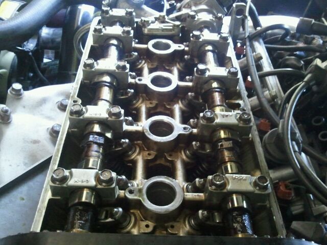

ID:	13917   Click image for larger version

Old 08-16-2013   #17
Re: 3/4 cylinders
Just take the head off.

Old 08-16-2013   #19
Re: 3/4 cylinders
+1.
Cylinder #3 has 0psi and a wierd looking spark plug, so something is obviously fucked up. I'd skip the bore scope and leak down test. The head pretty much has to come off at this point so just take it off and inspect for damage.
