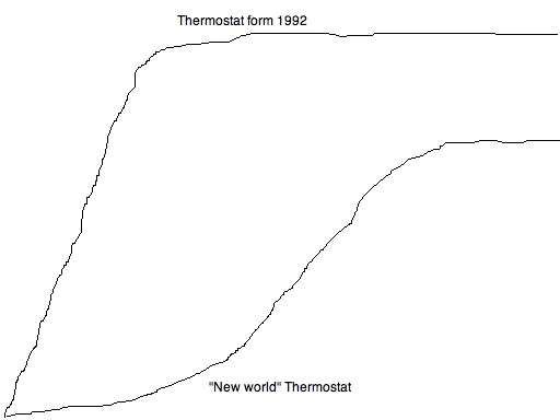

The data points I am hoping to collect:
Heat/Time graph of standard "new world" thermostats
Heat/Time graph of standard "old world" thermostats
Heat/Time graph of blocked off thermostat
Now, from what I am hearing the heat time graphs should be identical, but I have a sneaking suspicion that the blockoff plate will make the car heat up immediately, im not worried about hot spots because of the above mentioned turbo water bypass, also I have many engines and zero engine failures (of cars that I am allowed to maintain properly), so if I overheat/warp/crack a block I really don't care, this is SCIENCE.
Please if you have any insight into this talk to me, my household has a flock of import cars (toyota/honda/mitsu) they ALL take FOREVER to heat up, and they are all working fine with no leaks and new thermostats, I need to solve this because I want to drive to a friends house but I don't want to start driving my DSM because it takes a good 10 minutes for the car to become comfortable and its 4AM, too loud to let it warm up in the street.
Thank you for your thoughts/criticisms
attached is what I expect to find with further and well documented testing.

Soooo..... Have you maybe tried a 195* thermostat for your CRX HF, one that is 15* over OE recommendations? It won't get you the coveted 210* operating temp, but it should move that needle of yours a bit higher.
Also, where do you get the 210* optimal combustion temp?
Also, are you using fail-safe thermostats, or the ones that if they fail they fail in the closed position?
What brand are you using? Is it a quality brand? What is the ambient temperature of where you are driving? What is the ambient temperature of where you are letting your car idle? What is your radiators efficiency?
The questions can go on and on, but I assume the biggest difference here is the design of the thermostat as older ones will fail closed and blow up your car while new ones fail open and make your car cold.
If you ARE going to do this scientifically then you need to use the same car, same coolant mix, same ambient temperature, same humidity, same A/F ratio, etc.
Good luck.
