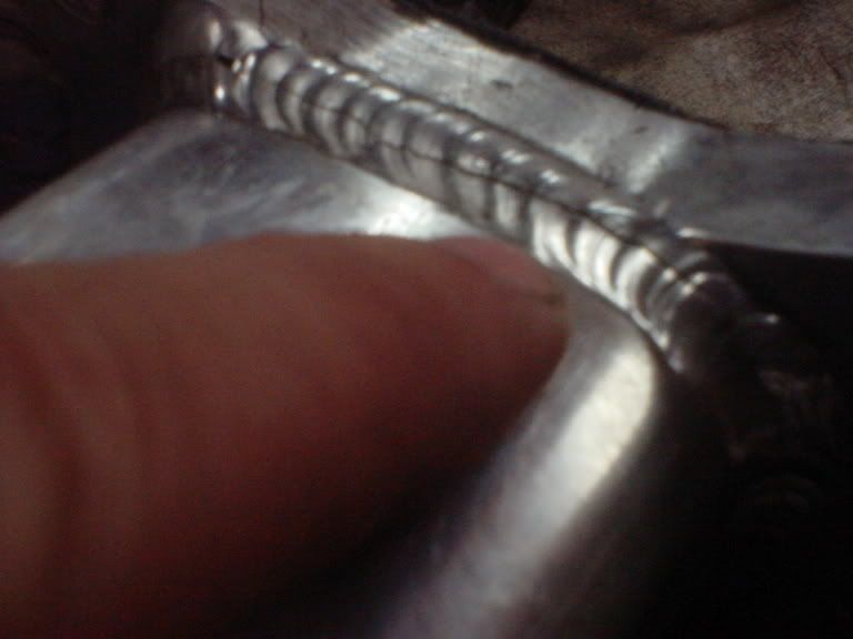

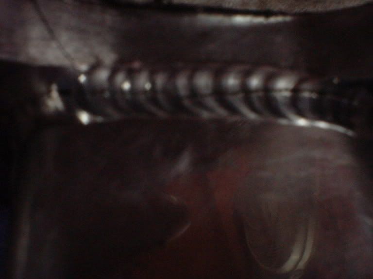

As I was taking everything apart I noticed the #4 cylinder runner on the intake manifold was cracked. The crack is all the way around the runner. I checked the how true the flange was when I put it on and it seemed just fine, maybe it was warped or maybe I warped it. Before I put it back on I had a buddy take it to his work and mill it flat. It was majorly warped so I have a feeling thats how it cracked. So I took it into Winona Weld and Sandblasting where they welded it up for me for $19, not a bad price at all and they did excellent tig work!
http://i8.photobucket.com/albums/a41...k/DSC00624.jpg
http://i8.photobucket.com/albums/a41...k/DSC00623.jpg
