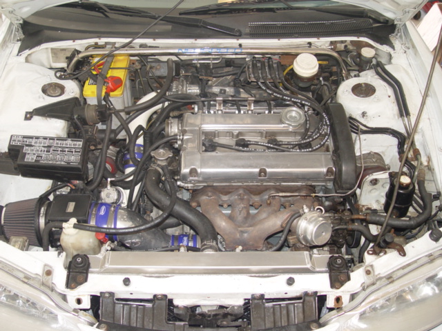

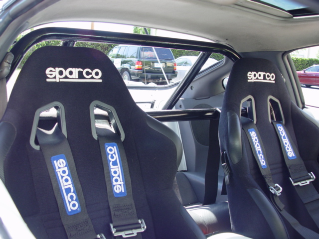

Here are some picts of the Motor along with the Cage painted.

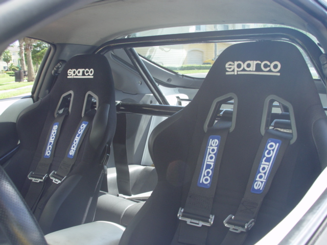

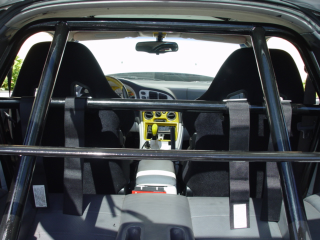

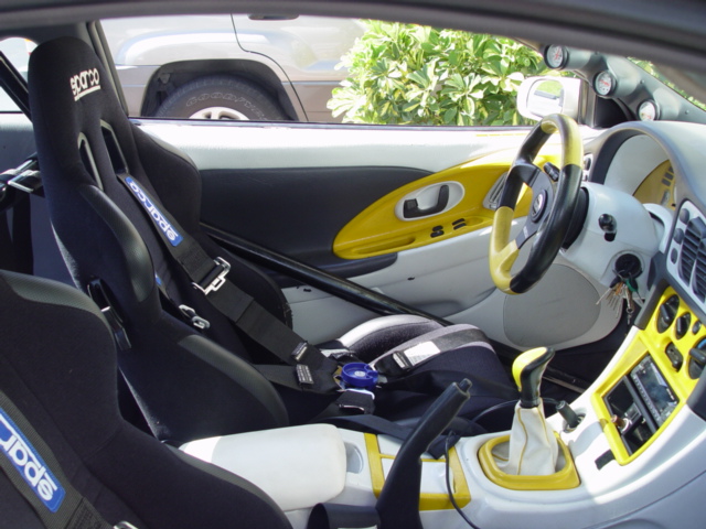

More pictures of the new Cage

That manifold looks familliar
7/25/09
Old 08-20-2005   #12
SlowWhite
Been there, done that.
SlowWhite's Avatar
Location: Camden, S.C.
Posts: 3,248
Re: Update on the Car progress - (joining Jet)
Which manifold? the T3/T4 turbonetics or the Magnus 1G SMI?

turbonetics. I have the same one.
