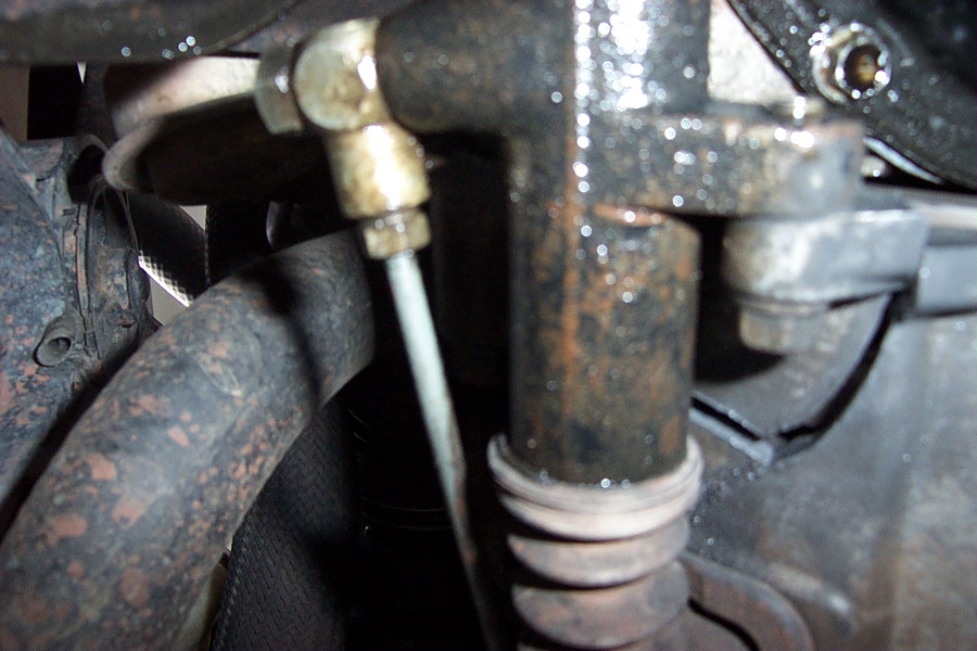

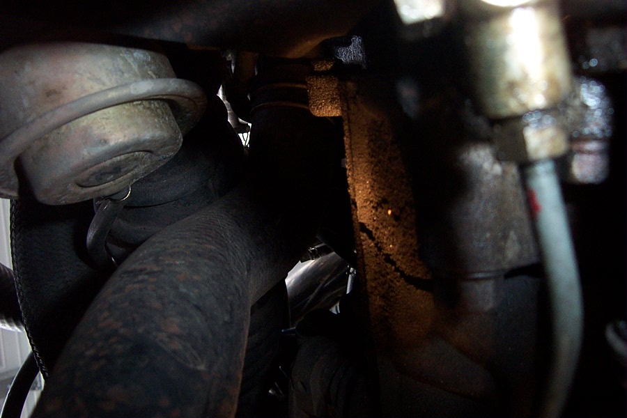

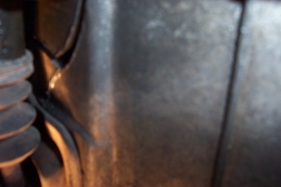

Well over the last two days my clutch didn't feel right. I would scratch or grind into gears from time to time. On my way home tonight I lost my clutch pedal all together.
Here's why! I know there is a recall on the transfer case...any chance this is something also? PLEASE!
The second picture shows the split going all the way up and around to the top of the bellhousing!

Time to find a new transmission housing or get that one welded back up.

I will try to find another tranny. Welding it would always have me fearing it happening again or the crack not stopping at the weld and continuing on.
So I take it no known issues with Eagle or Mitsubishi for a recall fight?

You can have that one welded. Next time put the dowel pins in your tranny!! Doh!!

The previous owner put the ACT 2100 in it. I am curious now to know if no dowels was the issue. Another friend of mine said the same thing! I am going to laugh at him (previous owner) if this is true...I will laugh when I knock him in the choppers for being an idiot!
Well this needs to wait to be fixed for the next couple of weeks anyway. I owe JET money for the FMIC and I think I am going to go with a performance tranny anyway.
Any suggestions from the veterans where to buy a BUILT tranny?

Spoke to John Shepard...$1695 for a Stage III build. He said it will easily handle my quest to 500whp.
I sent him pictures of my split and all he could say was..."ouch!"
Will be buying one of his cases as well!
