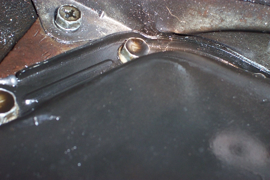

Hey folks...
I just dropped the oil pan on my 94 TSi about 2 weeks ago for an oil leak. After 2 weeks it has gotten progressively WORSE than what it was before! Is there any common issue of the oil pan cracking so small that you can't see it but leaks like a sive?
I have been working on cars since I was 8 years old (now 34) so I know what I am doing...but this thing is PISSING me off.
Another issue I noticed is the oil drain tube for the turbo mounting holes are through to the oil...I used Black RTV on the pan and some on the threads to "seal" the possible leaks. Should I be using something else besides RTV on the threads? The bolts are showing obvious signs of leaking...but the major leak is up along the pan towards the firewall.
Any insight would be greatly appreciated!
Thanks!
-Kenny

Re: Oil Pan Leak?
Well I did find a crack in the oil pan. The Black RTV actually seeped through and tried to seal it. It goes from the bolt hole all the way out to the bell housing area. I am going to price them tomorrow...or just have my buddy tig weld it and smooth it down. You can see the crack in the picture just to the right of the top center bolt of the oil pan.
I also found that the oil seal at the out-put shaft to the drivers side shaft was leaking good also. I thought I smelled Gear-oil also!
Anyway...I know what I am doing tomorrow!
