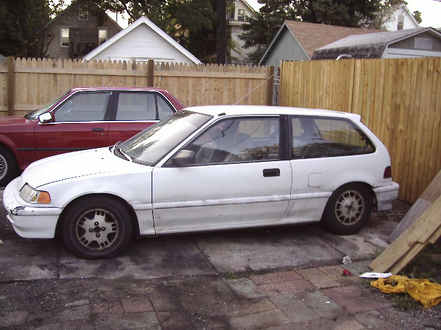

i got the car for 260$. car has new axels, clutch, and a starter. thing is it doesnt start, i think the fuel pump is out. anywas do any of you guys have honda fourms? no rust im suprised and i think i ricer owned it before, cuz ish low as piss.

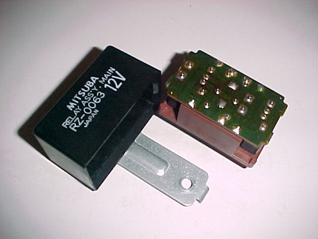

its the main relay. i tested it and all that and nothing on the reader thing. i went to go pick up a new one today.
i dont think im sellin it :P. i think i need a new intake pipe cuz some one chopped it and put a filter on it.
"I agree w/the main relay too. You can either re-solder everything and you'll be set or get a new one from honda, parts stores do not sell this part, they all carry "relays" but not the right one. "
oooooo so i bought the wrong one?

So where did you buy the main relay? You removed it from right above the hood release lever right? I'm just curious, I went to three different places and no one had it.
Austin
Old 09-29-2004   #19
SquackDiddy
Location: minneapolis, minnesota
Posts: 235
Send a message via AIM to SquackDiddy Send a message via MSN to SquackDiddy
autozone in brooklyn park. they said they didnt have it in but they ordered it. yeah i went to like 4 different stores. yeah i took it off and it looked like this..................not all disconnected though.

Well that'd be it, hope it starts for ya! :goodluck:
