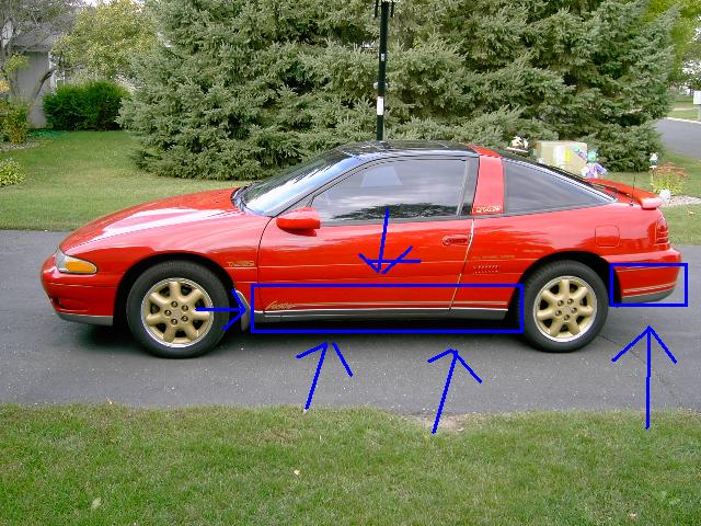

:grouphug: I am looking to remove the factory sticker that is on my Laser. It is the stock laser sticker that goes into pinstriping and Says "Laser" on the bottom of the door. Also possibly looking @ taking off the pinstriping. It looks kinda weathered, and was wondering the best way to get that off without screwing anything up!
Thanks All!!!!

a fingernail and patience.

A heat gun, or hairdrier and a soft peice of plastic or your fingernail works best after you heat it up.

get a drill and a 3m eraser wheel. takes pinstripes off in no time

heat gun, goo gone, fingernail, paper towel, and cleaner wax afterwards.
Worked for me.

you can get the 3m wheel at some automotive shops. It would be better to got to more of an auto body supply store. The wheel would be the easiest method of taking it off and it is hard to ruin the paint unless you are stupid. The othe rmethods work also though. Be careful if you decide to use the heat gun or hair dryer. It is the easiest way to ruin the paint.

The 3m wheel works well, unless the are painted pinstripes. Back in the day when I used to work at a sunroof and accecory place we used to do a diamond jeep edition for dealerships. Part of that was removing the painted on pinstrips. We would use adhesive remover (3m red can) and lots of time. Just wipe it back and forth repeditively untill its gone. Pushing harder won't make it go any faster. If it's s sticker get one of those plastic razors form a vinal shop and scrape them off with that and clean up the residue with the 3m red can.

We use the 3M eraser wheel at work. Works like a dream and only takes a few minutes tops to do a stripe down the side.

I third the eraser wheel. They work great. I have used one several times. Napa in St. Louis Park is where I got mine (I believe).
