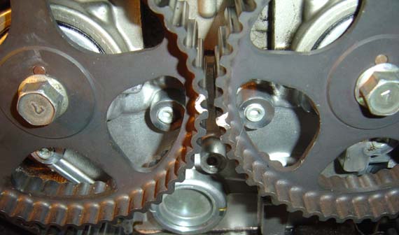

I have the car in my garage. I took the front apart and found that the timing is off like I expected. Here is a pic. Looks like the intake cam is behind. Would this cause the bad compression? The valves not sealing, thus loosing alot of compression? Do you think the valves are smashed or they are just not sealing the CC?

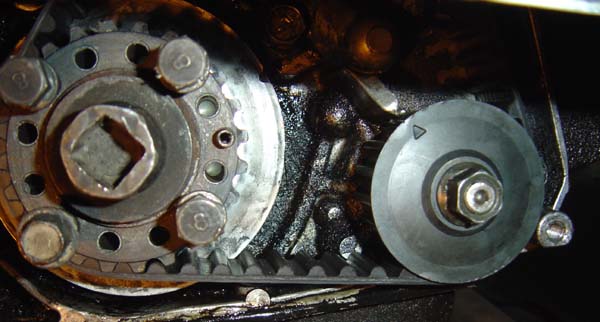

Here is a pic of the crankshaft and oil pump. To the best of my knowledge it is all ligned up on the bottom. Look right to you??? When I align the cam marks the crank and oil pump are each a tooth off (past their marks). Should I have the timing belt put on right or pull the head? Do you think the valves are gone? I guess I could throw in some ARP's and get rid of more crap if I pull the head. What do you think? Will it run if I just swap the belt on their right? Pic of aligned front case with pic above:
Thanks for the help, John.
Take the belt off and put it on the right way before you pull the head. If u pull the head and the valves are good your screwed for an easy fix and finding the problem. No way of knowing if its head problem or not w/o sending them to the machine shop.

Thanks, but if I pull the head, wont I be able to look at the pistons to see if they have been hit? I think I may just pull the head as it is easy to do with the belt off. Then I can fish out the AC compressor and get rid of the EGR stuff that should be gone. As far as removing AC, the belt is off it (previous owner). Still carrying along all the weight and all the EGR lines and canister are still in there with a EGR blockoff plate. Then I would have to decide if the beater needed head studs which I have laying here. And I wasn't going to mod it at all.....

I pulled the head, the valves hit. It appears only on the exhaust side though... That would cause the large drop in compression on the 34k rebuild right? The numbers were posed above.
