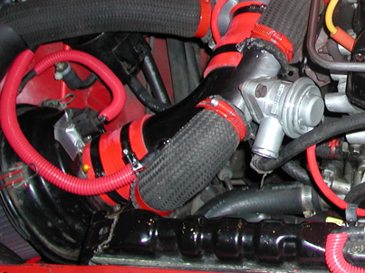

Ok so i am changing my 1G BOV to a BPV by routing it's outlet air back into the intake pipe (stainless steel). Anyhoo, the biggest inlet on the pipe is 1/2", while the 1g BOV outlet seems to be 1.25" or maybe just 1" (the lip is throwing stuff off). Point is, i want to get that air from BOV into intake. How?! No one seems to make flexible hose that big, and going from 1.25" to .5" is a kinda big jump. There would just be a huge ugly mess of crumpled hose on the intake side if i kept one size hose the whole way. Grrr, help me! I'm sure you guys know what to do, since they come from your damn cars in the first place.
PS: Im not spending more than a couple bucks, nor do i have acess to a saw, welder, or anything of that sort.

I posted this on my own forums also, and they came up with going to a muffler shop and having them weld a 1" inlet on my intake. They claimed it would be cheap, but im not so sure i want to pay someone to make a BPV. I mean, i would rather have a BPV then a crappy BOV, but still...
I'm assuming the return pipe is the pipe that comes off the 1g BOV into the intake on dsms?
Here is my set-up. The inlet that i'm trying to use currently sits about 3 inches RIGHT below the bov, but like i said it's only .5" big.
