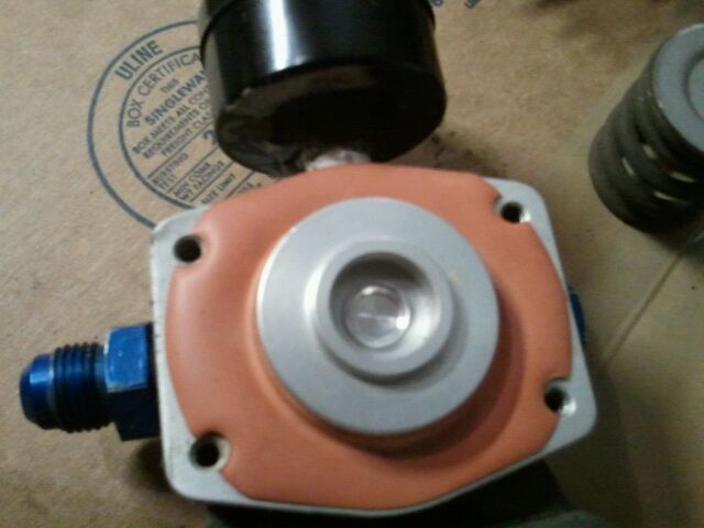

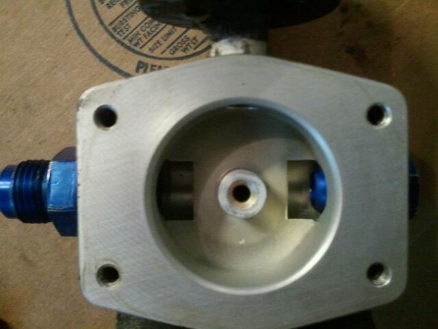

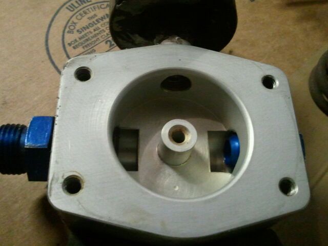

I can take pics but it looks perfect

Diaphragm

was not wet either on top of it when I took it apart
