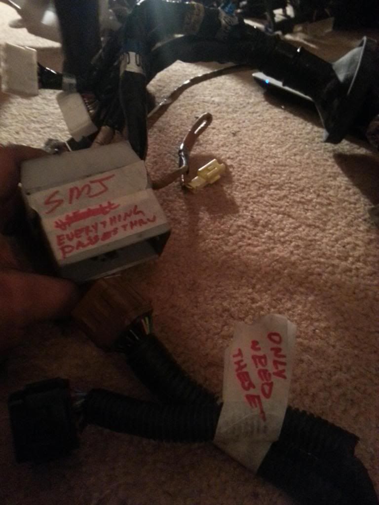

Now, for what’s going on below.
For me to be able to tune with Opensource I need to run a WRX ECU. What I have to do is remove the engine related wiring of the WRX harness and merge it with the rest of my Legacy harness. It sounds like a mess, and honestly it can be. But I don’t see why people refuse to try it. Once you isolate the different parts of the harness you need you remove everything else. The pictures vaguely show how I did it. They’re not very interesting, I know. I threw them up here as more of a central reference point for me down the road.
Complete '03 WRX bulkhead wiring harness
Everything through that grommet I need.
To transmission
Seperate SMJ from main loom
Seperated
Leave length
Complete front harness
SMJ was the only thing I needed off front harness
Complete bulkhead wiring harness/Other half of SMJ harness
Plastic shield removed (remember the 2 grounds)

Just more notes. Sorry guys, I've been working all day on this and am going to grab the VF37 setup in about an hour. I'll create a true project thread tonight...If I don't get distracted by more wiring.
-FPC harness okay. Solder in length.
Signal 1 (A13) LgR Signal 2 (C15) VW [Take off main harness. + to length]
Grounds from FPC?? + to length, check schematic, reference pinout sheet.
-TPS Signal 1 (B7) Lg (Fully closed 0.2-1.0/Fully open 4.2-4.7) + to length

I'm excited! I feel like things are coming together. Now that I'm waist deep, the wiring doesn't scare me anymore. I know I don't need to outsource the job.
Car will be very fun for a DD. Just need to get a better trans and rear diff.
I'll have some good stuff coming up later. Hopefully I can have the entire WRX harness done, and start tearing in to the Legacy harness tonight.
Freshly loomed wiring harness...Yummmm.
