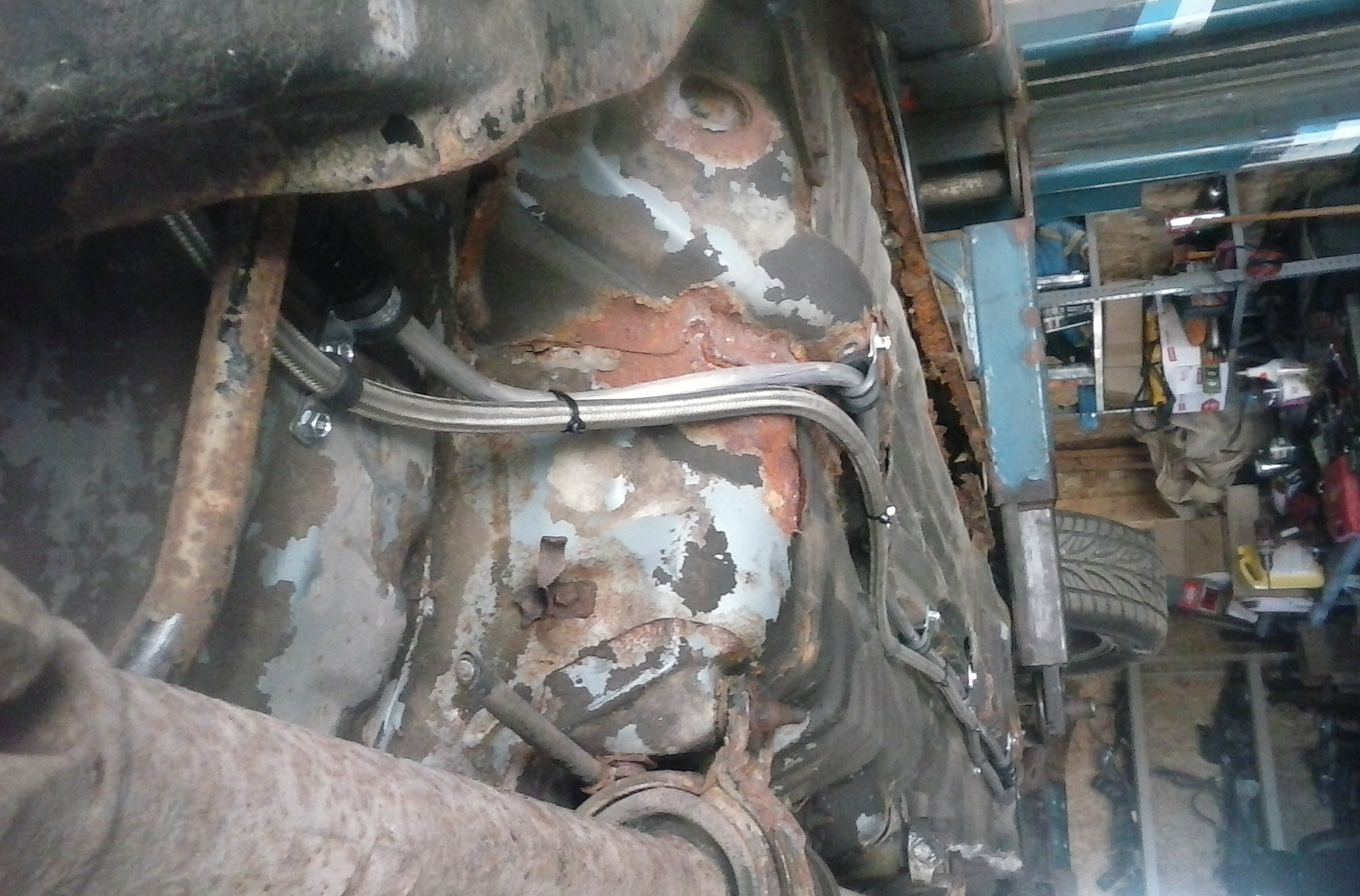

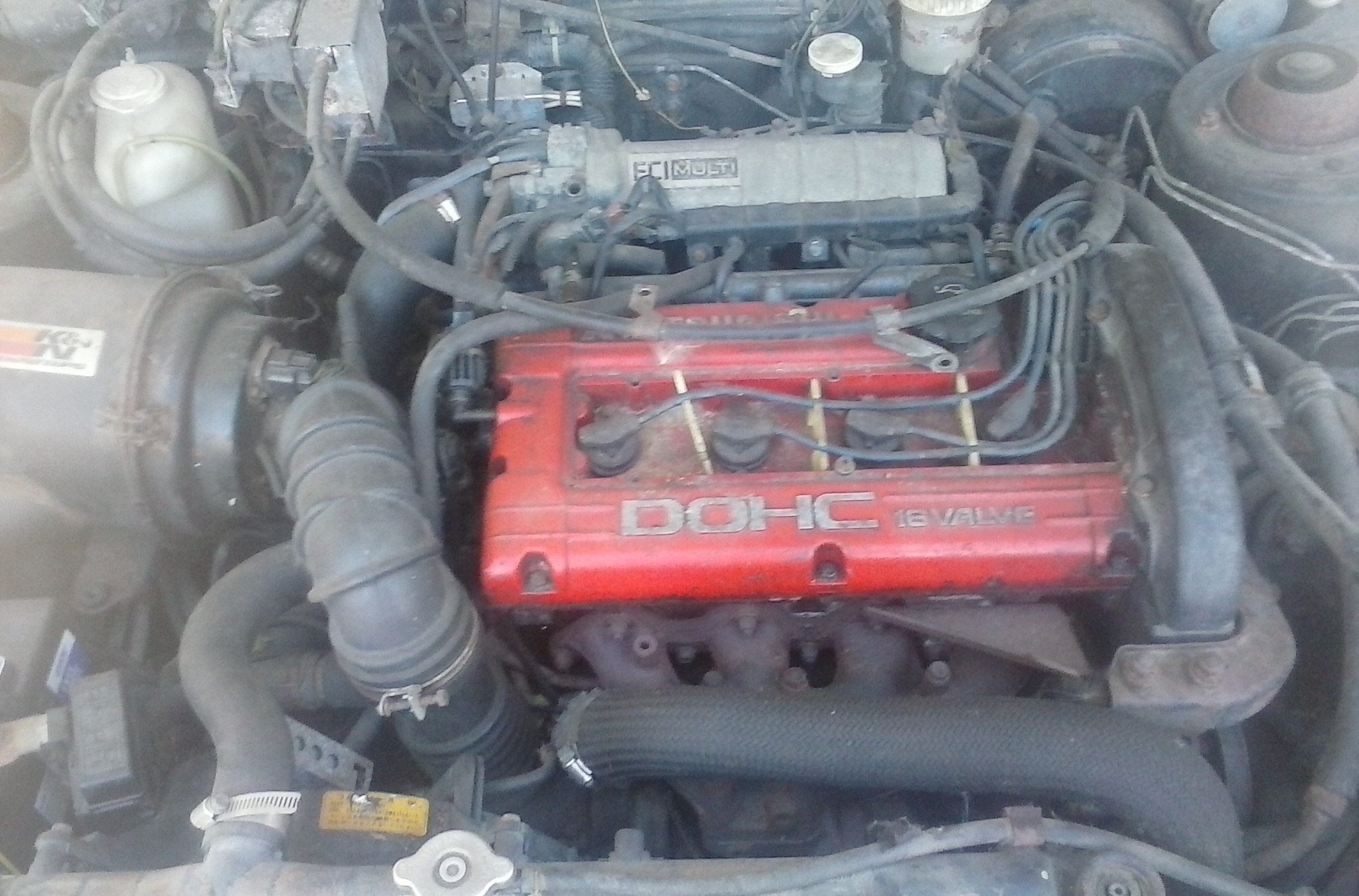

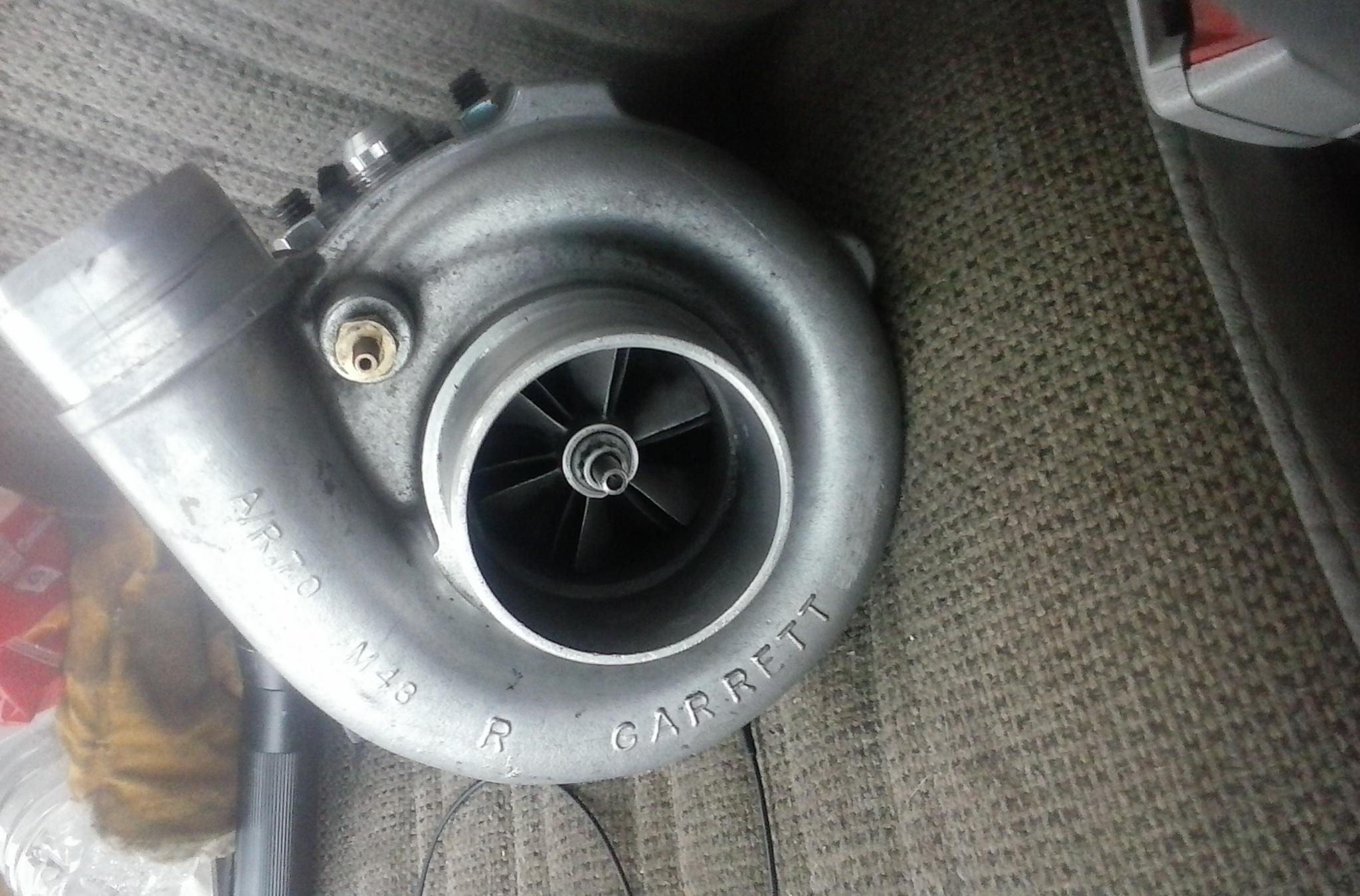

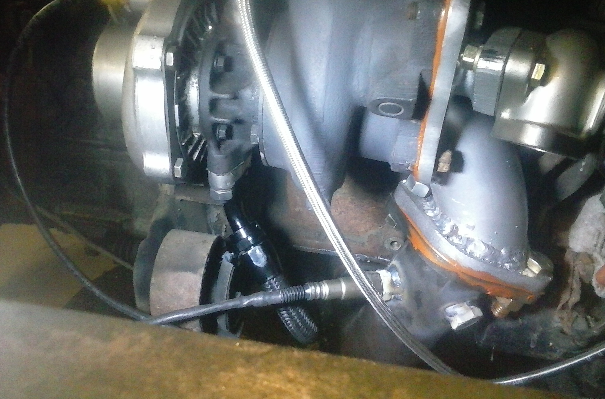

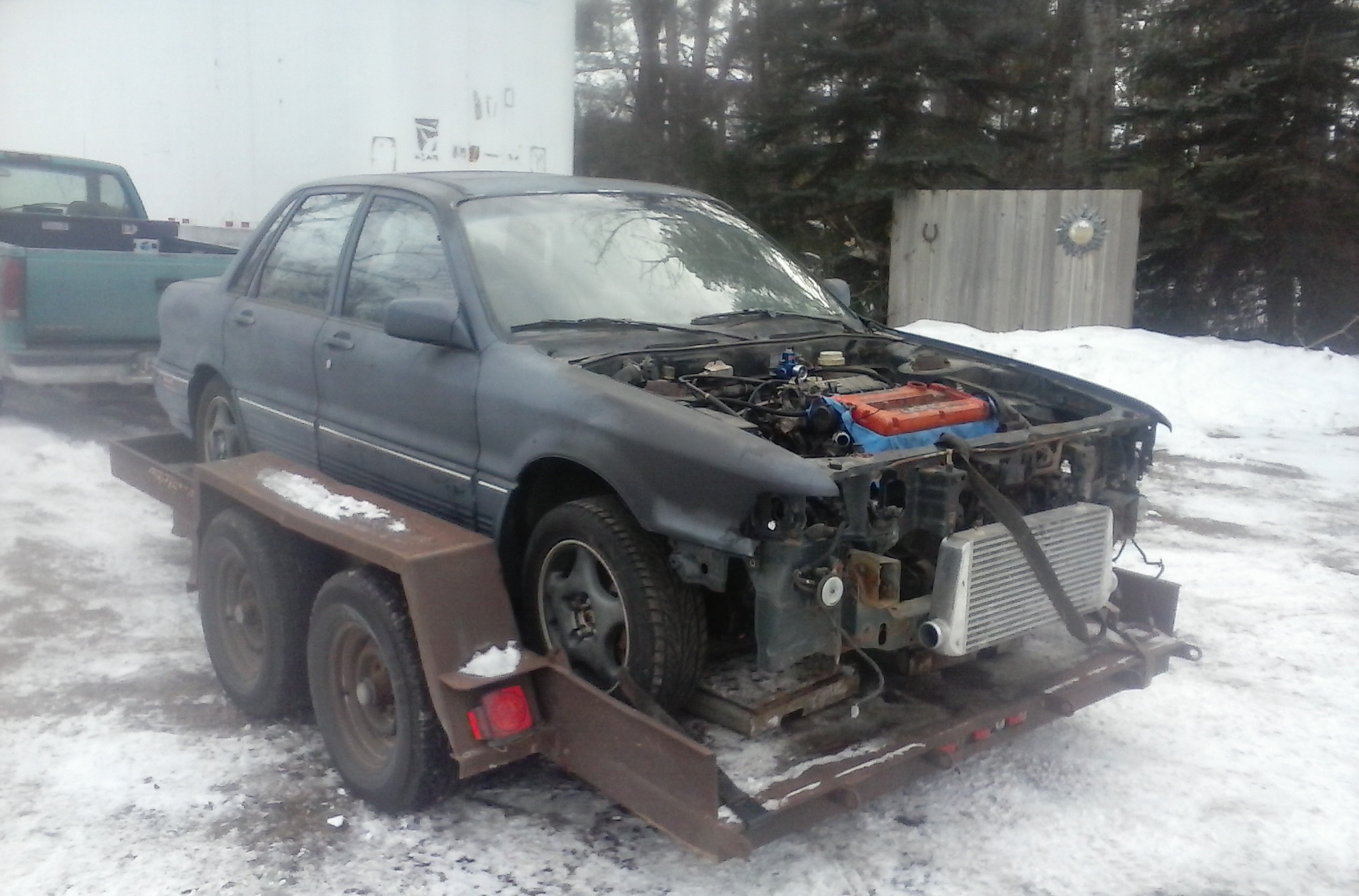

Ok so I bought this car about 3 months ago been driving it for about a month now. Figured I might as well share my pictures and such of the build and my problems I'm having. As of right now has
H11 head studs
Cometic head gasket
Totally stock 6 bolt
Unknown garret turbo with precision bolt on housing
Evo 9 maf
560cc injectors
10 gal cell with -8 braided line front to back
Aeromotive tsunami pump
Wideband
Boost gauge
Safc 2
4 bolt rear LSD with AWS deleted
Homemade o2 housing with emusa 38mm wastegate
So on to pictures in order of time

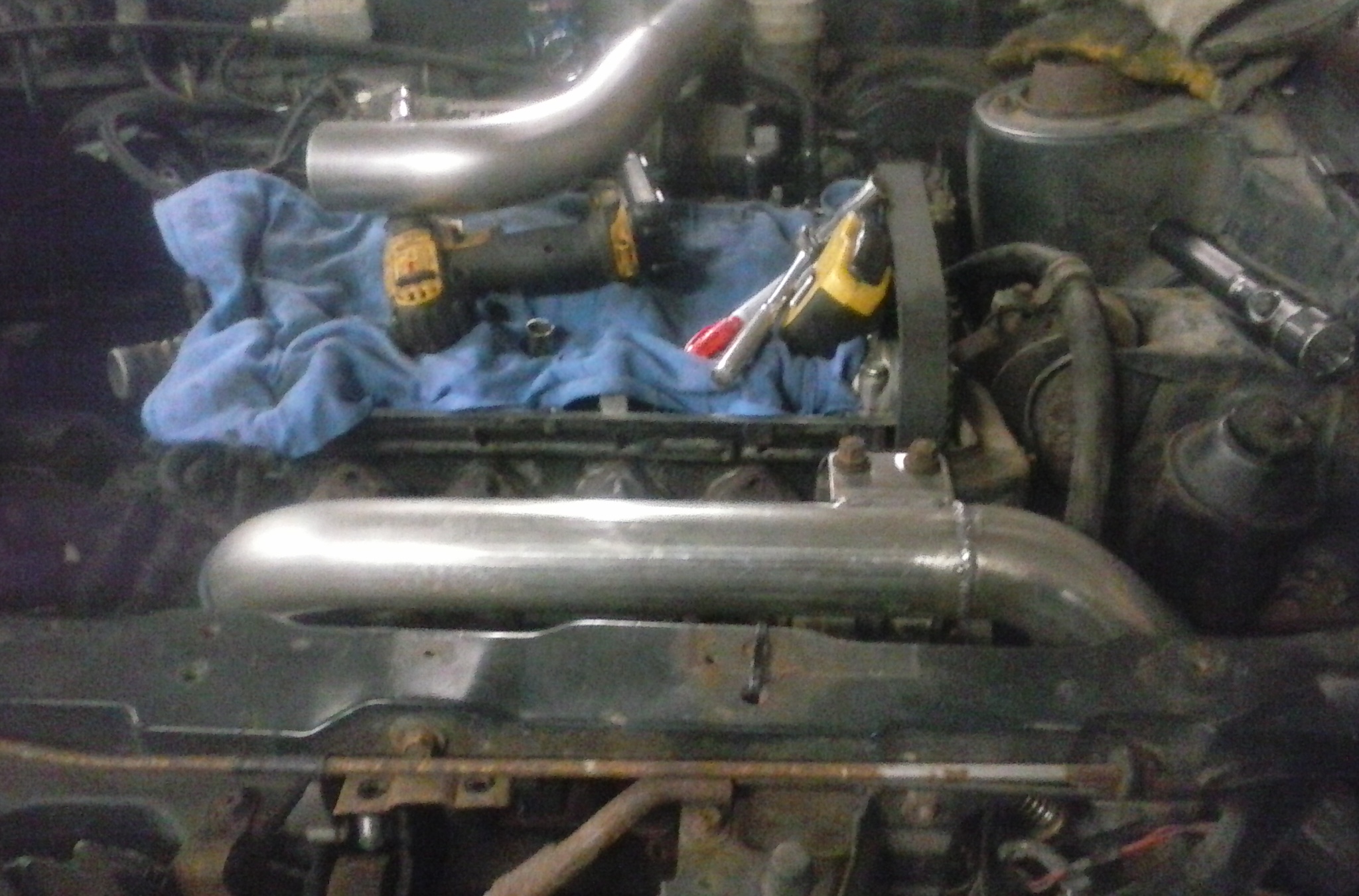

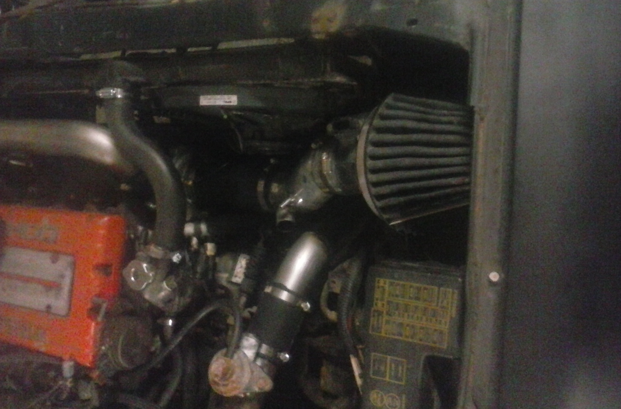

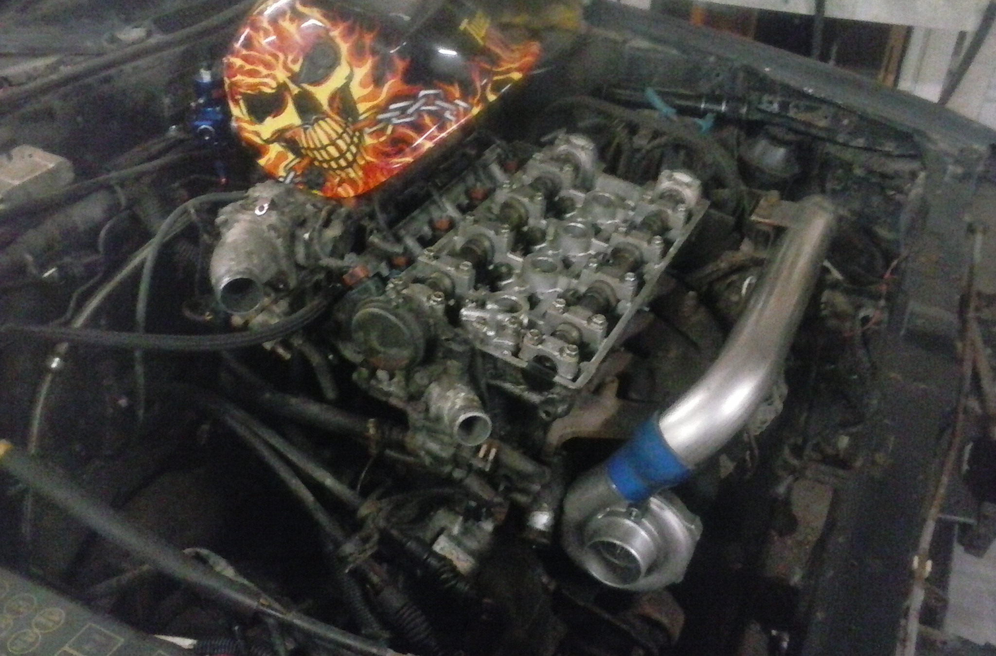

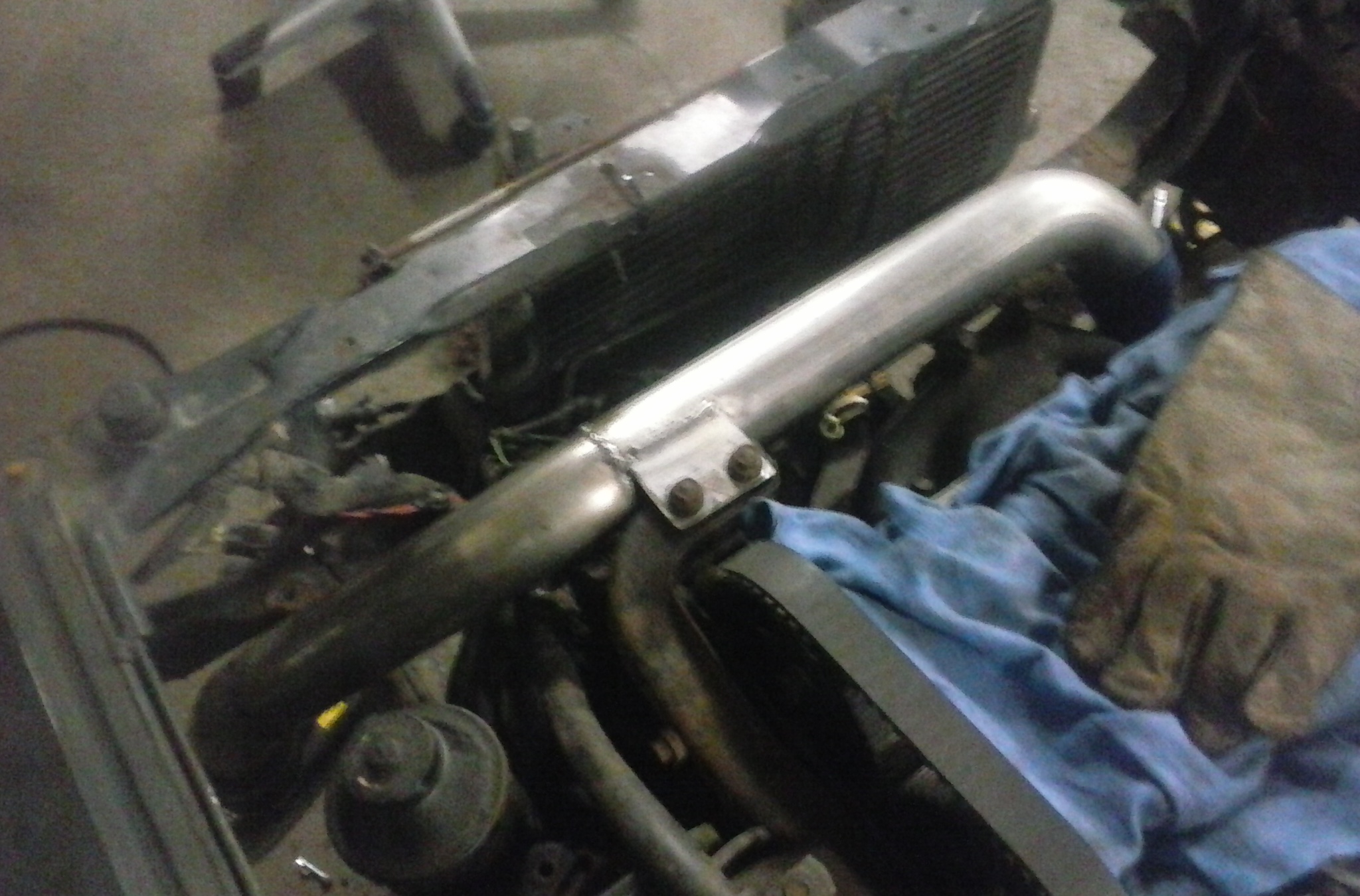

Turbo and intercooler piping build

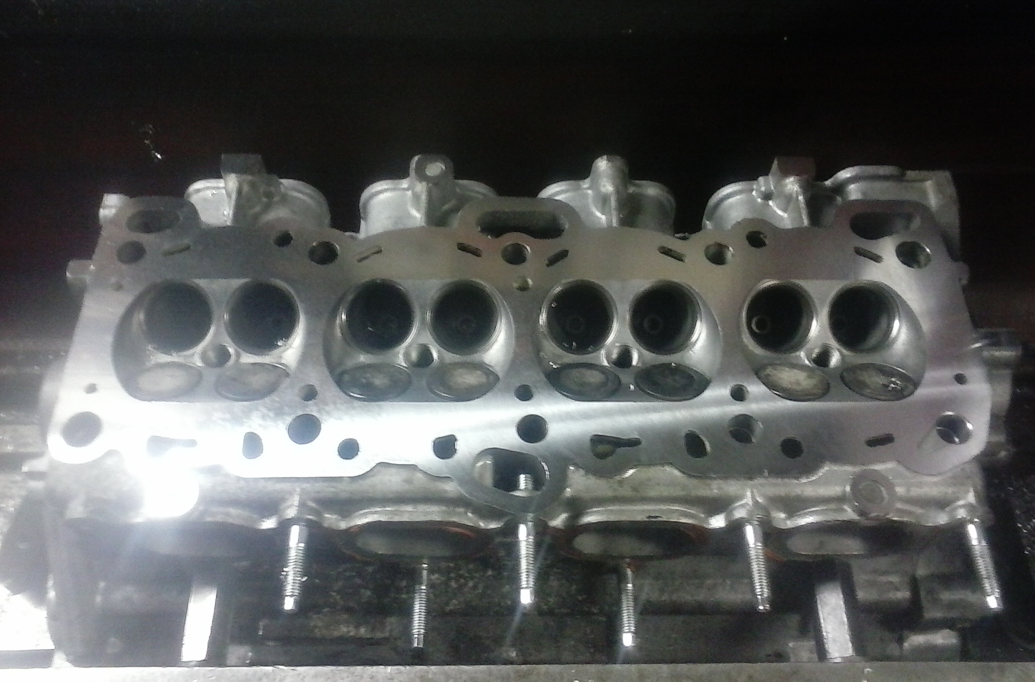

And when it leaned out because of a cheap fuel filter

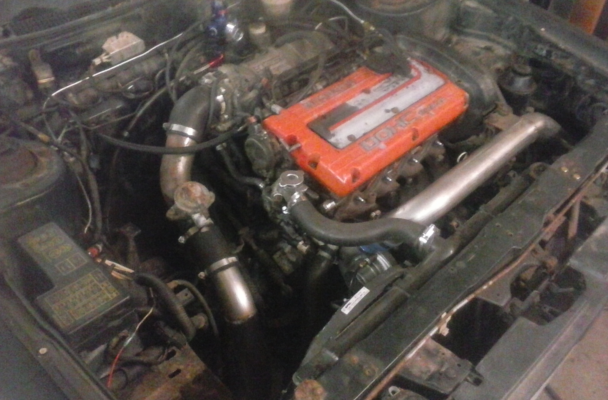

And lastly how it sits now
