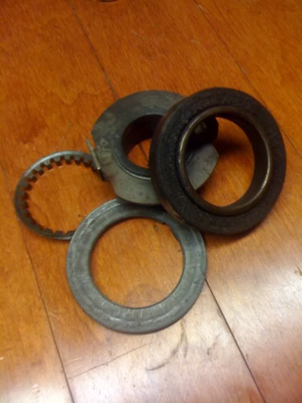

Comp Throwout bearing in pieces. Replaced it with oem

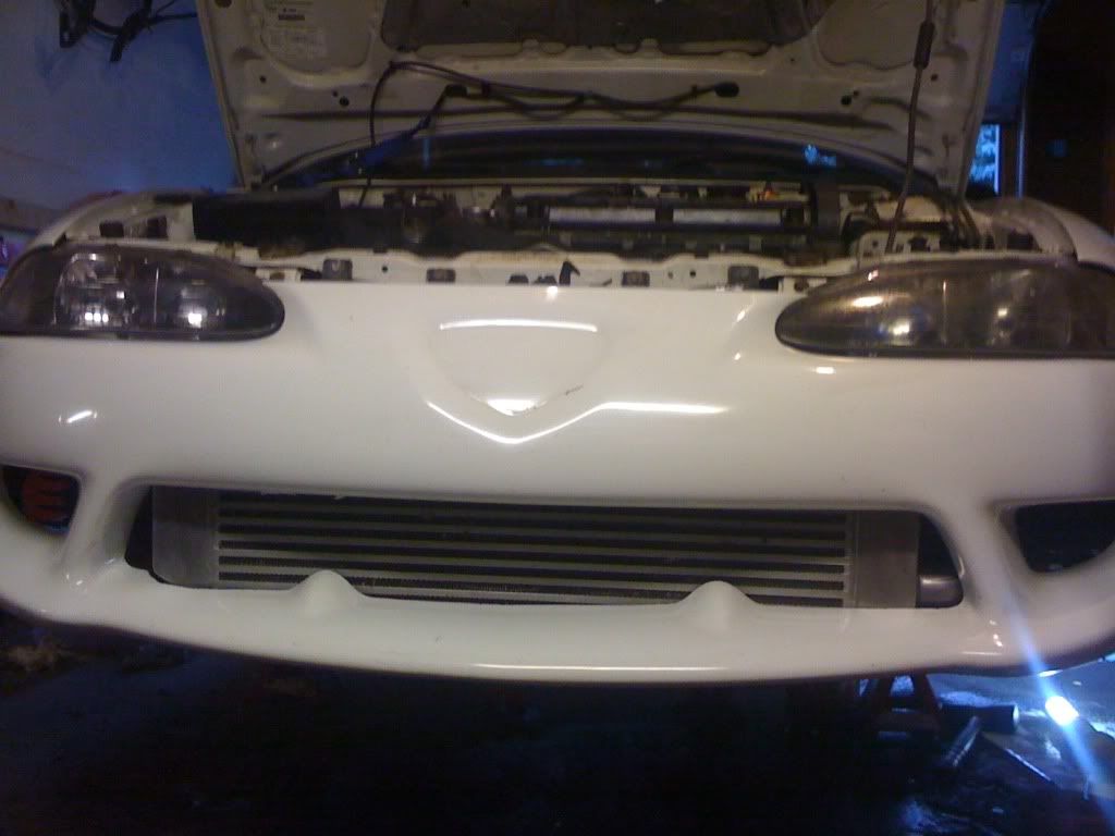

fp mani and new intercooler piping

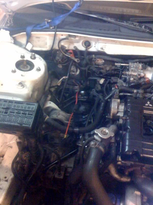

cruise delete to clean up engine bay
what the car currently looks like thanks scheides for the photo

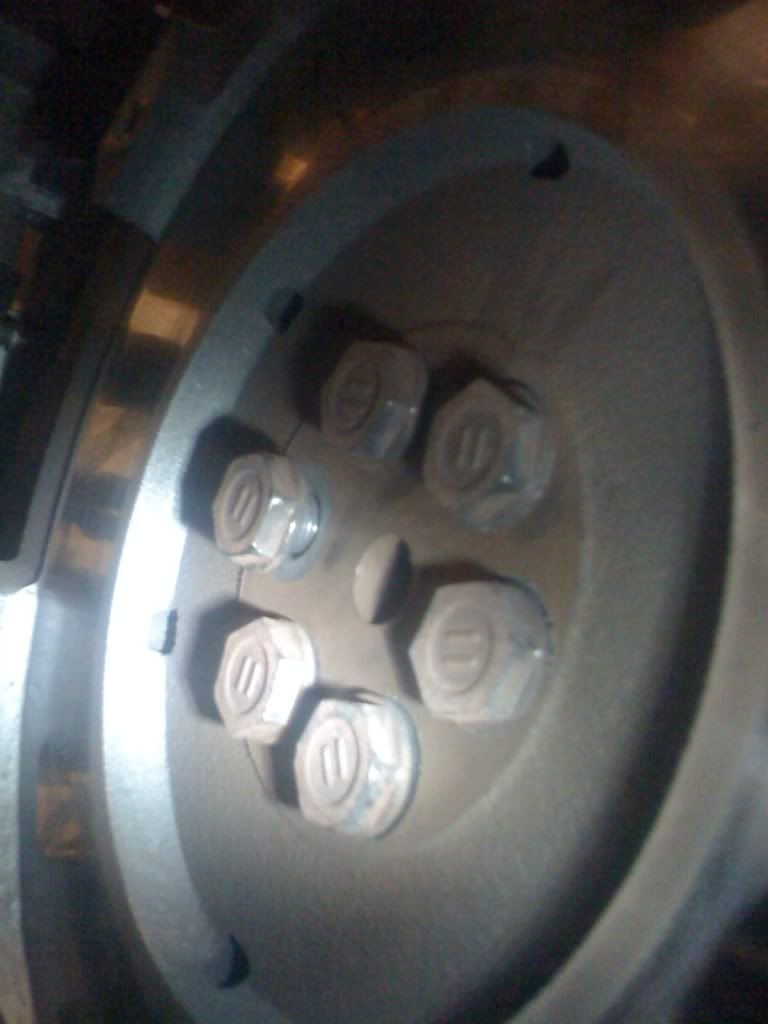

Thanks Jim and Aaron for coming up and reassuring me it wasn't a spun bearing! And sorry for the crazy knocking sounds that made you wanna puke. (I had the wrong file loaded on link). So I got the trans back out, and it looks like two flywheel bolts backed out. Prolly the cause of the crazy vibration on decel. So I ordered a act 6 puck and it will be here wed. just in time for the cookout.

98, I wouldn't have been so quick to think it was the 6 puck. My FW bolts backed out on a street disc... But it's your car, just make sure you locktite the fuck out of the bolts this time.
i'm replacing the disc cause it's worn and some of the springs are damaged. Also I'm putting in an act 6 puck, so I relize that's not why they backed out, more than likely I over revved the motor.

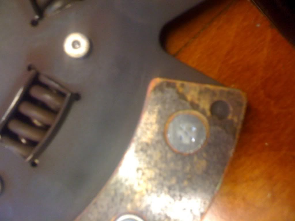

vrspeed FMIC
flywheel
less than 4000 miles
